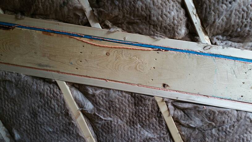

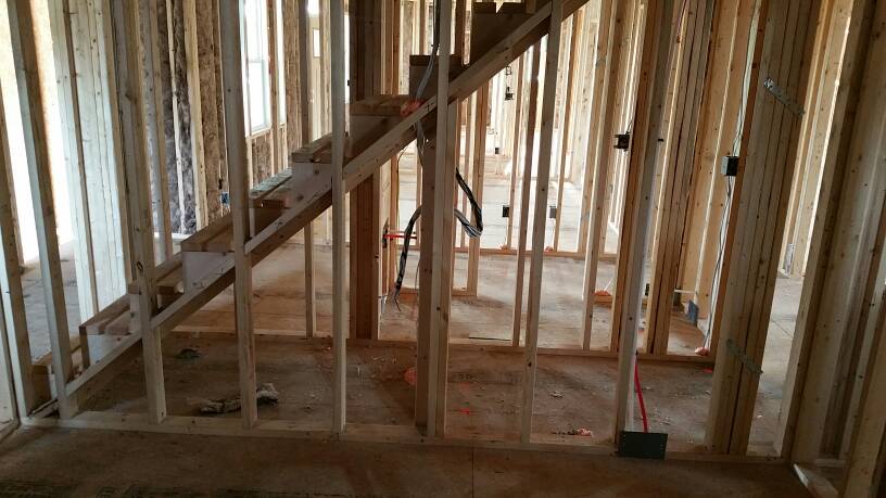

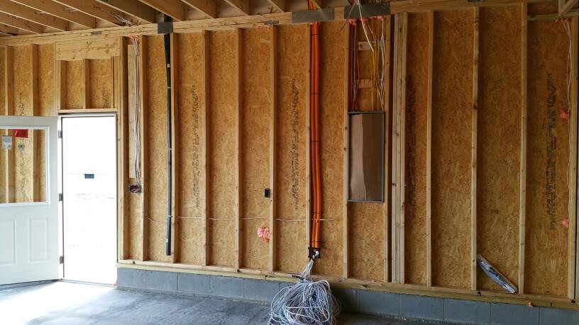

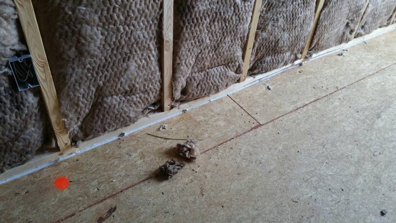

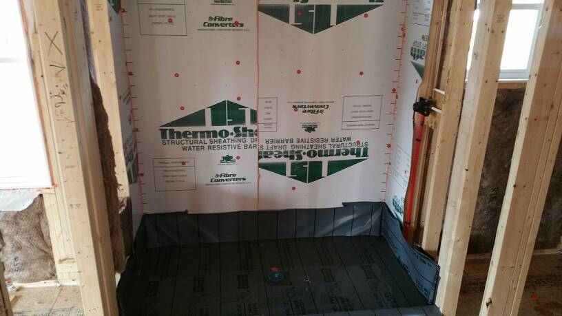

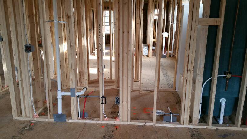

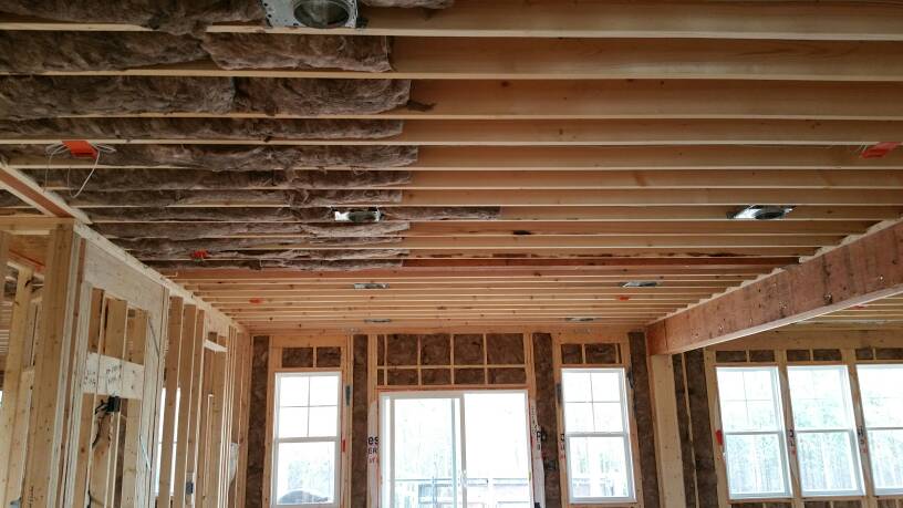

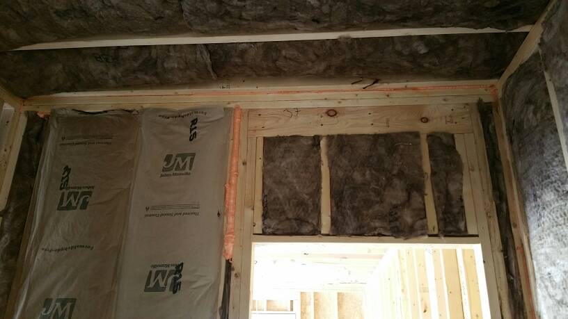

Air sealing must be a code requirement - builder had someone come in and spray foam most every opening. They also caulked along the sill plate of the exterior walls.

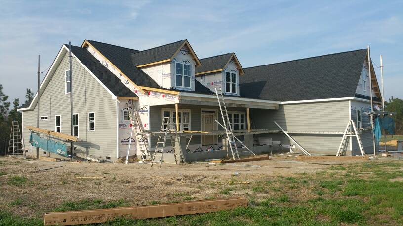

All them sticks starting to look like a real house now.

It is looking good Justin. When you hope to move in?

Justin, have no worries, they are doing a good job. There is always a better way but it isn't always economically feasible. I have over 30 years related to the building trade, on multiple fronts, what they are doing is accepted and fine.

The builder expects to be don't by the end of May. Hopefully we will move the first part of June.

Looking good.

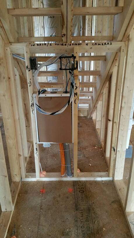

justin I see they paint the floor (orange dots) near water and electric. Is it not a code to use a metal protection plate at the bottom cord (within 1 1/4" of the stud surface of the wall) where wires or water penetrate to protect them from drywall screws or nails.
