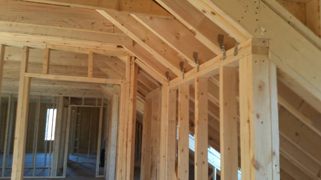

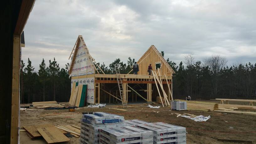

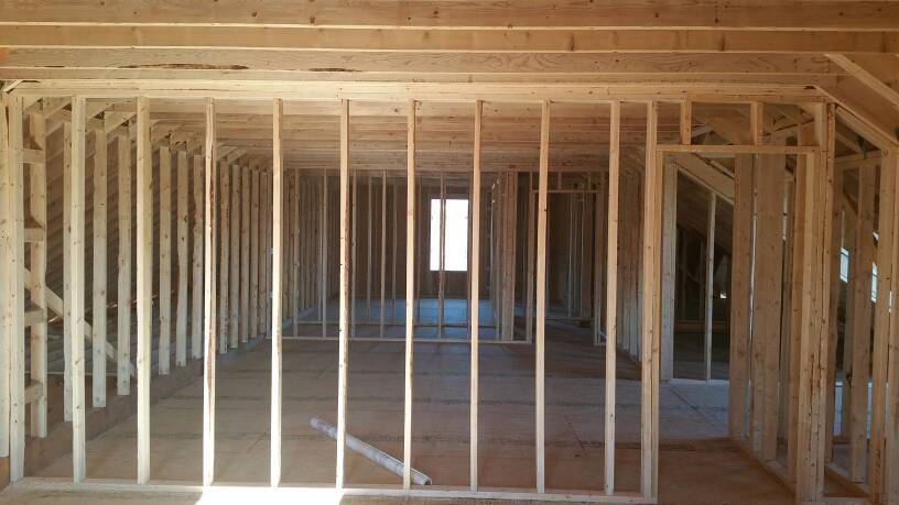

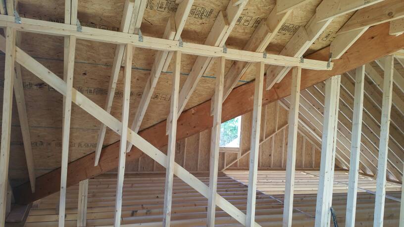

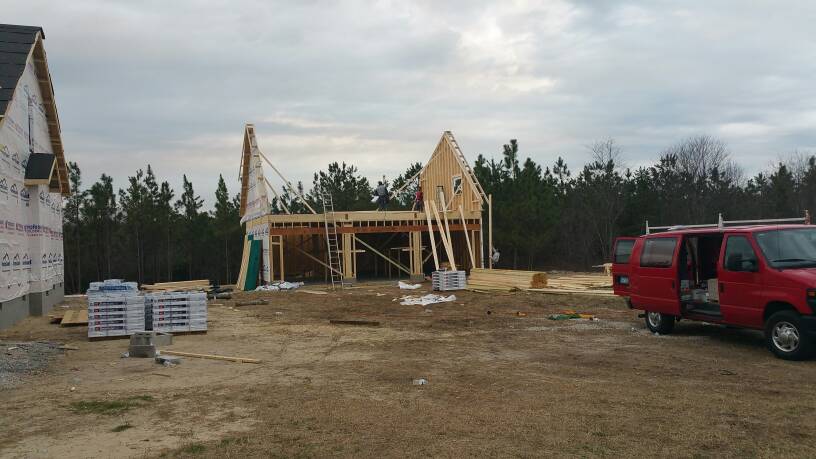

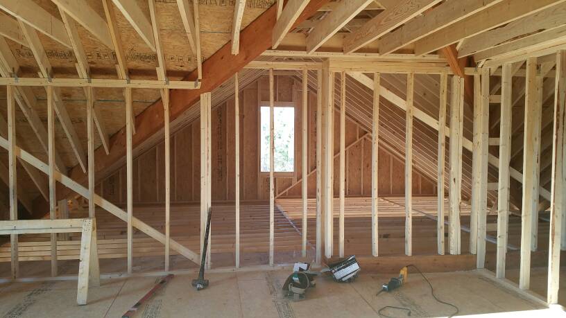

Framing on the main house is pretty much complete. They are wrapping up a few items and have moved onto the garage.
uploadfromtaptalk1456956079795.jpguploadfromtaptalk1456956087518.jpguploadfromtaptalk1456956105113.jpguploadfromtaptalk1456956114982.jpg
   / New House Build in the Country!!! #313
Justin make sure you blower door test before you sheetrock. This is something most people don't think about. It's not very expensive and will payoff for as long as you own your home. We tested three different times. 1st test was 3.2 Ach50, 2nd test 2.3, and 3rd test 1.9. It will be a lot easier to find and fix the leaks before the sheetrock goes up.

As many times as I see it, it still amazes me what a group of men can do with a pile of sticks.

What's even harder to believe is that they had no forklift or crane assistance. They built platforms out of wood and were able to set HUGE LVL beams that spanned over 34 feet. Each beam must have weighed 300+ pounds.

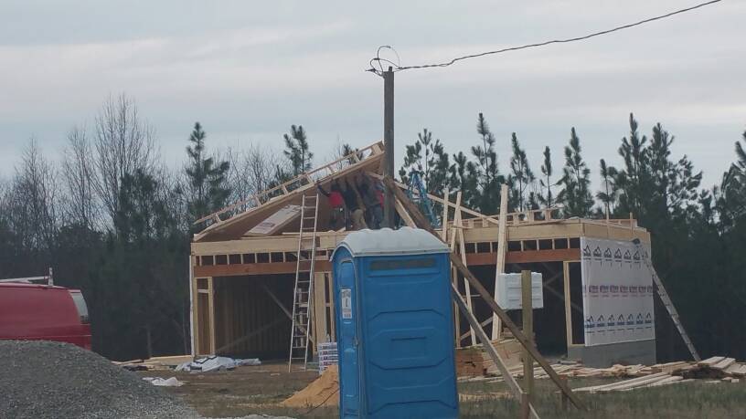

Electricians started working today. They spent a lot of time with us discussing options, which was nice. The framers continued work on the detached garage.

The framers used a full length header above the doors on the detached garage. Definately the way to go... Much stronger.
