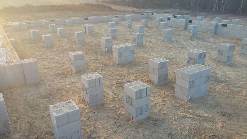

The did a nice job on your block work, looks like they even cleaned the interior joints. Vapor barrier on the ground for your crawl space and make sure they smooth out the dirt. If it was me I would consider doing the ducting in the crawl space and putting air handler there as opposed to the attic. In your area don't know what the pros and cons would be. They should be willing or making the interior grade level in your crawl space also. Make sure they give you nice wide access door. If the soil is sandy in your area may want to consider laying chicken wire out a ways before they back fill to keep the animals from digging down and under.

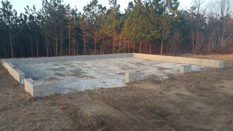

The masons finished up today. They should pour concrete in both garages friday.
   / New House Build in the Country!!! #128
Sure looks like a neat and clean job they did! Very impressive. I'm quite interested in how this goes as this is completely different than the construction I am used to up here.
   / New House Build in the Country!!! #129
I like that the ground under the crawl space is smoothed out with no humps and bumps. As the project progresses, don't allow scrap to be left in the space.
Someday, you or someone is going to have to crawl in there to do some maintenance.
At some point I would get some heavy plastic to cover the soil in the crawl space to prevent moisture and dampness to get into the area.
