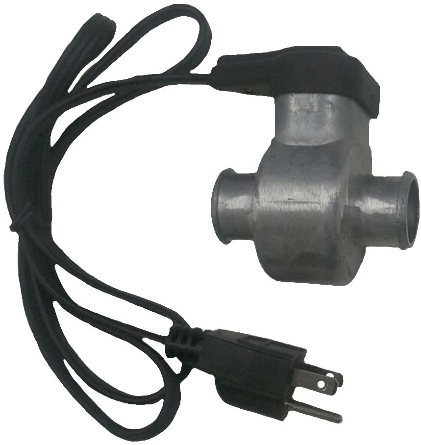

Hi all!
I have a new to me NH 2019 Workmaster 25s with a Yanmar 3TNV80F engine.
I want to put a block heater in and did not want to necessarily purchase
one from NH at $250.
My question is, my block has the two tapped holes around the back
freeze plug. Do all the block heaters for Yanmar engines that have this
arrangement take the same block heater??
Any help would be appreciated!!

Why don't you just put a heater hose in the lower radiator
hose or the upper one this is a lot quicker, easier and CHEAPER
TOO!
This may work better??? all on amazon
2Pcs Silicone Car Engine Heater Pad - 4" x 5" Self-Adhesive Oil Pan Heater Pad Battery Heater Pad Engine Block Heater Pad with Thermal Protector 68" Long Power Cord 150W 120V​
Brand: PAMASE
willy
Phillips & Temro Lower Radiator Hose Heater - 600W 120V- 1.5 inch​

Put in a block heater. Google the Phillips Temro website and look in their catalog. Then look around the web. $250 for a block heater is ludicrous!
