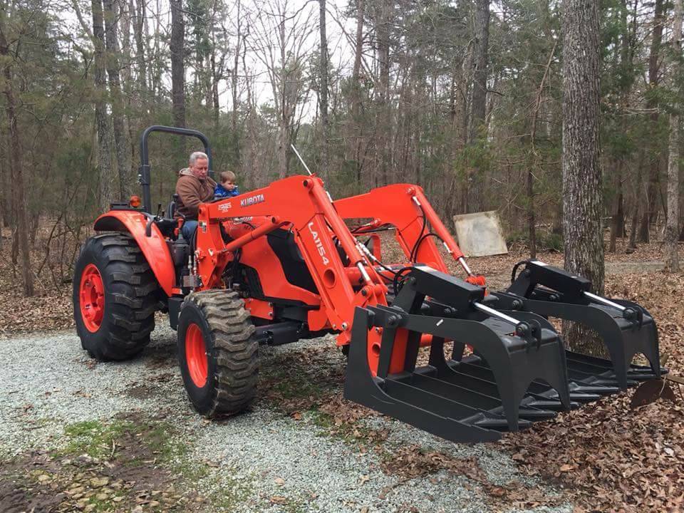

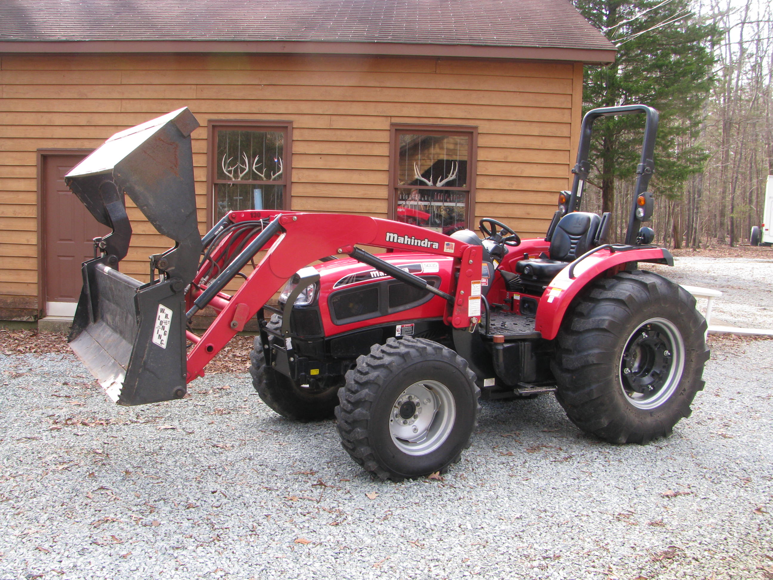

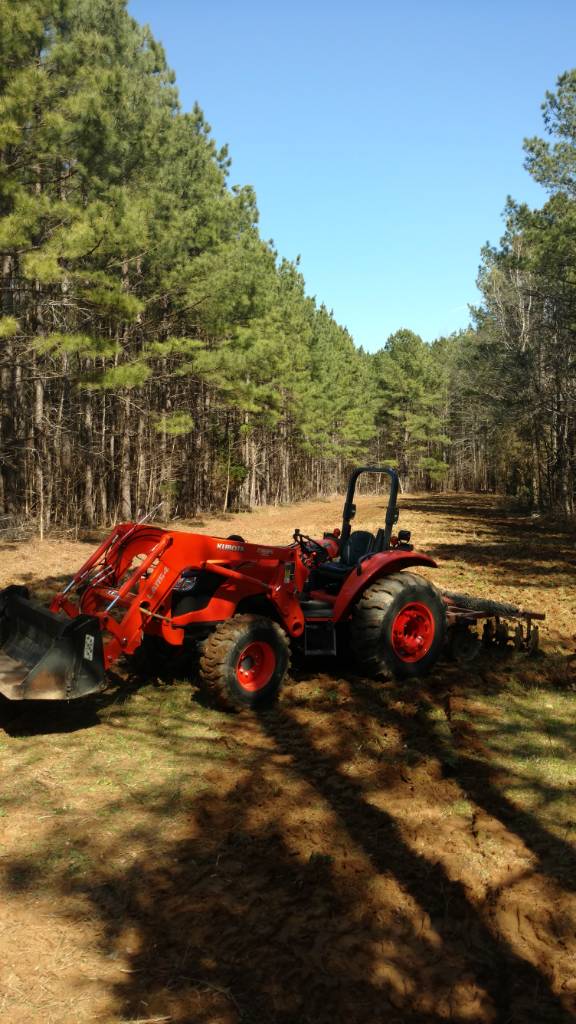

I second airbiscuit. I've owned Fords, Mahindra and now Kubota. The older Ford tractors were tank tough. The Mahindra appeared to be tough but I had many repairs of cheaply made parts breaking down leaving me in the field multiple times. I think Mahindra would be better suited to lighter jobs, not heavy ag type work. That'll really make you mad. The Kubota hands down is tops on quality. Not enough hours on the M7060HD12 to prove its toughness factor yet. IMG_20180317_150139235.jpegFB_IMG_1518900499888.jpegIMG_2555.JPG
