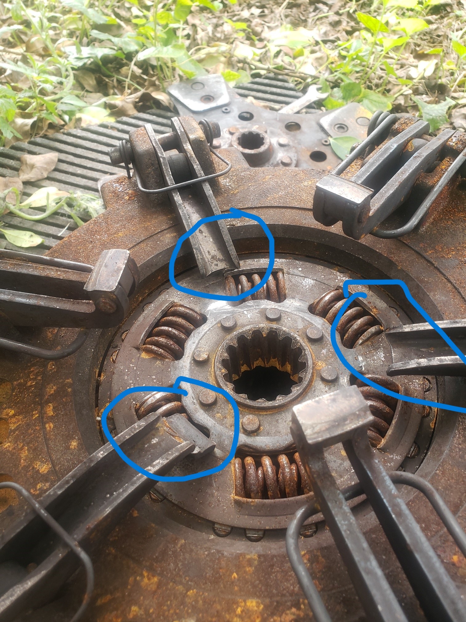

Looking for ideas on what would cause the main clutch arms to break the fingers off the pressure plate after 1 year of install. Also how or why would there be water in the back and bottom of the bell housing area of the transmission? Trying to figure out what is wrong or needs corrected before replacing the whole clutch assambly.

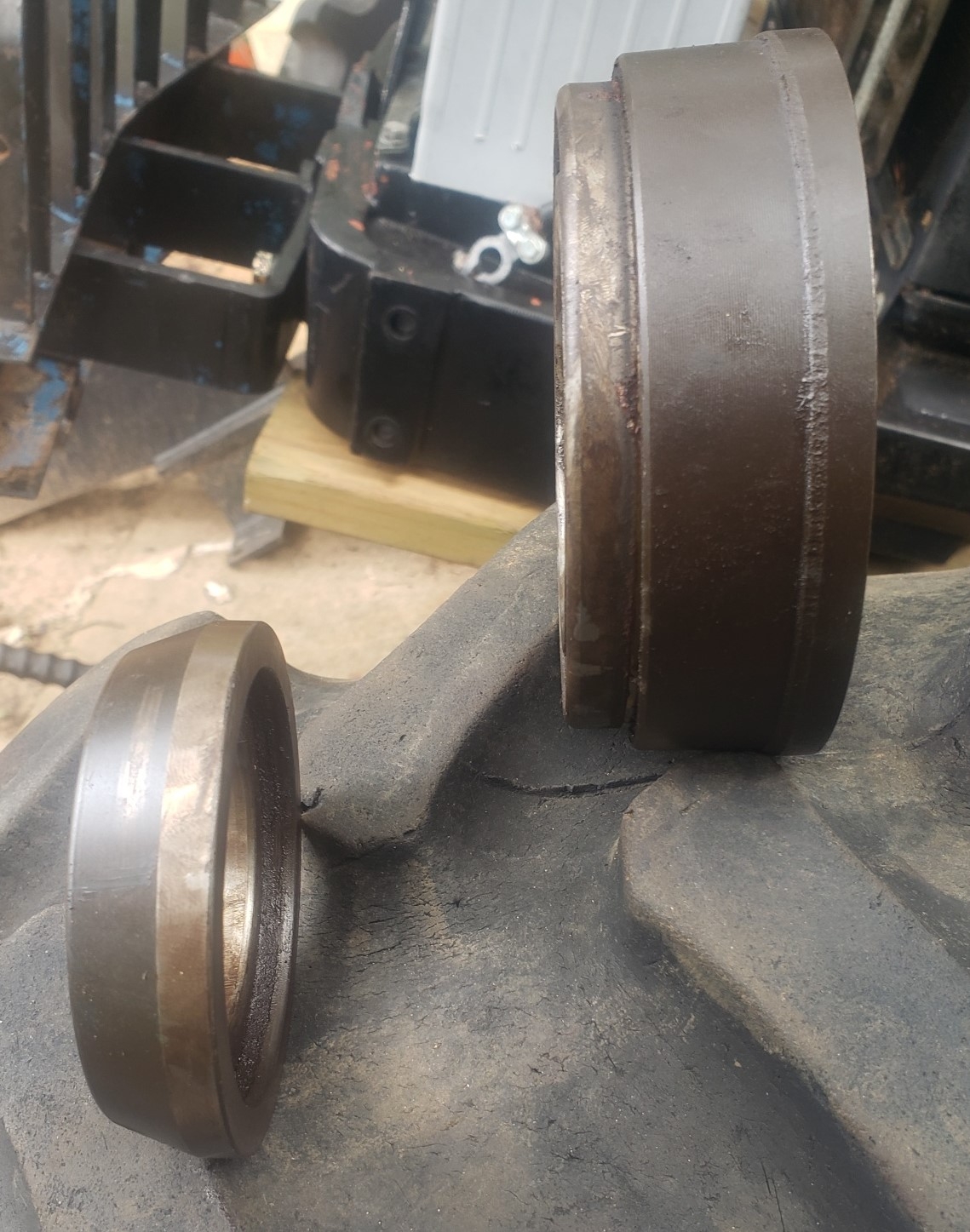

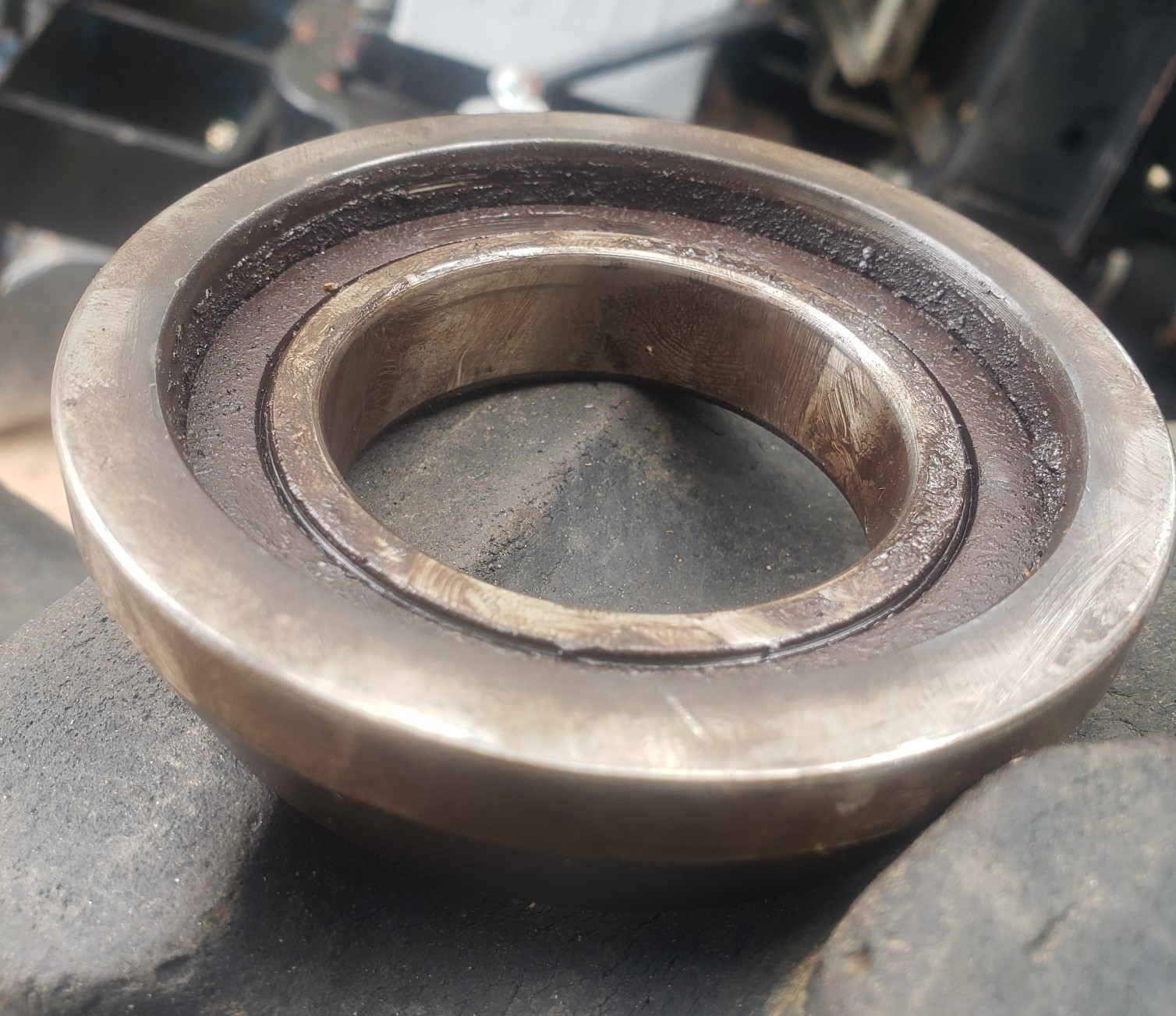

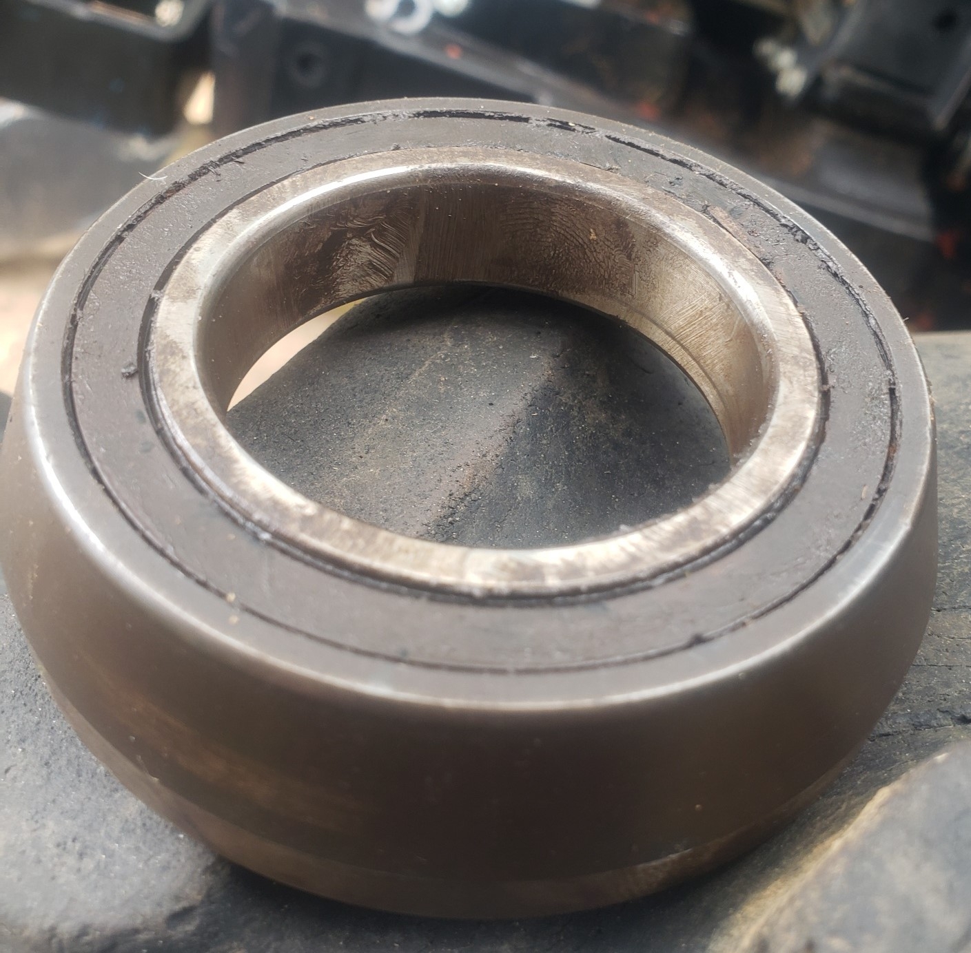

So follow-up, think the bearing that rides againts the pressure plate fingers was installed wrong. The groove side was installed towards the transmission instead of the pressure plate. Being told that the groove side should be towards the pressure plate. Is that correct?

2. "new replacement bearing could be installed backwards" After looking at the part again it was not the bearing but the housing that the bearing is installed. It is the smaller of the two bearing holders.
3. "Where does your information come from regarding this fact?" Someone who stopped by and was able to look at the parts. Then I was told by someone else what was said. So I might have been told wrong or misunderstood. That is why I am asking here.
So here are 5 pics. Have high res versions available if needed.
1. Is the bearing_installed_order pic correct or is one or both backwards?
2. The back_side_pressure_plate showing the broken ears on the pressure plate.

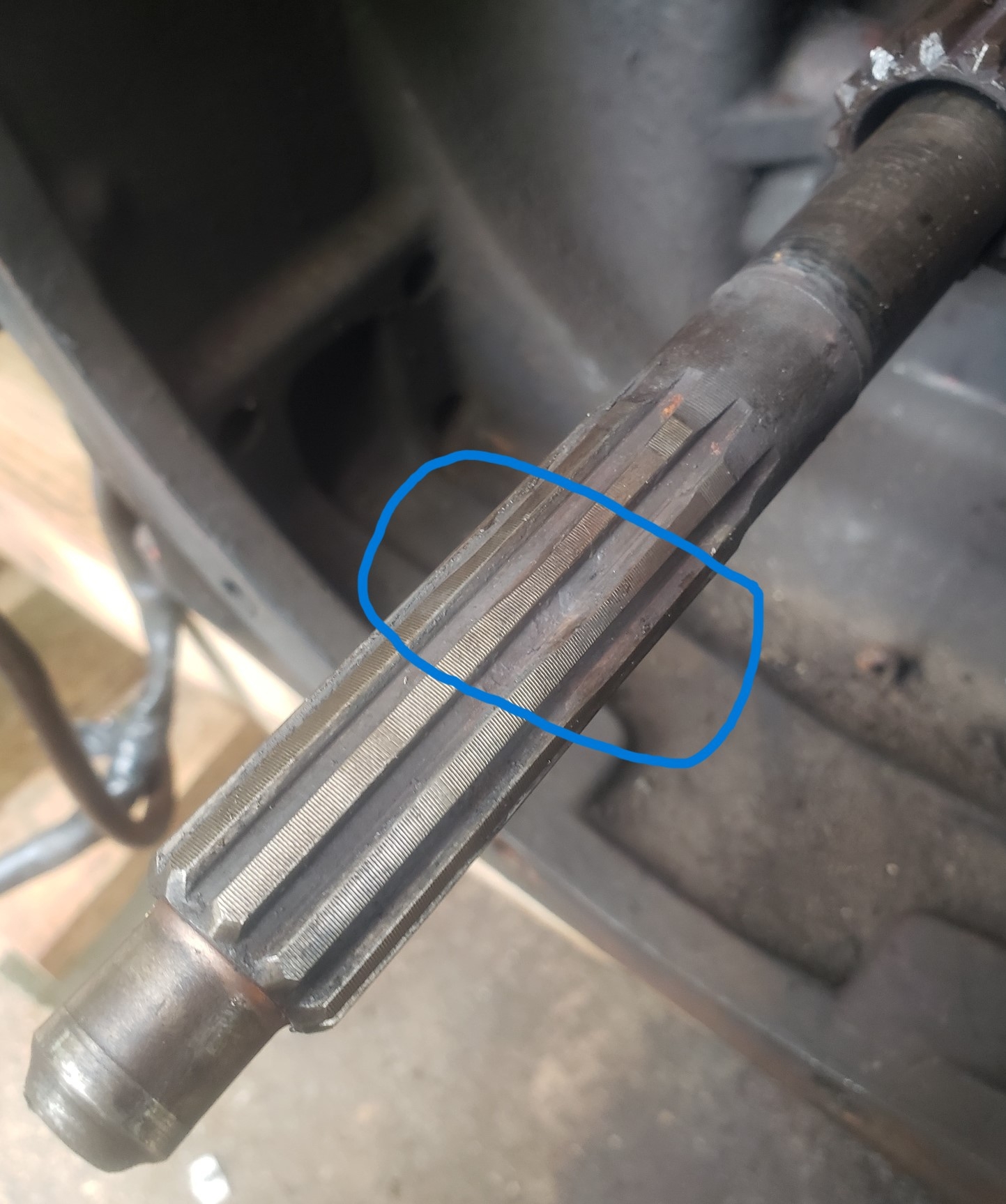

3. Does the wear spots on the shaft in Needs_replaced_or_still_ok_to_use picture show enough wear to cause issues and needs the shaft replaced?
