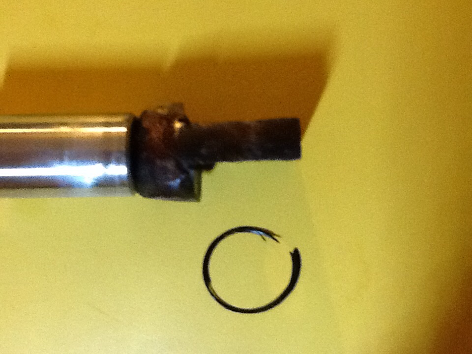

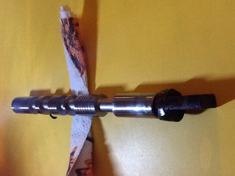

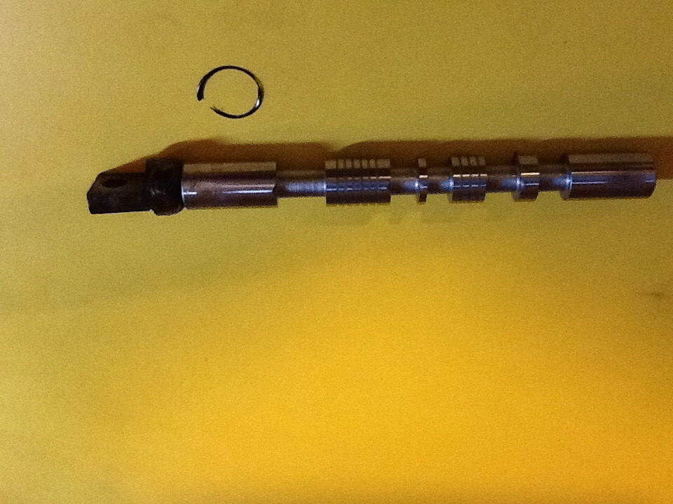

Well the curl still wouldn't reach out even with the hoses swapped, so I pulled the joystick to see why the curl valve was binding anyway. Here is what I found. I sure hope the rest of those O-ring pieces didn't end up downstream. I need to rebuild this manifold don't I? There were several smaller pieces that came out too, but this was the biggest piece. It looks like someone made a homemade Joystick curl valve attachment. That must be why it was so loose because when you tightened it, it would bind up. It looks like it ate up the O-rings in the valve body over time. The valve wouldn't seat all the way, so I assume there is something in behind it that isn't allowing the valve to actuate fully. What type of manifold could I replace this one with if I can't find the right pieces to fix this one? Any ideas? To see if it is open center I just blow air in the inlet and see if it comes out the outlet? Thanks for the help.

Well the curl still wouldn't reach out even with the hoses swapped, so I pulled the joystick to see why the curl valve was binding anyway. Here is what I found. I sure hope the rest of those O-ring pieces didn't end up downstream. I need to rebuild this manifold don't I? There were several smaller pieces that came out too, but this was the biggest piece. It looks like someone made a homemade Joystick curl valve attachment. That must be why it was so loose because when you tightened it, it would bind up. It looks like it ate up the O-rings in the valve body over time. The valve wouldn't seat all the way, so I assume there is something in behind it that isn't allowing the valve to actuate fully. What type of manifold could I replace this one with if I can't find the right pieces to fix this one? Any ideas? To see if it is open center I just blow air in the inlet and see if it comes out the outlet? Thanks for the help. <img src="http://www.tractorbynet.com/forums/files/hydraulics/421875-new-holland-t1510-front-bucket-image-jpg"/><img src="http://www.tractorbynet.com/forums/files/hydraulics/421876-new-holland-t1510-front-bucket-image-jpg"/><img src="http://www.tractorbynet.com/forums/files/hydraulics/421877-new-holland-t1510-front-bucket-image-jpg"/>
You did swap both lift hoses to the curl circuit.
that is why I asked if the spool moved the same in and out of the valve.
They do not make replacement spools, as they are a precision fit.
The o-rings for the spool are there to seal out dirt and water, not pressure.
However they can cause the spool to jam and not function correctly.

Yes I did as Leejohn described and the curl still wouldn't push out. It should have pushed in and out since it basically was being supplied off of the FEL valve at that time (up/down). Correct? I couldn't get the curl valve to actuate IN however (before I swapped hoses) and felt it was binding so I took the valve out carefully and O-ring material came out. I have put cams in engines so I know to be careful of scoring on the surfaces. I think something is in behind this curl valve stopping me from pushing it in all the way. I ran out of daylight, but I will try again tomorrow. Is it possible to replace those O-rings inside that valve body fairly easily? I could then clean out the valve body of debris if there is anything in there. Thanks guys, with your help I am starting to catch on a bit here. I appreciate it.

Two more ?. What end of the valve body did you pull the spool out? #2 is there threads in the end of that spool?

I pulled it out of the A/B port side. I pulled it out from behind the Joystick housing. Yes there are threads there behind the welded attachment. It looks like some one has made a connector for the Joystick actuator and threaded it into the spool. It looks to be rusted in there now, but with some finesse and WD-40 I can probably get it out. This is the valve that wasn't actuating IN like it should have. It won't seat fully...like there is something in behind it. The C/D port side valve (FEL up/down) works correctly and has good spring tension on it as well as seating correctly.

I was talking about the other end. Did you pull the cup off and unscrew the centering spring from the spool? If you didn't pull the cup and that might be your trouble right there.

I just removed the valve from the valve body from behind the joystick. It pulled right out. I see what you mean now. So that spring threads in there on the OPPOSITE end of the spool. Maybe it was never threaded in the right way then. I will look at that in the morning. That would be nice were it that simple.
Yeah, it seemed like the valve was binding like something was stuck behind it. The valve was about a 1/2 inch too far out on the Joystick side. Thanks for the information.
