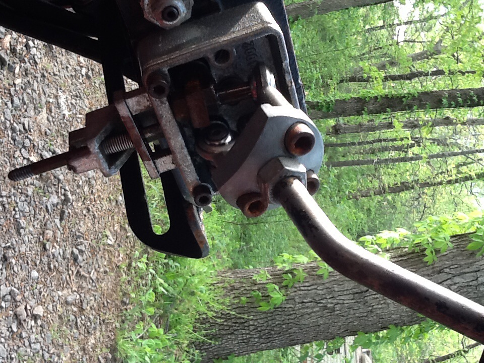

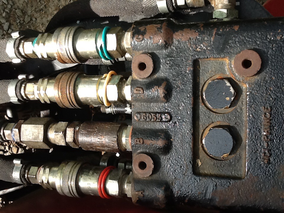

Here are pictures of the Joystick and valve body manifold. It says HCI-PRINCE on it and has a number 6053 as you can see. Can you tell me anything about it? Port A goes to bottom of curl cylinder. Port B goes to top of curl cylinder closest to bucket. Port D goes to top of FEL cylinder (branched to both sides of course) Port C goes to bottom of FEL cylinder (branched) closest to bucket. I am trying to be descriptive of the hookup. Tell me if that is too much. Thanks.

Could I temporarily move the hose from port A to Port C to see if the curl would reach out? I could then tell if the issue was valve/manifold related? That is if the curl cylinder moves out. I will wait to see what you think before I do that. It could still be that the QD on Port A is not engaging fully inside. It seems to turn too freely, like there is no pressure on it. That is still a possibility I am sure.
   / New Holland T1510 front bucket won't lower! #9
Yes, you can switch hoses to verify flow.
If tractor is an open center hyd system ,the 3pt valve is the last valve in the flow path.
Your tractor speed is relative to pump speed, so if you are pumping 10 GPM's, and with all valves in neutral, each valve will see the same 10 GPM.
The loader valve is probably first in line and therefore has priority, and can use all 10 GPM flow, with none left for any other valve.
However, if the loader valve is only using half of the 10 GPM's flow, the other valves will see 5 GPM.
When you shift a hyd spool, the pump is pumping fluid and it has to go somewhere, and moving the spool make a passage for the fluid to flow to the work ports. You can't stop the flow, but the relief can re-route the flow so the pump is protected.
A hyd gauge would have solved your problem.
If you plug your gauge in each of the work ports, you can verify pressure. .
