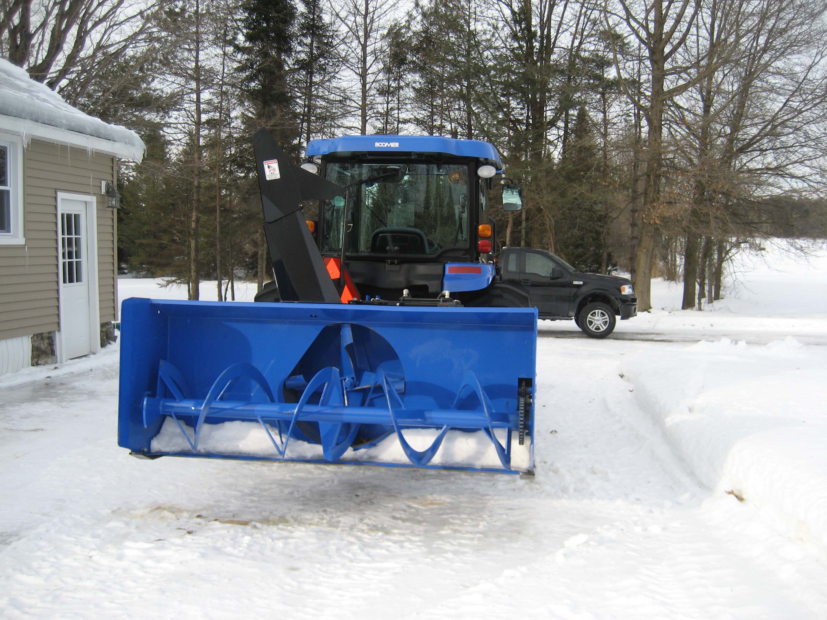

well I can't speak as far as asphalt, but on my 1400 foot gravel driveway it rarely digs in I have the 84 inch model it's built like a tank no problem last winter tractor never slowed down my model is the 2420, my dealer tested my PTO output it was around 57 which goes to show you new Holland under rates there PTOs the tractor is supposed to only have 60 hp yet my PTO was putting out a little over 57 at 2500 RPM go figure :). I would've bought the smaller model to save a little money but would not cover my rear tracks, due to the fact that I moved the tires out so far for stability. On my previous tractor a TC 40 DA I had the front mount snowblower 74 built pretty darn tough but nowhere near the 84 augurs or fans structural integrity. I don't believe it's Woods I was looking at other manufactures it looks more like a company out of Canada I just can't remember the name, either way you can't go wrong to tell you the truth I can't think of anyone with an asphalt driveway that doesn't complain about snowplowing or blowing they all seem to do some sort of damage nature of the beast ;-).

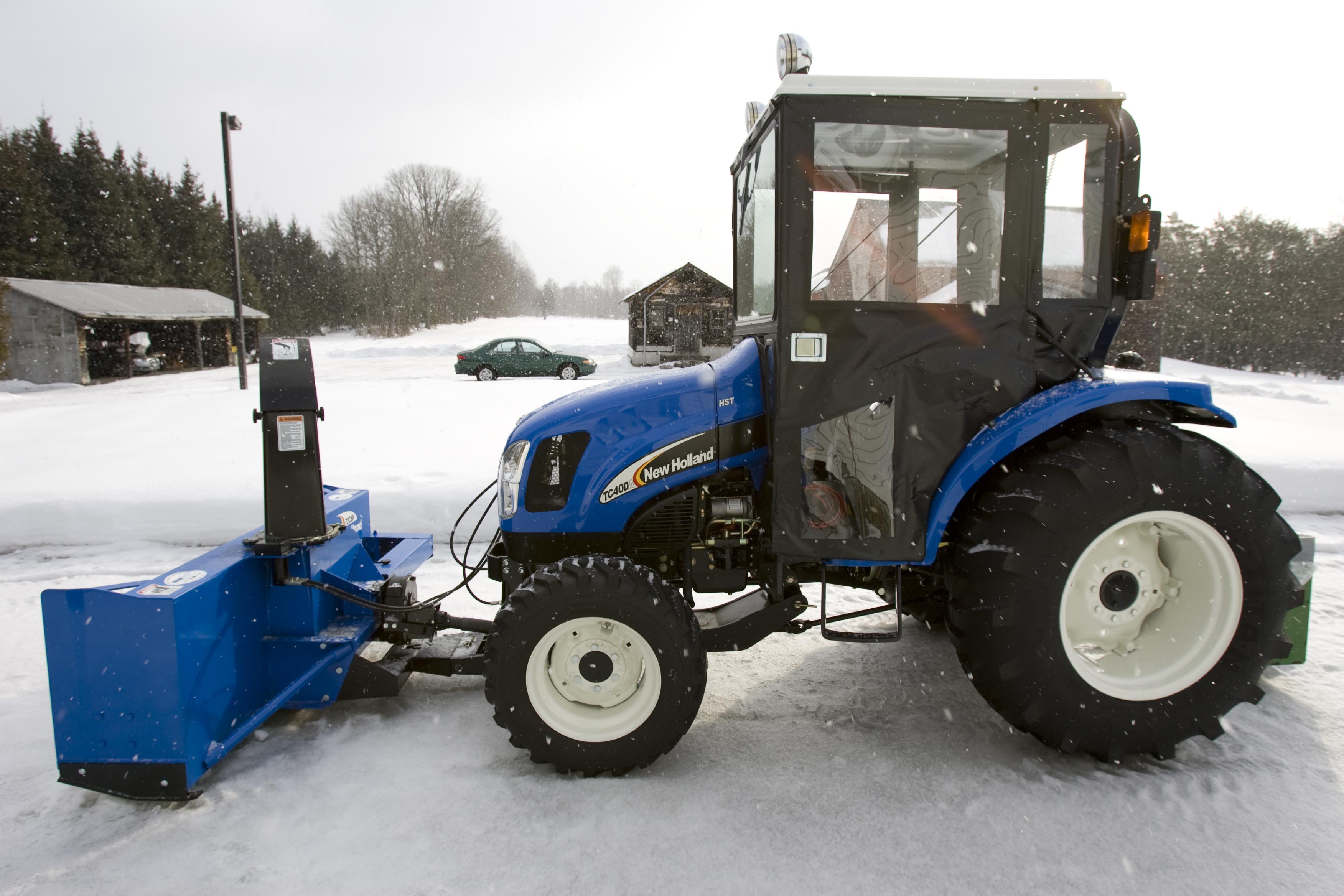

point well taken, I wouldn't care how big the LCD was I would want to back up either ;-). As far as prices go my tractor was equipped with the mid-PTO from the factory, snowblower subframe installation was close to $8500. If you check on this form I helped a guy back in September of 08 with his 45 I think it was close to 10,000+. They definitely will scrape low, my neighbor's driveway has slight scruff marks from the shoes, neighbor says no worse than the plow Company had done in the past. other advantages of the front snowblower it definitely throws snow further than my rear one, it also frees up your three point hitch for a back blade with a rubber edge to scrape down to the road. Now do yourself a favor I have a neighbor who had the rear pull type, he kept it for one season continuously packing up with wet heavy snow and breaking shear bolts, you will laugh if I can find the picture of the pile of snow pack in the blower or the time my blue tractor had to pull his green tractor out of a snow bank he drove into at -25 below, he walked to my place for help thank God he was all right just a little cold :). well anyway you can't go wrong with that front snowblower I had mine for two seasons never a problem 48 inch snowstorm no sweat, to tell you the truth I would love a front mount snowblower on this new tractor it's just too expensive I was quoted close to $14,000 ouch. some photos the first picture February's 06 48 inch storm there is a car under that pile you can just about see my tire tracks a little close but better than digging by hand the second picture just a typical morning what they call around here a little storm.

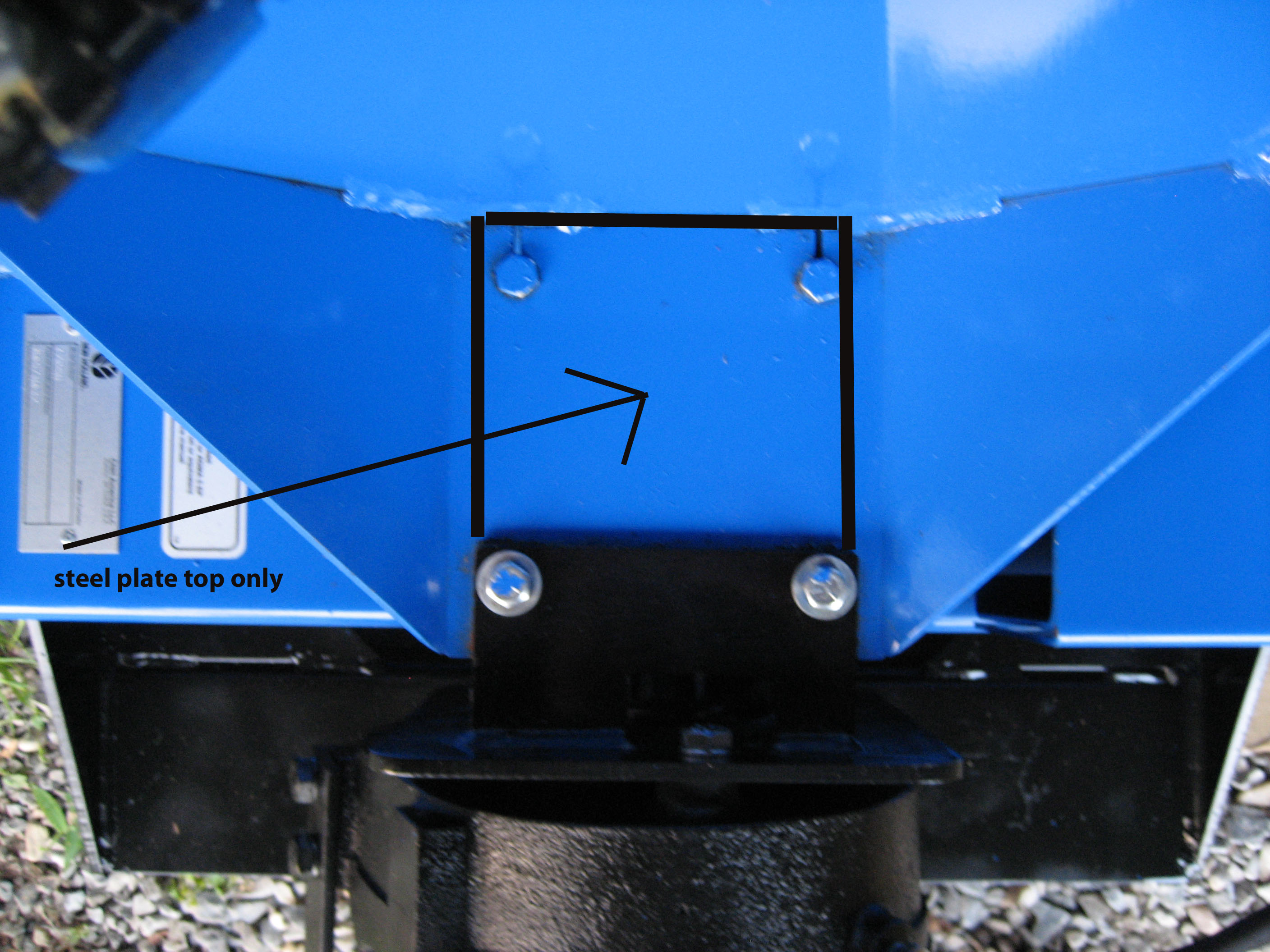

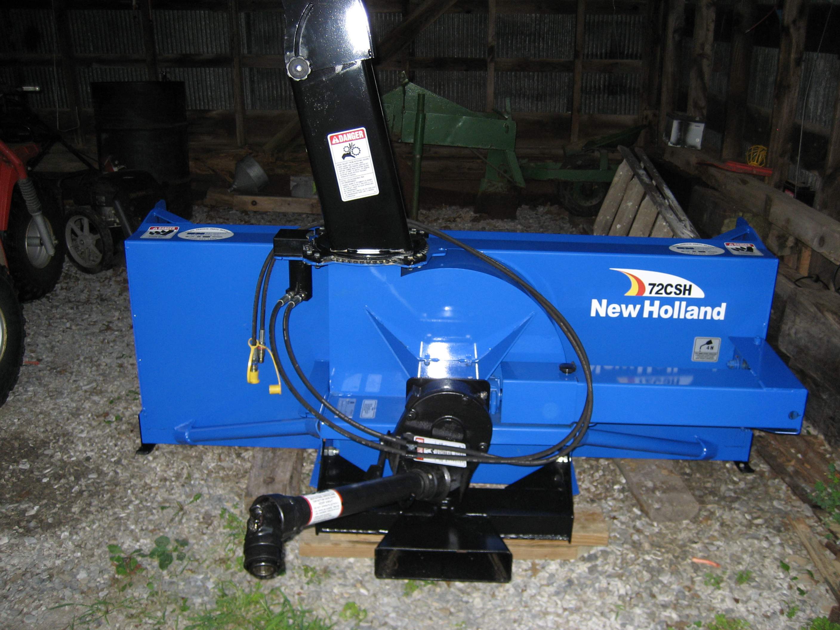

No problem at all, that's what so great about these forms you can get a lot of insight and heads-up on all kinds of equipment. First off I'm glad you're going with the front to clear the snow so much safer on those winding mountain roads. Yes basically everything is run off the loader joystick up and down and shoot rotation however since you already have the plow I assume you control the up-and-down with a remote that will free up your two loader outs for rotation and deflection, the first year I didn't have the snow deflector, what a mistake getting out every time to adjust the snow throwing angle when the winds would whip up pain in the @@@ . I found some more pictures some of the snowblower without the hydraulic shoot deflect, angle shots of the tractor hooked up with the blower, and its final day waiting for the new tractor to be delivered and take my little baby away, boy I miss that front snowblower if you zoom in you can see the hydraulic deflector. Now there's one other thing in the pictures of the snowblower where the gear housing bolts to the blower it was held by two bolts on top and two on the bottom after two weeks the bolts would constantly work loose even with Loctite. I thought I had a picture of the repair but I can't find it so I'll try to draw it you'll get the idea tell your dealer if you do buy the snowblower you want him to put a plate of steel on the top to grab the next two bolts it stops the twisting action which loosens the gear housing as your snow blowing from vibration. My dealers dad is an ex-engineer he fabricates things you couldn't believe how professional it looks he welded a 4 inch plate continuing from where it ended you couldn't tell it look like it was always there and the best part no more loose bolts. Now I'm not the best at explaining things but I think you get the idea when you see the picture and maybe new Holland has changed the snowblower for my design but if not make sure they fix it you're going to be doing a lot of snow blowing it sounds like and it will definitely come loose. Well take care I should be getting my tractor back tomorrow or Tuesday from its recent mishap, I had his dad fix one other problem for me I think a lot of people will like this solution especially if you work in the fields with all the dust it entails the exhaust system going vertical :).
