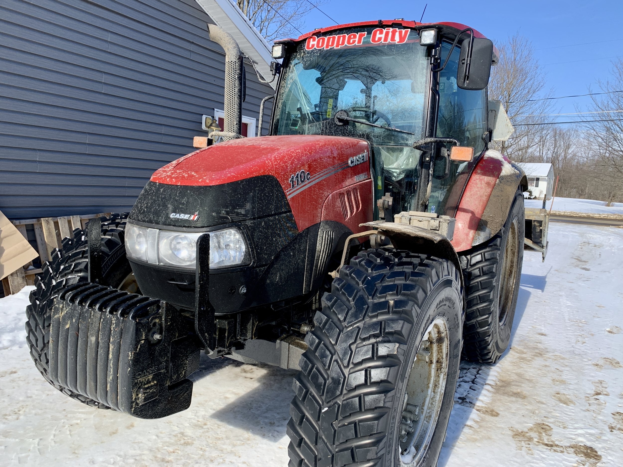

I traded a two year old 75c in on a new 110c two years ago. We can compare them in some ways but not in others. The largest difference is one uses Def. The 110 has much more power as you would expect. Little more lift in the back. I am running Nokians on the 110 so cannot say much about roading or pulling capacity. The 75 is a bit sluggish but certainly a fine tractor. The 110 handles my 2000 pound blower on the back a little better. The taller tires take the rough roads better. Cabs are pretty much the same. I think the 110 is a hair quieter. Hope this helps.
