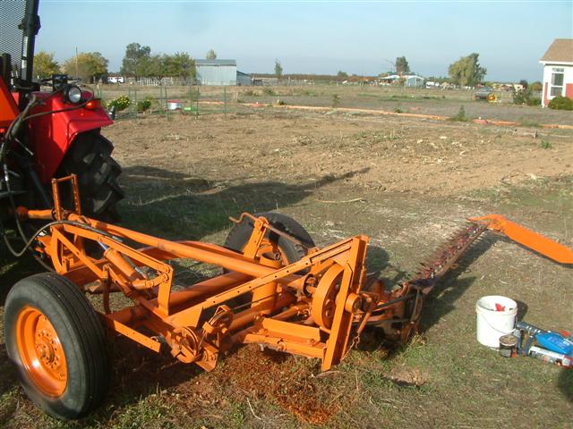

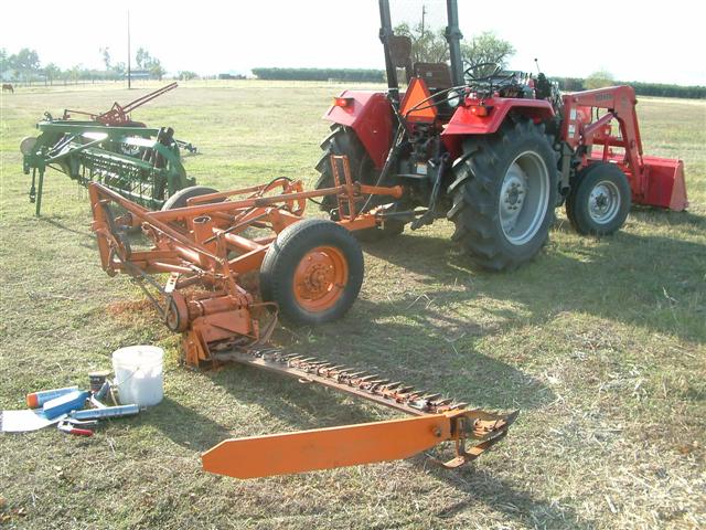

My old Allis Chalmers 80T trailer-type sicklebar mower cost $125. Everything worked OK when I bought it about 5 years ago. Now the drive mechanism needs new bearings. The county used it to mow right of way.
