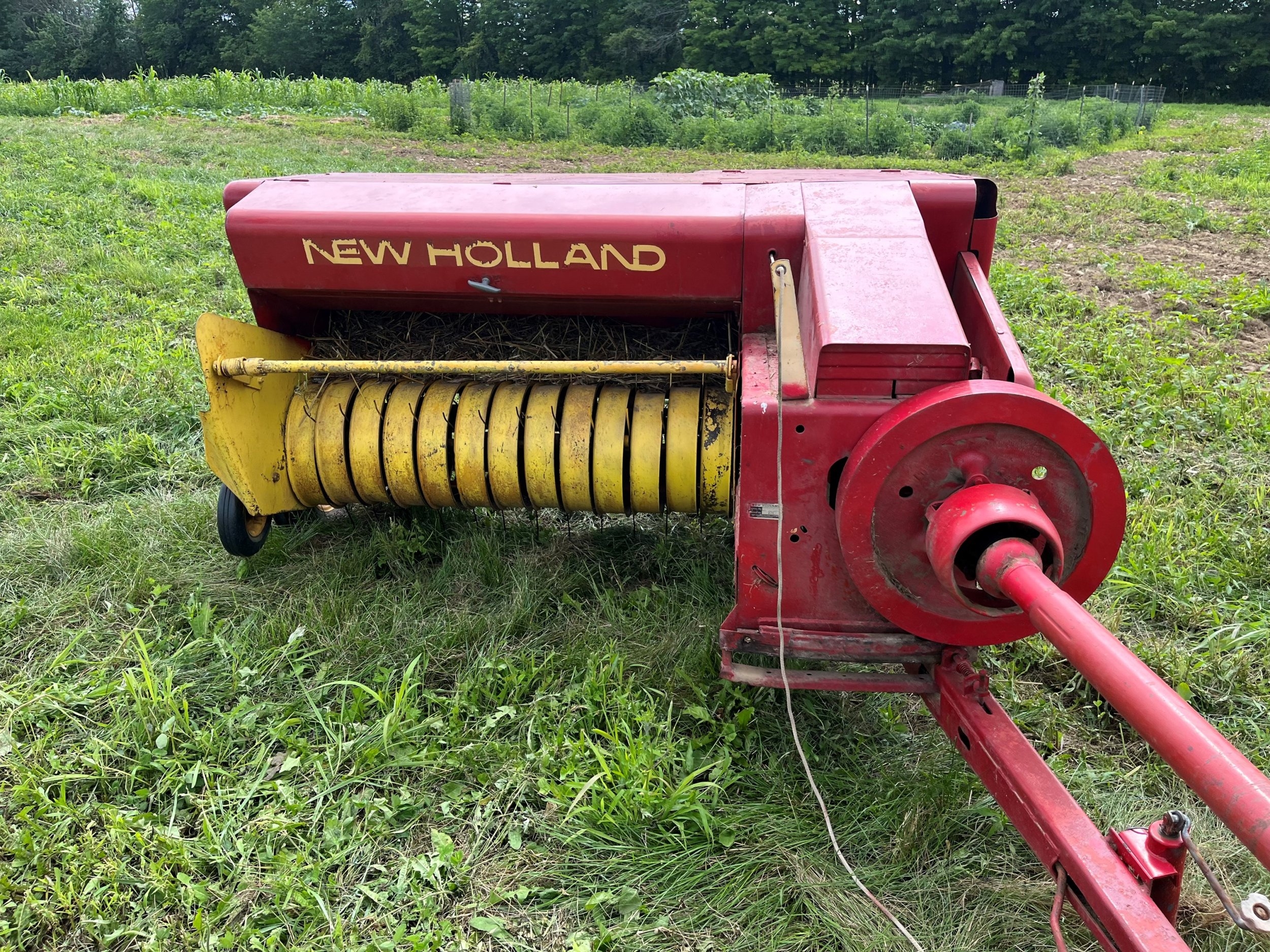

Hello All - I am attempting to bale straw for the first time (or I should say bale anything for the first time). I have a New Holland baler (per the photo). When operating, should the pickup wheel be on the ground? I am concerned that the fellow I bought it from put it in a transport mode for me to drive to my farm... and I can't figure out how to lower the yellow chamber so that the wheel rests on the ground. I have the manual.. but that hasn't helped me.
I tried baling today for the first time. The straw was getting jammed in the chamber.... but I think it may have been a little too moist and that may have caused it to constantly jam. I loosened the bar that controls the density of the bale all the way, but the straw would still jam in the chamber and the twine would break as the bale was trying to get through the chamber. . Since I have never baled before... I don't know what I am doing wrong. Maybe I am doing everything right, and I just need to make sure the straw is very dry.

Let's start with the pickup release. On the right side above the pickup wheel is a rectangular bar that is held up by a chain retained L shaped pin. Remove the pin and allow the pickup to drop.
As far as the jamming of the straw, you are probably traveling too fast and feeding the straw too fast. Start in your lowest gear and feed it very slowly. A heavy window from a large combine may require a speed of less than 1 mph. You want a minimum of 13 strokes or more per bale to obtain consistant bale shapes.
Twine may be another issue. Is the twine in the machine old twine, non-synthetic and past its prime. Consider replacing it with synthetic twine.
And finally, contact your local NH dealer and have their baler guy come out and get you started. Certainly better than calling him after you have broken something major. good luck

Checking the diagram for the 271, the L shaped pin is on the left side of the pickup head and not the right. Item 56 on the pickup group parts page.

Hello Halftrack - many thanks. I’ll look for that L-shaped pin first thing in the morning. The twine is synthetic and new from last season. I’m moving slow and getting over 13 strokes. I have kept the PTO speed low… maybe that’s an issue. I have a 60 HP tractor so I could increase the PTO a lot more if necessary. Thanks again!!! I’ll post on how I do with it tomorrow.

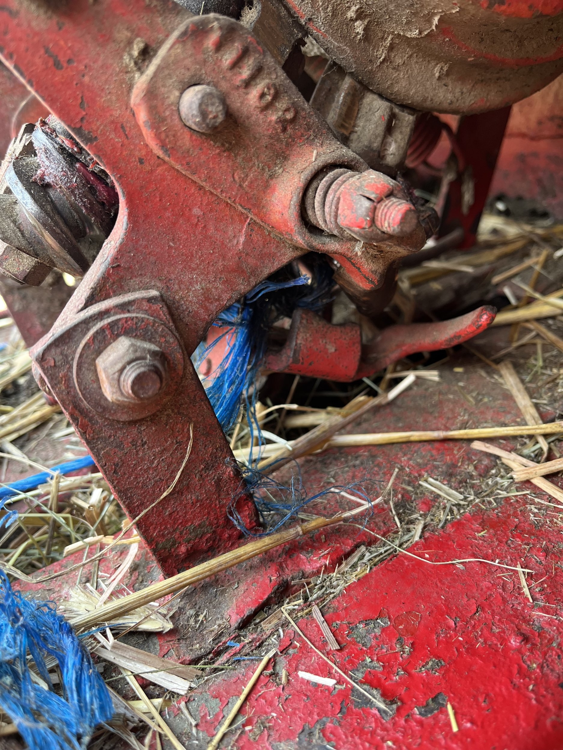

Hello ZZVYb6
Lots of great info here that I did not know. I will watch the video a few times and that will help me better understand your comments. I need to understand some basic terminology first. I’m the meantime - the twine frays on the right side as I stand behind the baler. Here is a photo. This is the only side that is breaking.

   / New Holland Hayliner 271 pickup wheel question and breaking twine
#9
@Halftrack and @zzvyb6 - Many thanks! All your info significantly helped. I’m baling!!!!!!
