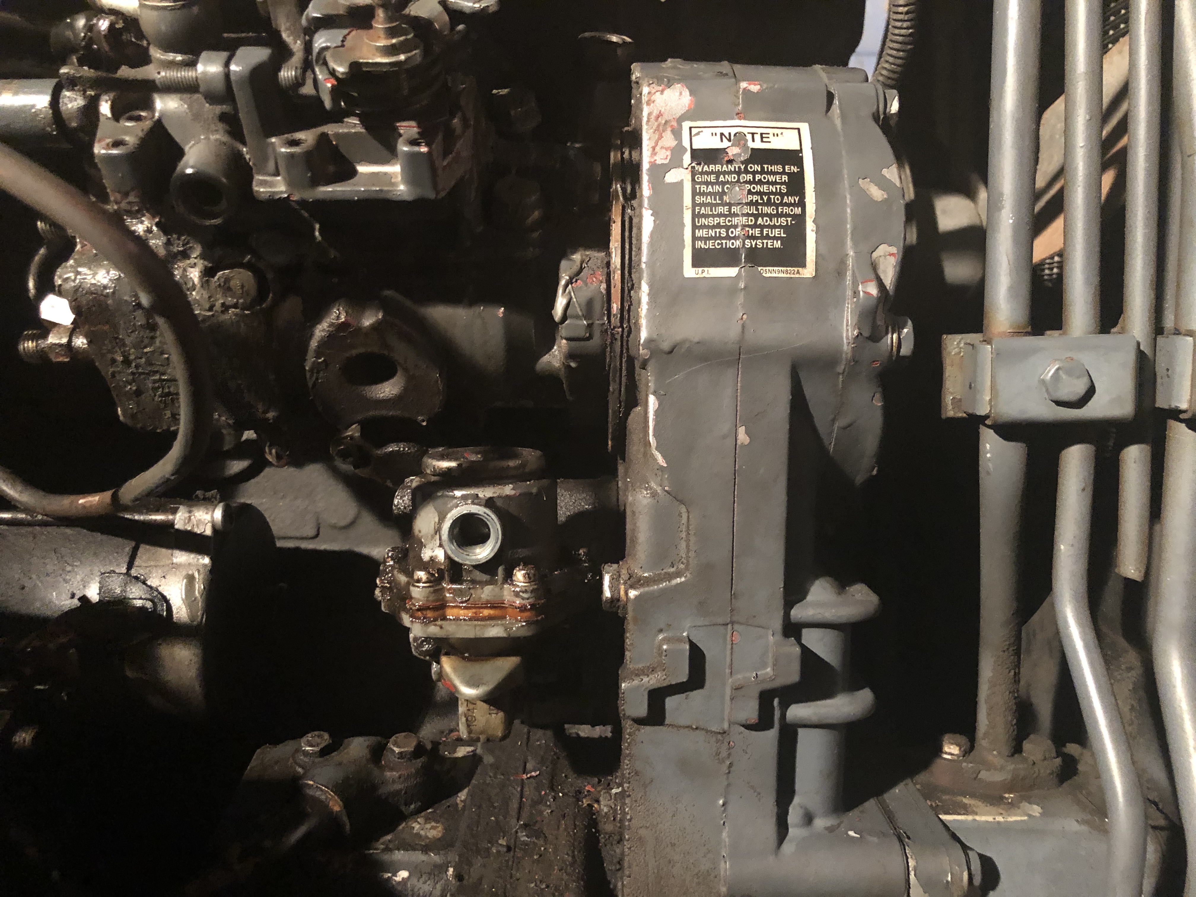

5F0C130E-0372-4DC1-88A8-3D0740F172EA.jpegB3F5BAB7-FE83-4EF7-A525-447D0AE9E804.jpeg061F8897-7E87-43C0-8E42-196147AE6AE9.jpeg7141ADFF-1C5A-4D72-848A-8F9143BC4235.jpegDC28367C-8F15-4A3C-BE67-9E6A96C891B5.jpeg963F316A-AA08-4D20-AFB2-17A36883A518.jpeg5F0C130E-0372-4DC1-88A8-3D0740F172EA.jpegB3F5BAB7-FE83-4EF7-A525-447D0AE9E804.jpeg061F8897-7E87-43C0-8E42-196147AE6AE9.jpeg7141ADFF-1C5A-4D72-848A-8F9143BC4235.jpegDC28367C-8F15-4A3C-BE67-9E6A96C891B5.jpeg963F316A-AA08-4D20-AFB2-17A36883A518.jpegHey guys, I have been trying to remove the fuel injection pump on my new holland 3010, but having a hard time. Ive removed all the bolts and the lines and have tried to pull it out but it is not coming out. Am I missing something to disconnect? Anyone have any tips or advice? I cannot seem to find the shop manual anywhere and my local dealer has not been super helpful.
Also any particular timing marks I should be looking for? Thanks in advance.

U HAVE TO remove the plate IN-FRONT of the injection pump & remove the nut holding the shaft to the gear..
DO NOT drop the washer or nut..
& u NEED a puller to pop off the gear from the shaft..{special tool}
WHY are u removing it.?? That small leift pump by the inj. pump can cause all sorts of problems..
Remove the 8mm nut on top & have a look inside.. is it full of trash.?? Is the diaphragm torn.??
Look at the gears behind the front cover.. I'm sure there are timing marks that meet up when its timed correctly..
Bolt the pump back up & slowly rotate the engine until u see the marks..
