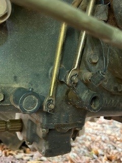

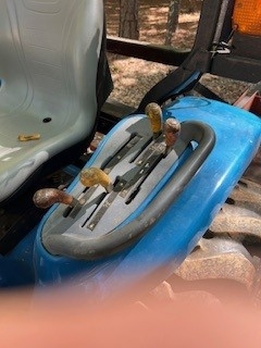

New Holland 1925

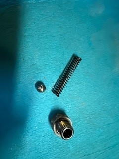

I own a New Holland 1925, 4x4 with Hydrostatic transmission equipped with a Bush Hog 2245 QT frontend loader & WR Long 4-N-1 bucket (Love it). Anyway, when I have the PTO engaged with any implement attached, the PTO has started kicking out. I checked the detent spring & ball and both were OK. Does anyone have any ideas on what else could be causing the PTO to kick out? I only have about 1300 hours on this machine and everything else works great.
Any suggestions on what might be wrong would be appreciated.

If the PTO gears that you engage have worn down, such as from grinding into gear, that will cause it not to stay engaged. There are two different springs used, but no telling why. I remember as a dealer, we had this problem on 1910s and there was a service bulletin for the issue. I will try and see if I can find that.

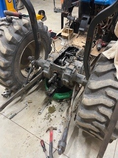

Problem found: Had to break the tractor in half to get to the transmission. After taking it apart, we discovered the PTO Counter Shaft was eaten up. The new part (#SBA322570702)can be found at CNH.com and at Messicks for about $600 - $650 however, I found it new somewhere else for a lot less $181. If you need to know where, email me and I'll provide you that information.

   / New Holland 1925 HST - PTO kicking out while engaged #5
Wow. That has seen a lot of grinding trying to engage. Have you been pressing the clutch pedal when engaging the PTO?

Yup, that will do it. I don't need one, but good price find!
I agree, has someone been forcing it?
