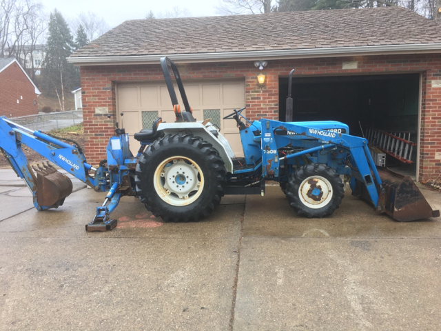

Oh wasn't planning on anything from tractor supply just that they are close to me and never heard of rural king only to find out there are two within 25-30 miles of me. Thats going to be the big decision is the off set. The width of the tires outside to outside is 63" and they can be narrowed by 2" more each side but the tires have calcium in them so that's not a easy task and not sure if i want to make it any narrower. Not sure how stable it would be for when the backhoe is on it and the fel on it. IMG_5402.JPG

Oh wasn't planning on anything from tractor supply just that they are close to me and never heard of rural king only to find out there are two within 25-30 miles of me. Thats going to be the big decision is the off set. The width of the tires outside to outside is 63" and they can be narrowed by 2" more each side but the tires have calcium in them so that's not a easy task and not sure if i want to make it any narrower. Not sure how stable it would be for when the backhoe is on it and the fel on it. View attachment 496344
I narrowed my 1920 to the narrowest possible setting (59"?)
I did that because I have level land, and wanted to be able to pass between some tight spots.
I also have a hoe, but it is on another (a bit larger) Ford.
You are absolutely correct.
Wider is better! More stable! Period!
I now would say that you should get the 5' offset Tillovator, or perhaps even the 6' KK.
Better budget for eventual new rims for those rear tires.
Your tractor is now 17 years old and the CaCl is currently busy eating away your rims.
CaCl is HORRIBLY corrosive....even with tubes! I speak from experience .... TWICE!!!
If they are 14" wide rims, (they may be 13") you might want to de-mount the tires now, clean up the rims, replace the tubes, and put windshield washer fluid back in.
If you loose those 14" rims, there are no more available ..... anywhere.
You can buy new 13" rims, but I think the 14" rims are better.
