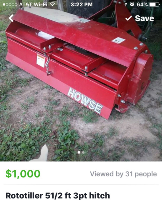

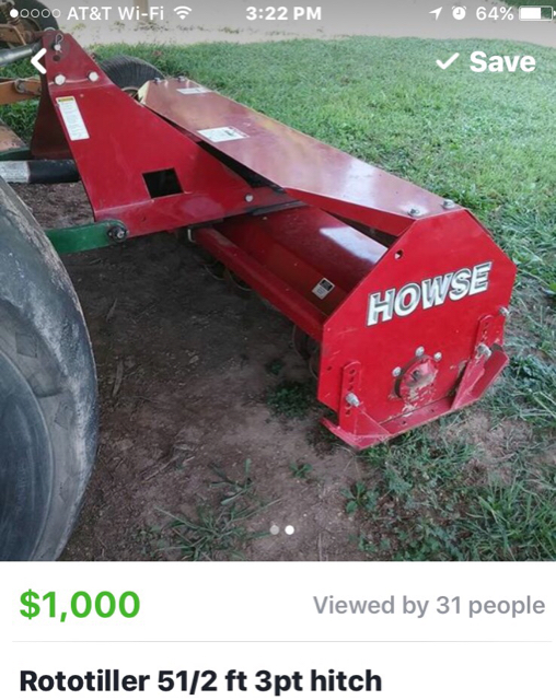

I found this ( not sure if even still available) but it doesn't seem to be built half as heavy duty as the king kutter IMG_5494.JPGIMG_5493.JPG

Howse claims that their 62" tiller weighs 819 lbs. That is a good thing, but I think they also sell new for more money than the KK!

I believe the kk weight the 6' was like 750-800 lbs the howes just doesn't look as heavy built it does have the heavy cast side gear box. The way the tires are set right now I'm at 63" but by the looks they should go in another 2" on each side. Not sure if i would want it any narrower though. Might be worth taking a look at this howse as its 5.5' wide and says 30-50 hp the pto on the 1920 is rated at 28.5 I've never had a tiller my thoughts is if needed just go a lil slower? I thought i read on the king kutter that it didn't need the full 540 rpm when running it. I may have been confused too

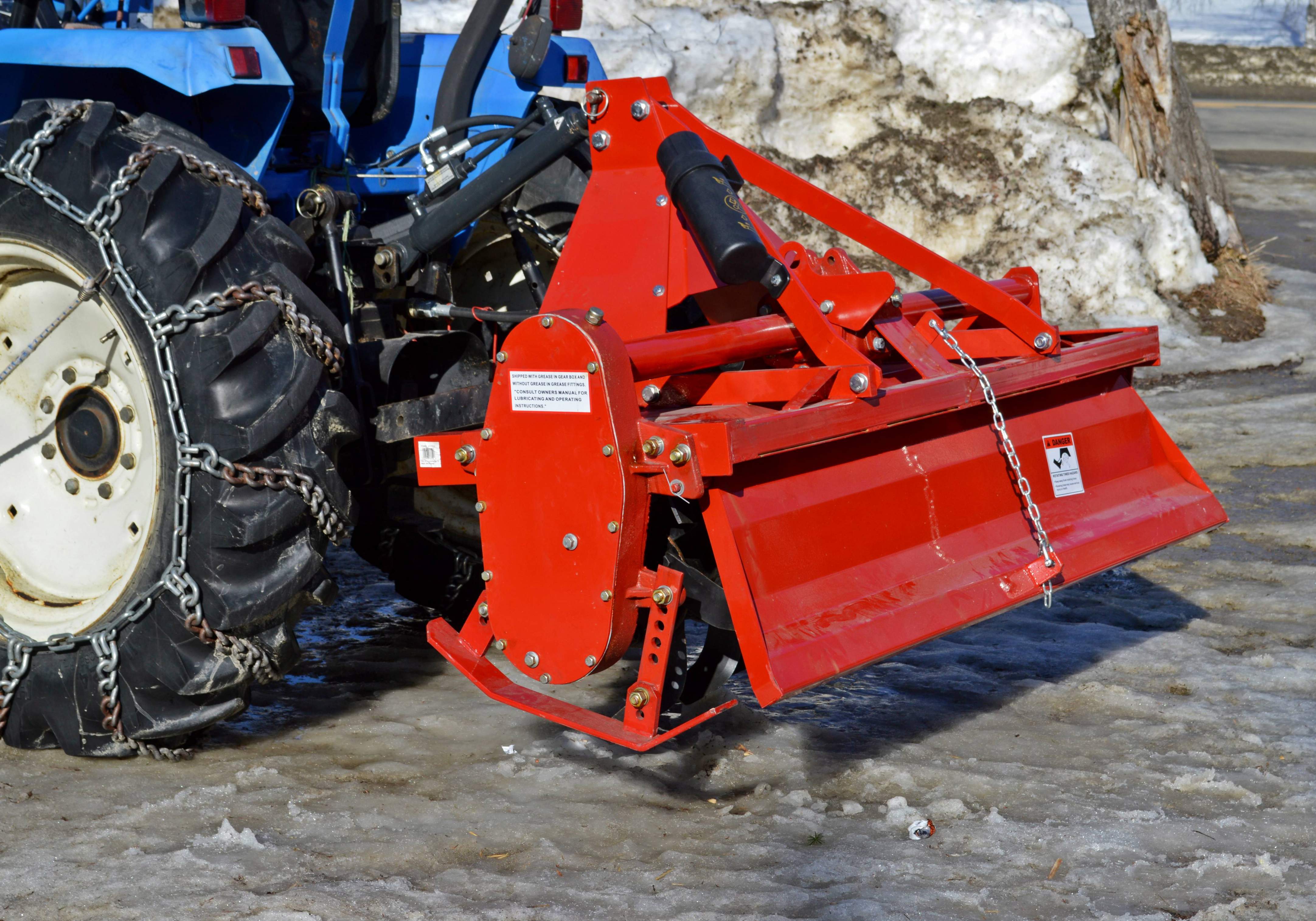

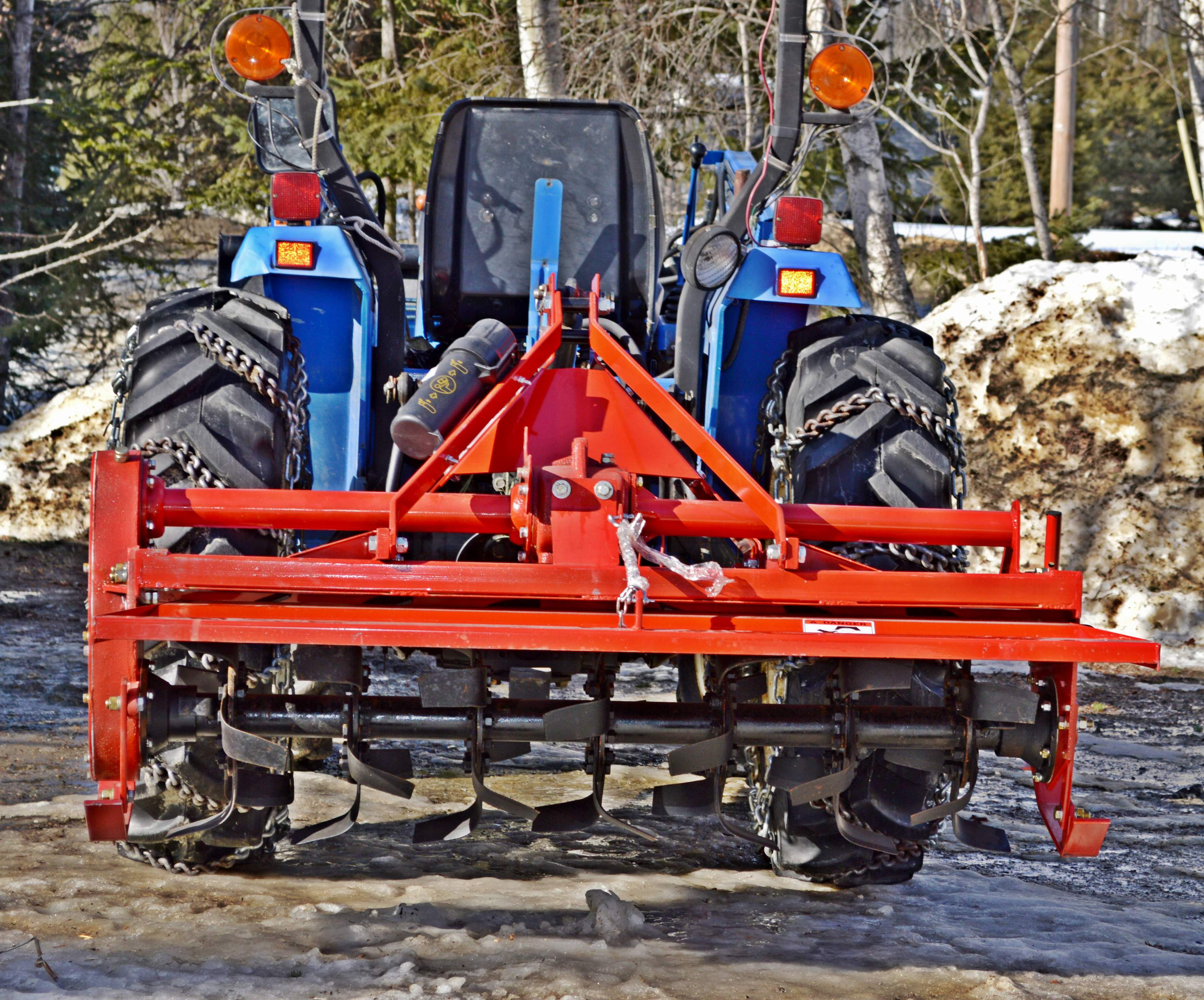

I run this 5' tiller from Agrisupply. Very rugged. Had it 2 years now- never a problem. - 1319.99 + 347 shipping to my doorstep in Maine. Cheaper than the local Tractor Supply. The pics below are from when I had it delivered in March - just off the tractor trailer. My tractor is a NH TC30.
I have a 9x3 manual. 30hp, 25.5hp at the pto. I till in M 1st at 2200rpm. Going in L 1,2,or 3 just feels too slow, and it seems to do a better job going just that bit faster.
Tillovator-Rotary Tiller | Agri Supply #7771
   / New holland 1920 what tiller #10
I bought my King Kutter tiller, and THEN I learned of the "Tillovator", sold by Agri Supply.
I assume the "Tillovator" may be built in China.
King Kutters (except gearbox) are made in USA.
That said, I have heard only good reports about the Tillovator, but it is chain drive, and the KK and Howse are gear drive. That is a major durability issue for me.
Agri Supply is a great company to deal with though,.... for buying ANYTHING!
Your ( tcreeley ) Tillovator price of $1319.99 + $347 shipping = $1667
The current price of the (KK) TG-60-YK from Blaine's Farm & Fleet is $1555.99 + $143 shipping to zip 15066 (Western, Pa.?) = $1699. That is a difference of only $32.
For the $32 difference I would DEFINITELY buy the King Kutter 60" tiller!
