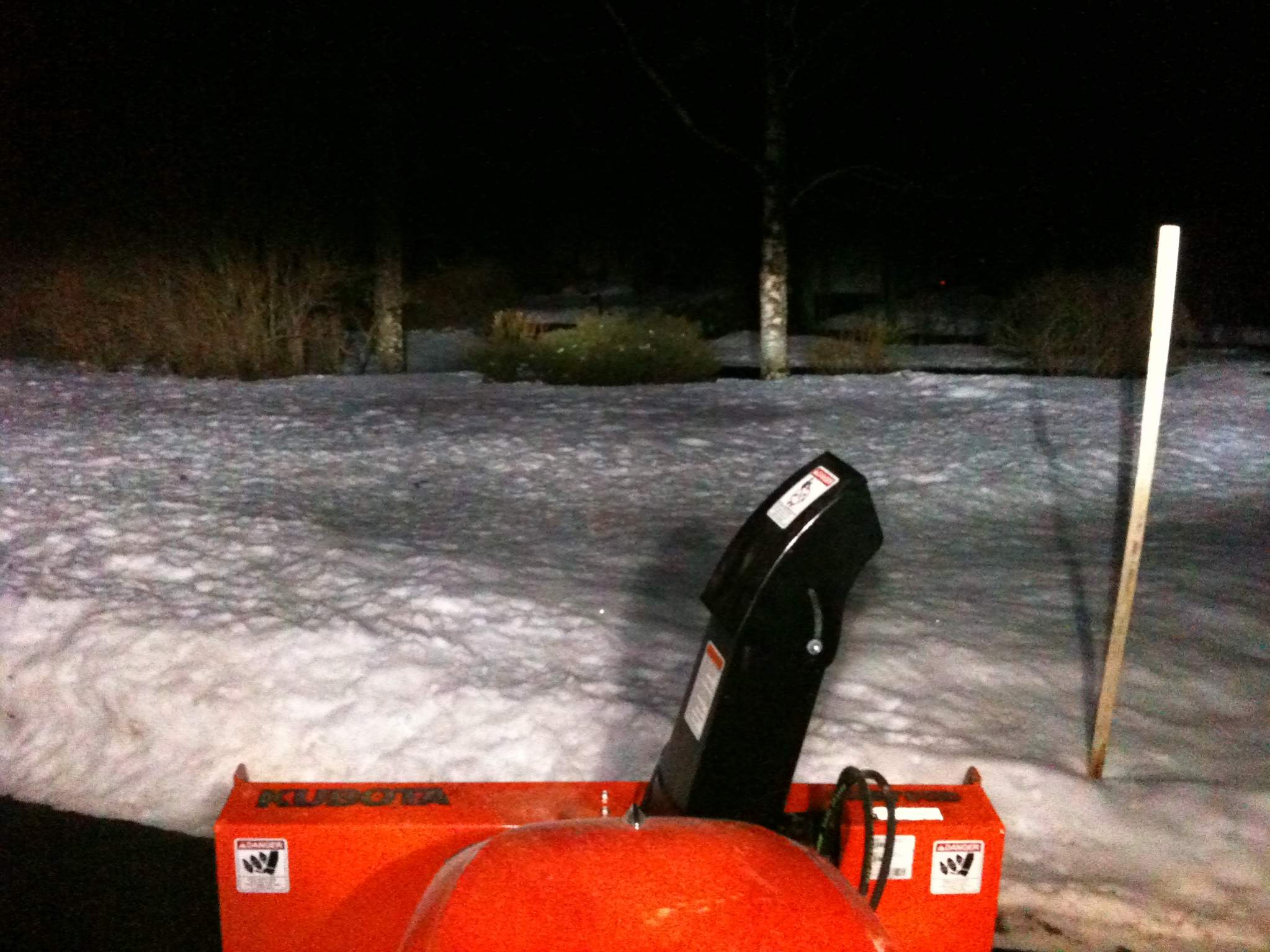

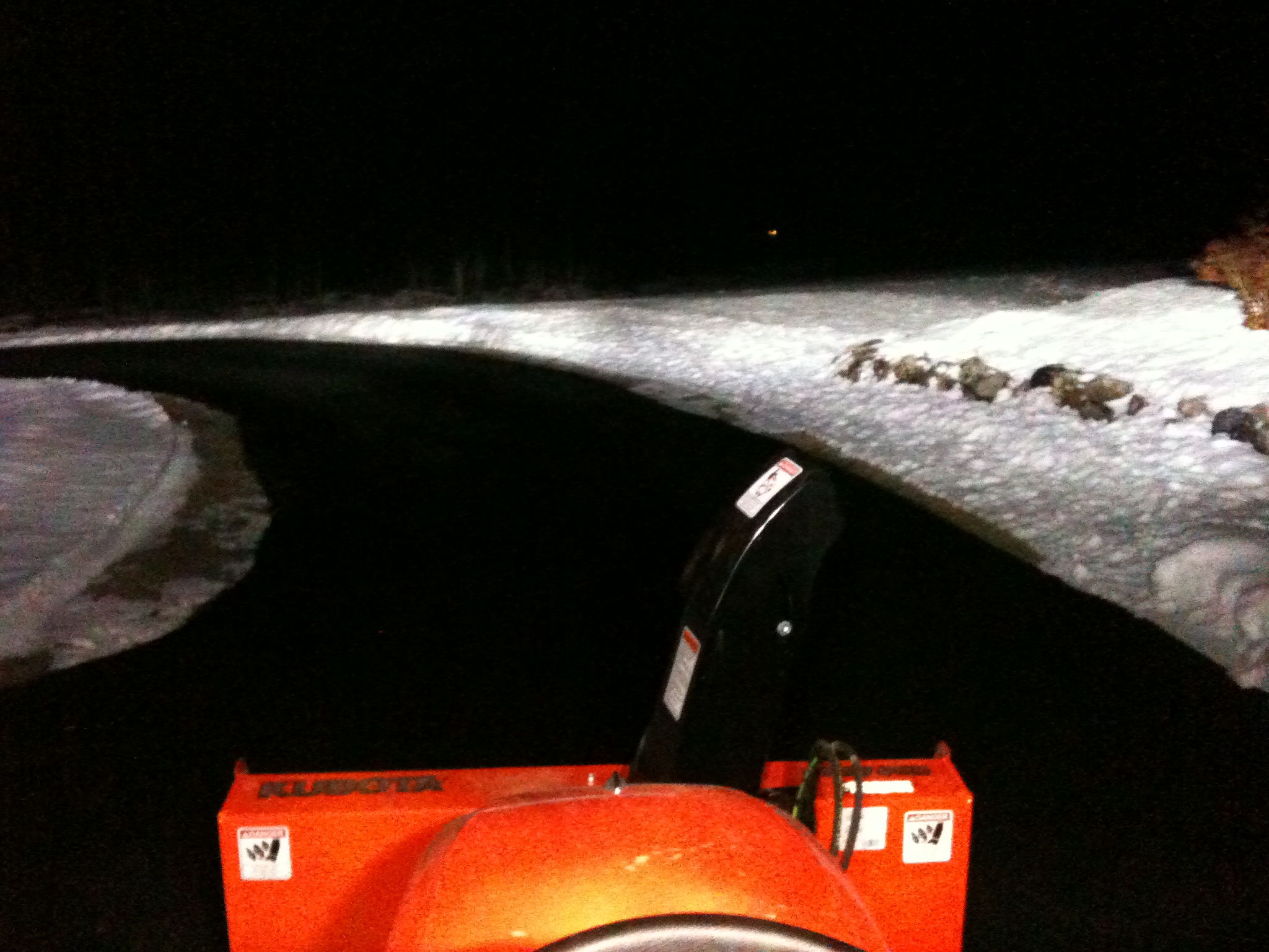

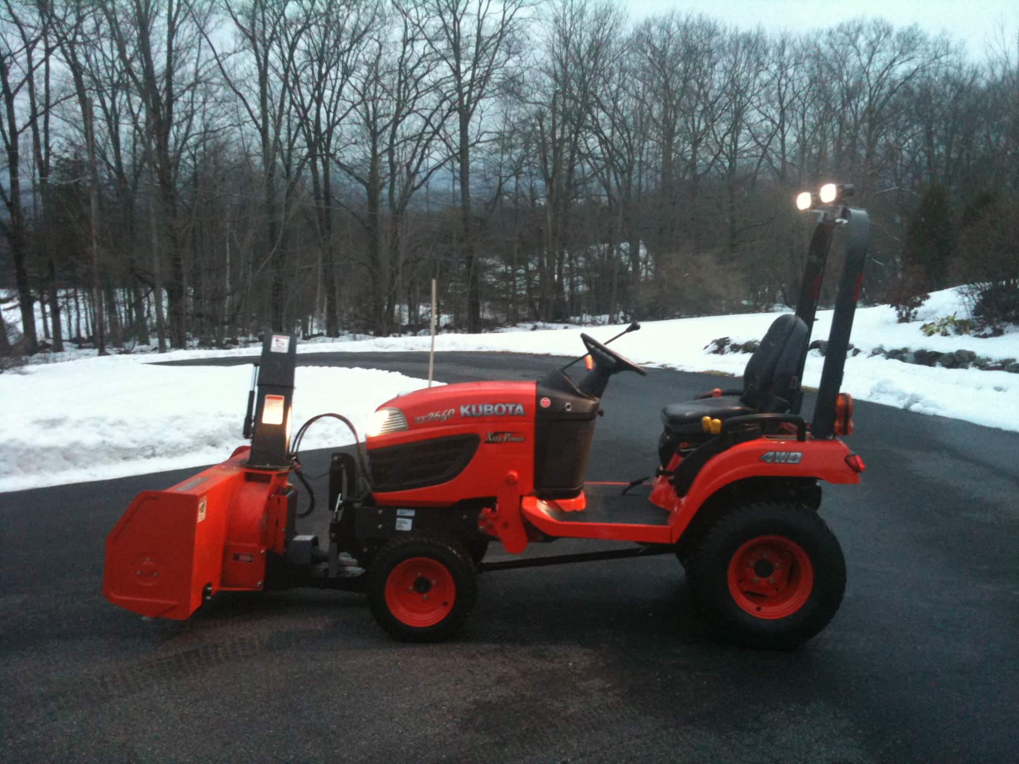

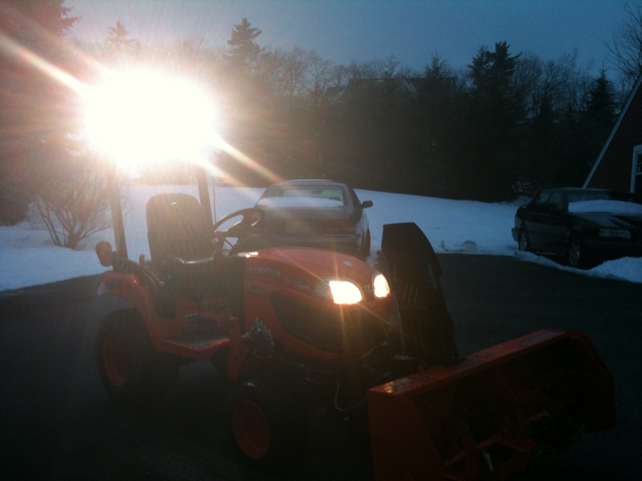

Just wanted to share some pictures of the work lamps I've installed on the orange beast. They came out great!
6000 unadulterated lumens blasting out into the darkness...

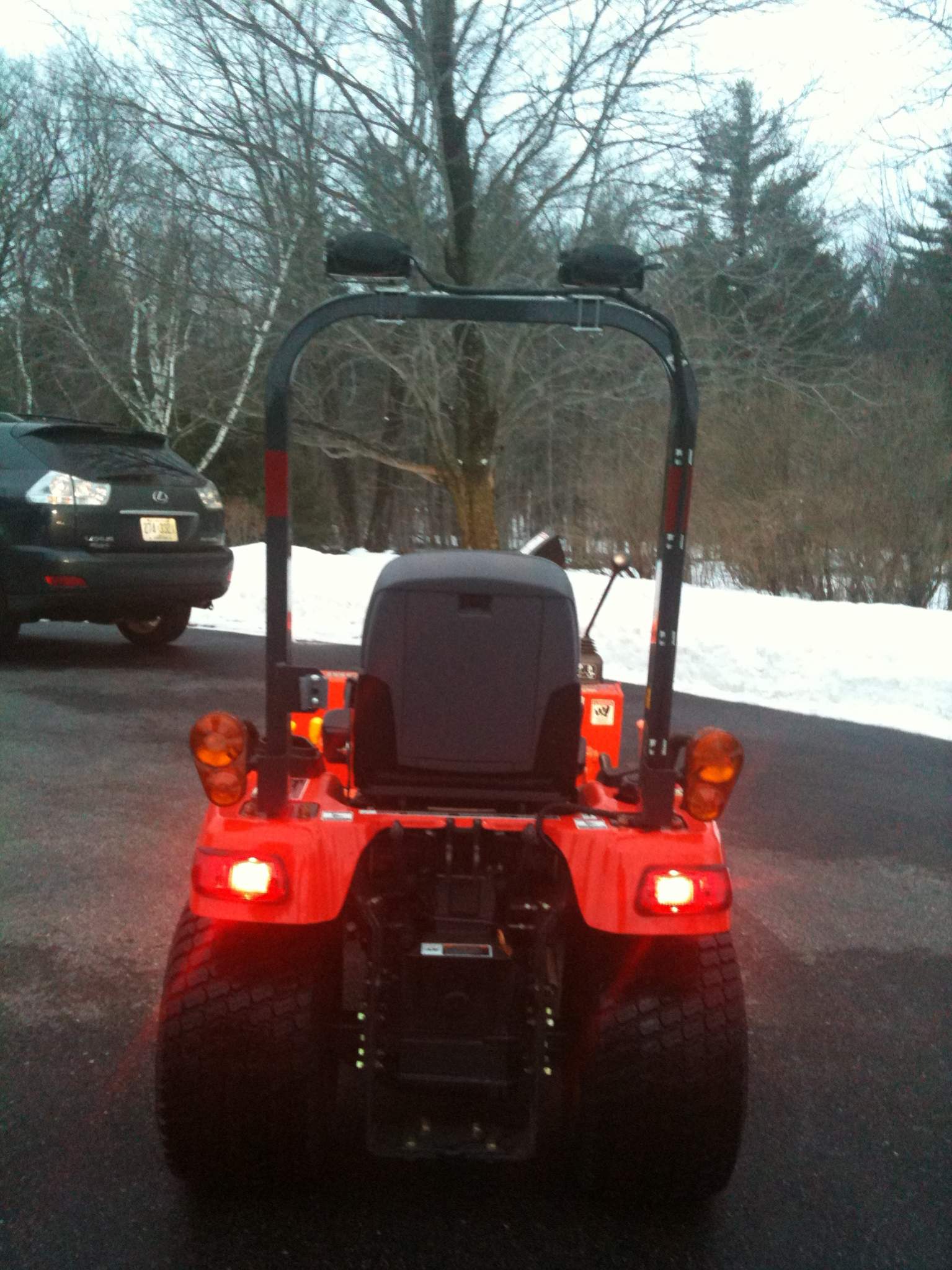

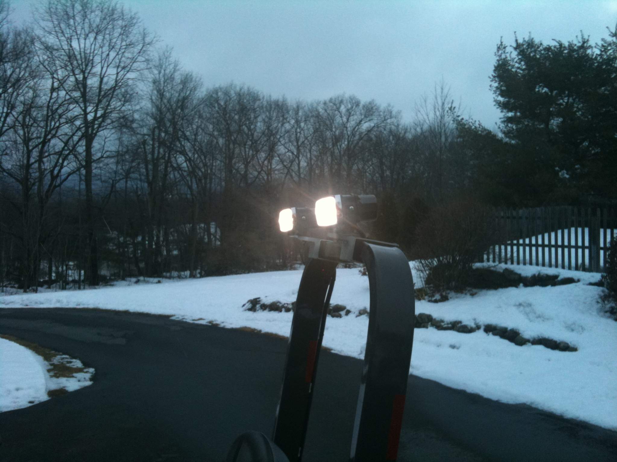

I used a modified Osram Sylvania Xenarc X1010 High Intensity Discharge (HID) Xenon Lighting System that has had the bulb shield removed. Although that makes it a glare hazard for on-road use, that's not my intent, and getting as many lumens projected out was my goal.
Each ballast went behind the tail lamps, the power switch for the rig is an IP65 rated LED lit rocker switch that fit perfectly on the plastic flat next to the cup holder.
These are un-edited pics off of my phone, so the comparisons to the stock headlamps are apples to apples, and the night shots are just that, straight shots from the phone.
I'm throwing a lot of light, I'm thinking of this would be a fun way to play late night back-yard wiffle ball tournaments...
Certainly not a conventional set of work lamps, and my wife certainly thinks its overkill, but what fun would a conventional setup be...

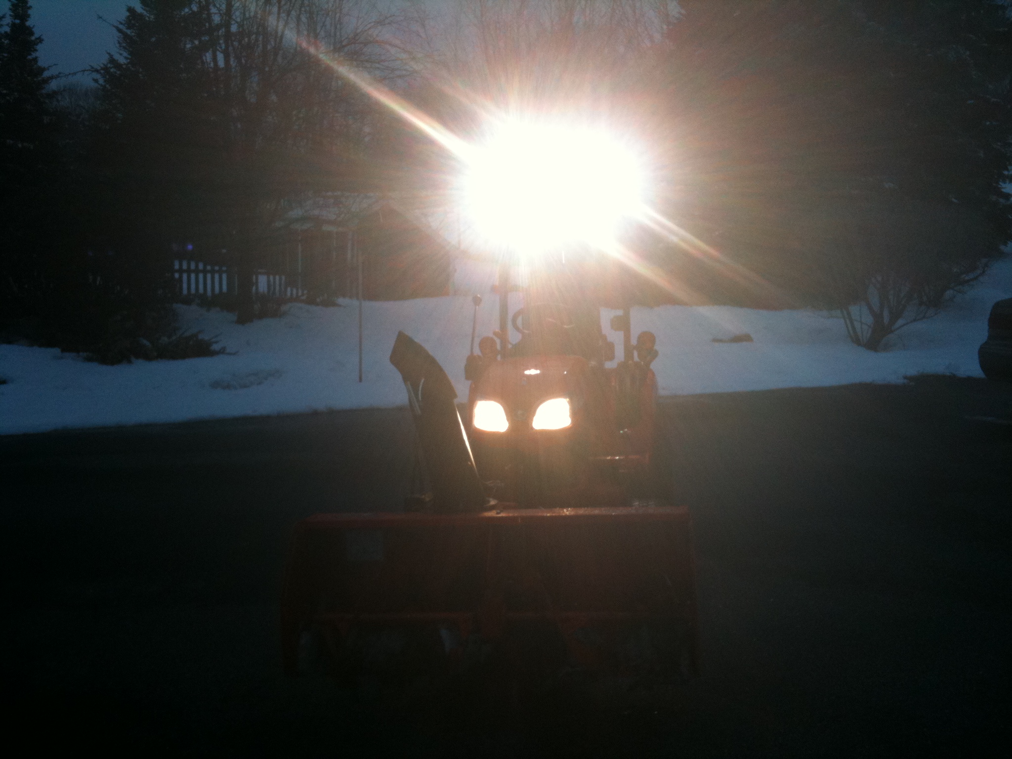

Warning!; Looking at the enlarged versions of the above photos may damage your vision! ;)

Nice! don't you need a rear facing light too for backing up?
/ New HID Worklights on BX2660
There's enough light spill that I can actually see behind me...
(as long as I don't look up and blind myself.
Also, I mounted the work-lights on a bracket that can swing over and shoot backwards if wanted.

I do have the 40 amp alternator, but since they're HID they start out at 8 amps each, but then within a minute they reach steady state run current at 2.3 amps each. That's the beauty of HID. The initial power draw is high to start the arc, but it drops drastically in short order...
HID is more energy efficient than Halogen, but LED is even more efficient than that, but more costly at this point...

Nice set up. But w/ the lights up on top don't you worry about ripping them off on branches or something?
j
/ New HID Worklights on BX2660 #13

I had a set from an old project...
I've seen them on ebay and other sites from time to time.
I set it up with the mounting harnesses so I mount them as high as possible in winter to shoot the beam pattern over the snow blower onto the ground, and in summer I can flip them around to have them under the ROP bar to protect against tree limbs and such...
That was my logic,
