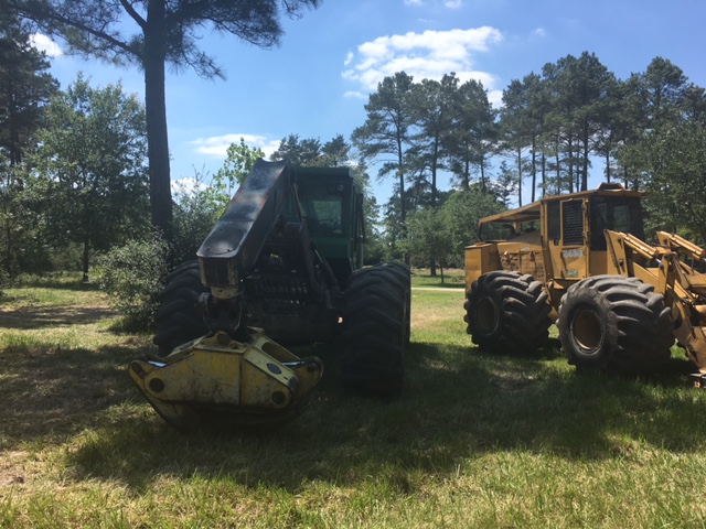

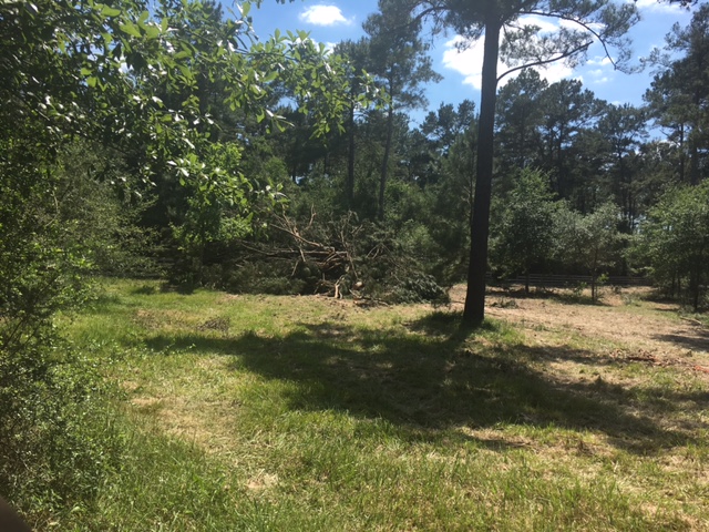

Here are some pics of the machines he has, from the job he is currently on in the neighborhood.
I do not know anything about these machines, maybe you do?
He's just wanting free wood. He has a lot of overhead with payroll and equipment but you have a commodity that he sells. There's several mills in Cleveland. Hardwood is the only one to truck a good ways. The trucking isn't bad if there is good lumber there. They can make money and not trash your place at the same time. The above quotes you got by the Ton were reasonable. The 6 month contract isn't unusual. Basically gives him freedom to move around if weather. He doesn't want to pay for move the equipment back and forth a bunch so I'd be willing to bet he would finish it at once.

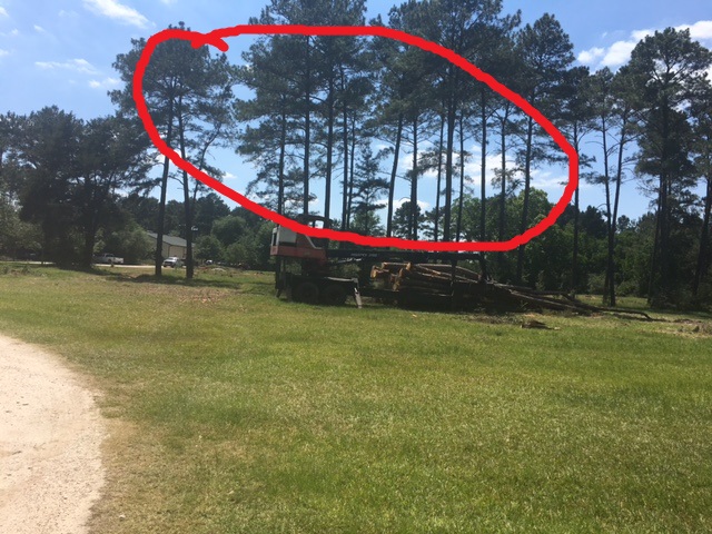

What do your trees look like?
Are they like the ones I've circled:
attachment.php
If so they look big enough to sell for chip-n-saw. But if your trees are slightly smaller (pulpwood) or quite a bit larger (sawtimber) it could be dramatically different.
As was reflected in your quotes.
In the south pulpwood is going for about $10/ton, sawtimber about $22.
attachment.php
The only way to really determine value of your trees before dragging them to the mill is with a timber cruise, and even then it's only an educated guess.
But if you could provide some representative pics and measure the DBH (diameter at breast height) of a few we could make a slightly better guess.
