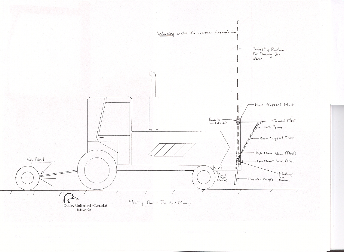

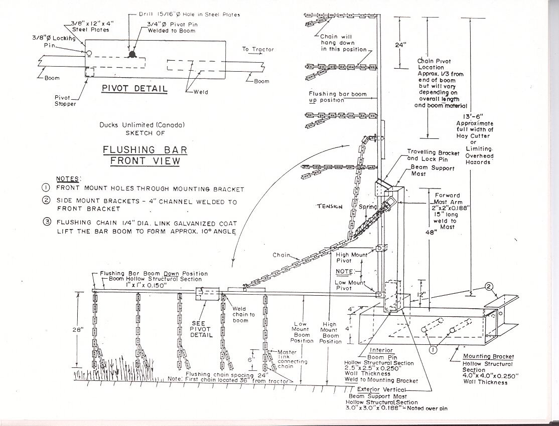

Hi folks,
I am working on a project in Michigan which will be providing flushing bars to farmers to reduce dammage to wildlife during hay harvest. These bars drag chains or similar things through the forage before mowing. I have a proven design for tractor drawn mowers, but find little information on bars for self propelled mowers. Anybody out there got plans or expirience? I have attached the plans from Ducks Unlimited Canada for those who are interested. Feel free to e mail off list or post here.

1. Many use disc mower conditioners that run at 2-3x the speed of old sickle type machines. I mow at 7 -9 mph with mine. If they don't flush during the previous pass adjacent to them, I can't see them escaping the mower.
2. Not many farmers will want to dangle metal objects infront of a disc mower conditioner. A 10 ft length of say 3/8 chain could do upwards of 10,000$ damage to my mower and could kill me if a link is thrown at the right angle. The blade tips are running at something like 60 mph.
3. Experience? I have hit fawns with my mower. Upsetting but we have no shortage of deer. In my experience you can basically drive over them if mama deer has told them to stay still. Once in a while they will flush. I cut late partly to avoid hitting them and nesting birds, partly due to weather. Cutting late is hard as the forage is long and hard to spot animals.
   / New guy seeks help from hay folks #4
Its a good idea ... I don't think it would be for me, I too am not for anything hanging in front of my disc mowers. It easy enough to hit a foreign object in the field ... I don't recall ever hitting any game or fowl.
