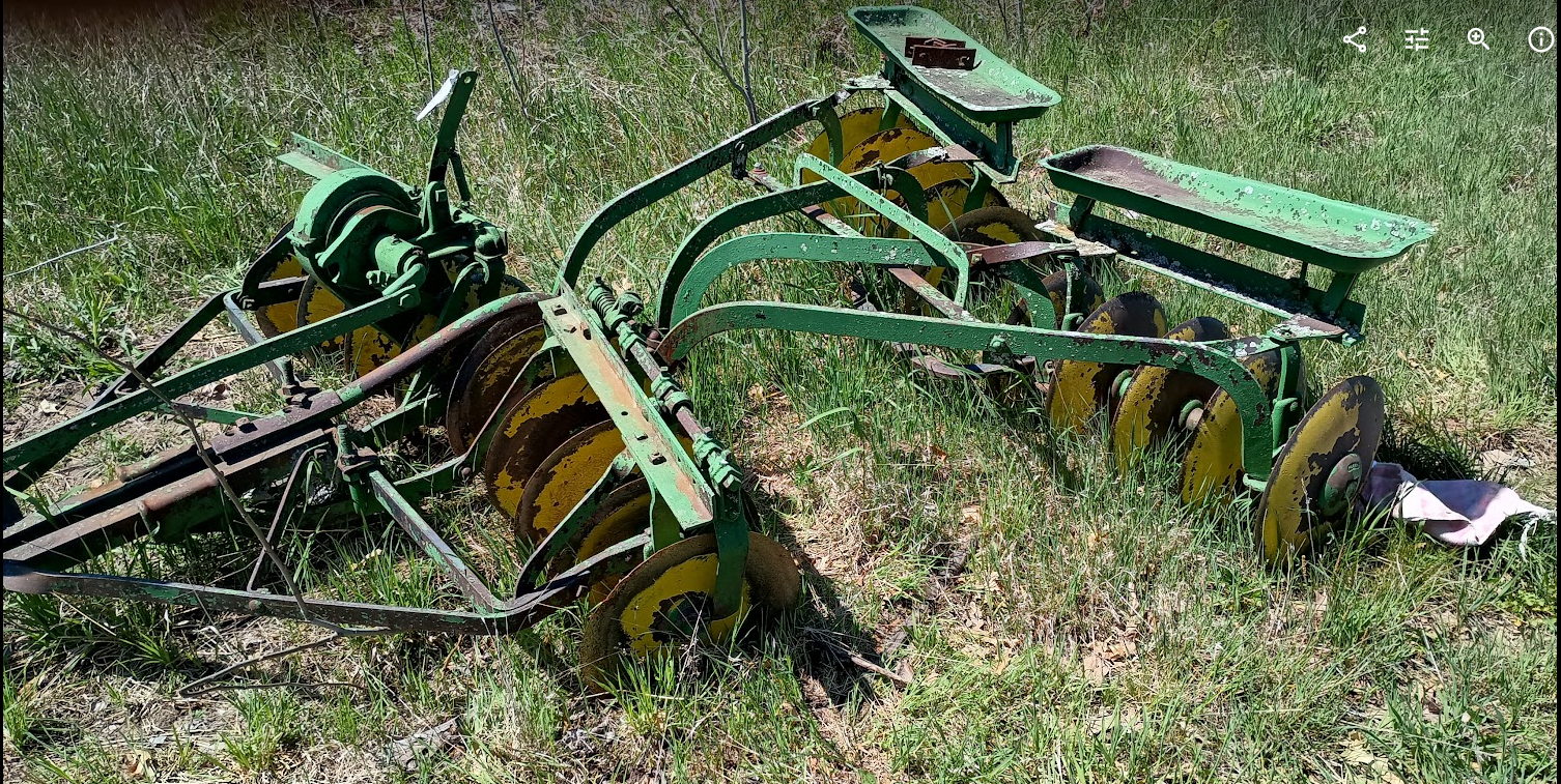

I bought an old tandem disc on auction for a food plot (it was actually a lawn ornament). At first, 2 of the axles were frozen. I managed to grease most of the zerks, but not all and got it freed up. It was difficult to get the grease gun lined up, and more than a few times I had a big gob of grease spill over. I could not get 2 zerks to take grease at all.
I bought a LocknLube and it effortlessly greased those 2 zerks. Sometimes you find something that costs more than you think it should, and you find out it is worth every penny. It paid for itself on that disc alone. ( I paid $80 for that disc and it works great)
