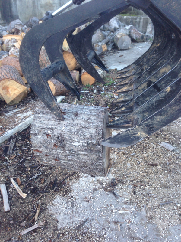

One more thing - do I want my upper tines to be able to close past the lower ones?
I would rather the tines meet the bottom on a sharpened edge several inches wide so I could clamp on small saplings. The way my grapple is configured it takes about an 8" log before I can securely clamp it. image-106241288.jpg That picture was testing my at that time newly installed teeth. If I was really trying to clamp the log I would put it inside the grapple with it centered between the V of the lid.
