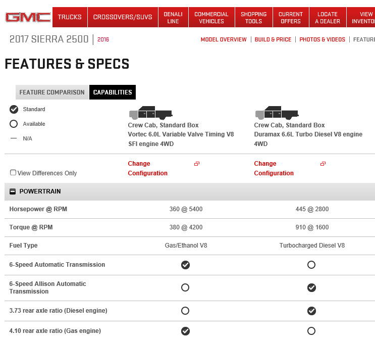

Not sure where you got your numbers. It is like night and day pulling a trailer. In the 2500HD the 6.0 gas motor at 360 HP and 380 ft/lb torque is no where close to the 6.6 Duramax at 445 HP and 910 ft/lb torque. With gas you also get a 4:10 rear axle ratio instead of a 3:73 rear axle ratio and a standard 6 speed tranny instead of the Allison.
The Duramax package at $10,600 MSRP included the radio with navigation, Bose speakers, engine exhaust brake, power fold trailer mirrors, and front & rear park assist plus other options so the Duramax engine only adds about $6,000 to the cost. The other options we would have added so their cost is a wash. Plus you can only get the Allison transmission and engine exhaust brake with the Duramax.
If my 03 had been a gas motor the trade-in value according to the dealer would have been $5,000 so I made my money back with the diesel plus the cost of the fuel I saved over 14 years. As far as routine maintenance I don't spend any more for the diesel than a gas motor. A visit to the dealer for service every 10,000 miles is $79.99. A gasser is $39.99 every 3-5,000 miles.

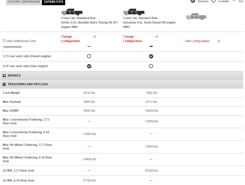

But the gasser in that configuration can tow a heavier 5th wheel....

I drove both. There is no comparison especially when you put a trailer behind it and hit a hill. At highway speeds the gasser was screaming due to the 4:10. The diesel does weigh more than the gasser so you lose a little payload in the truck. Not an issue for me as my payload is going to be in the trailer.
But that is why they make both so everyone gets what makes them happy. :)

But the gasser can haul more weight in the box and tow a heavier 5th wheel camper than the diesel for $6000 less?
