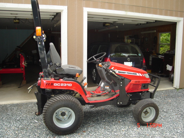

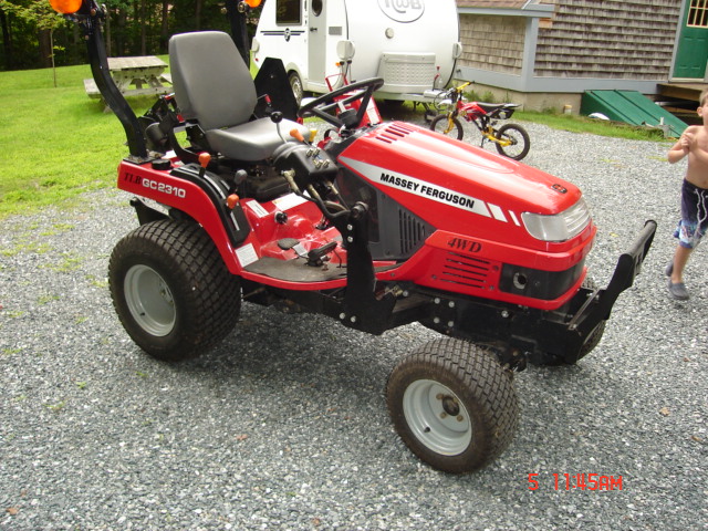

Wow- thanks for the info, guys. My Mom died last week so we've been tied up with the funeral, etc-- next comes the lawyer part....:(
Woody-- I don't know if I could swing it or not, but, yes, I'd be interested in your mower deck; I'd planned on looking for a used one. Don't particularly like to drive in cities --have been amazed at just how terrible traffic has become around Hartford!-- but have a small utility trailer and could pick it up easily. How much asking? Where are you?
Thanks to both you & Johnny B for the reports; they echo what my salesman had said about the mower deck. I've never owned any sort of a rider mower, so this will be totally new to me.
Also thanks for the tip about the backhoe-- I did practice taking it off last summer, and your suggestion sounds like a good idea. I was amazed at how "petite" the thing looks when stripped of its appendages! On the other hand, I've seen my older brother use his backhoe to good advantage with his Case 550D, using the hoe as a counterbalance to get into --and out of-- some amazing slope situations. (Yes, I've signed up for "lessons"!)

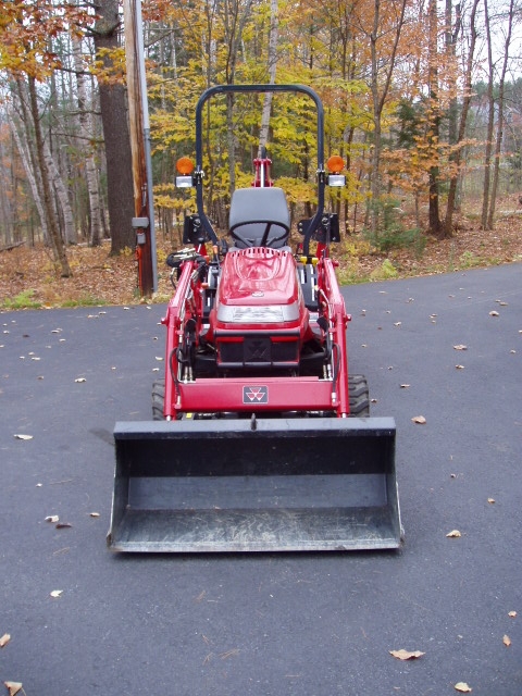

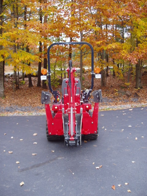

I don't have a mowing deck, but have taken my backhoe off several times to use the 3PH for the wood chipper, York rake, blade, or snow blower. One of the things I really like about my little 2310 is how easy it is to make the swap from BH to a 3PH attachment. That was one of the things that pushed me toward the red tractor.
I've never taken off the FEL, but it sure does look stripped down without these goodies.
I've made the seasonal switch from BH to snow blower now. The BH is resting on a dolly in the corner of my garage, and the snow blower is on the rear, ready to go.

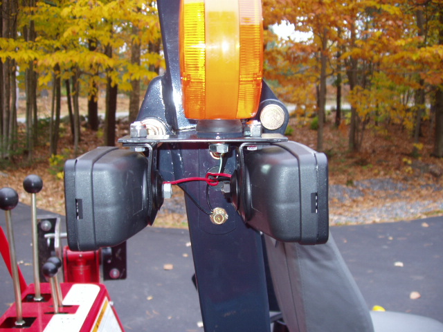

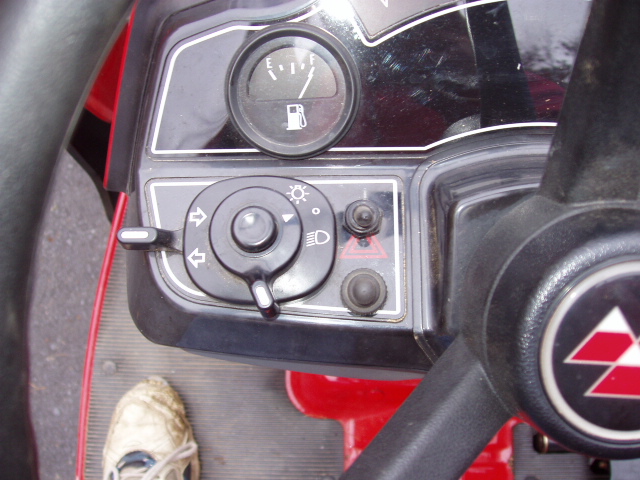

I did add some work lights - (4) 55w floods from TSC. I had a bracket made out of 1/8" steel and drilled to fit under the blinkers (using the same nut as the blinker post). The most time consuming part of the project was trying to figure out how to thread the wire through the center of the ROPS, but once that was done it went pretty smoothly.
All 4 lights come on at the same time and at first when I turned around, the glare was pretty annoying, but by turning them slightly outwards, it became much more tolerable.

Nice lights! No problems with electrical capacity on the 2310? You anywhere near Leeds/Lewiston? Got an old Army buddy that lives there, and often go up to see him.

Sounds like lots of years of good memories.
I'm not an electrical engineer, but if my high school physics is correct, each light is drawing ~ 4.6amp. So 4 of them total just over 18amps. The switch and the fuse into which I tapped are rated for 20 amps - and it's a 40 amp alternator, so I should be all set.
I just turn off the mini-fridge and surround sound stereo when I turn on the lights. :rolleyes:

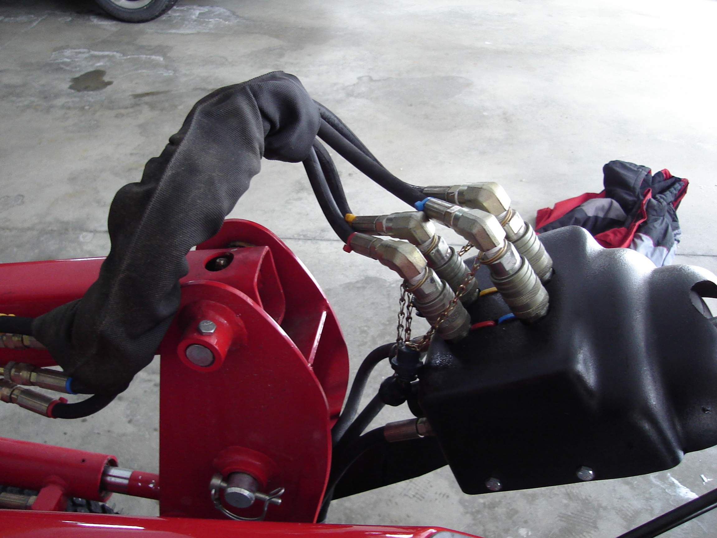

Removing the FEL isn't all that bad, but the procedure is relatively complex, involving putting the bucket down, tilting it, getting the feet/stand legs to touch, and finally, after pulling pins, driving the tractor forward --while tilting the bucket-- to lift the hinge points out of their sockets.... This won't work on a dolly on a concrete floor, unless you can stop the FEL from moving, obviously. I find I have to get the book out each time and follow the steps one by one....
But it does work. Once the FEL's off, it can easily be lifted to get a dolly under it. Hydraulic lines are also a bit tight; I had to take a picture of the lines hooked up so I could remember how to position them for reconnecting- they only fit one way, and have to be twisted opposite of what you'd think as they're reconnected....:eek:
