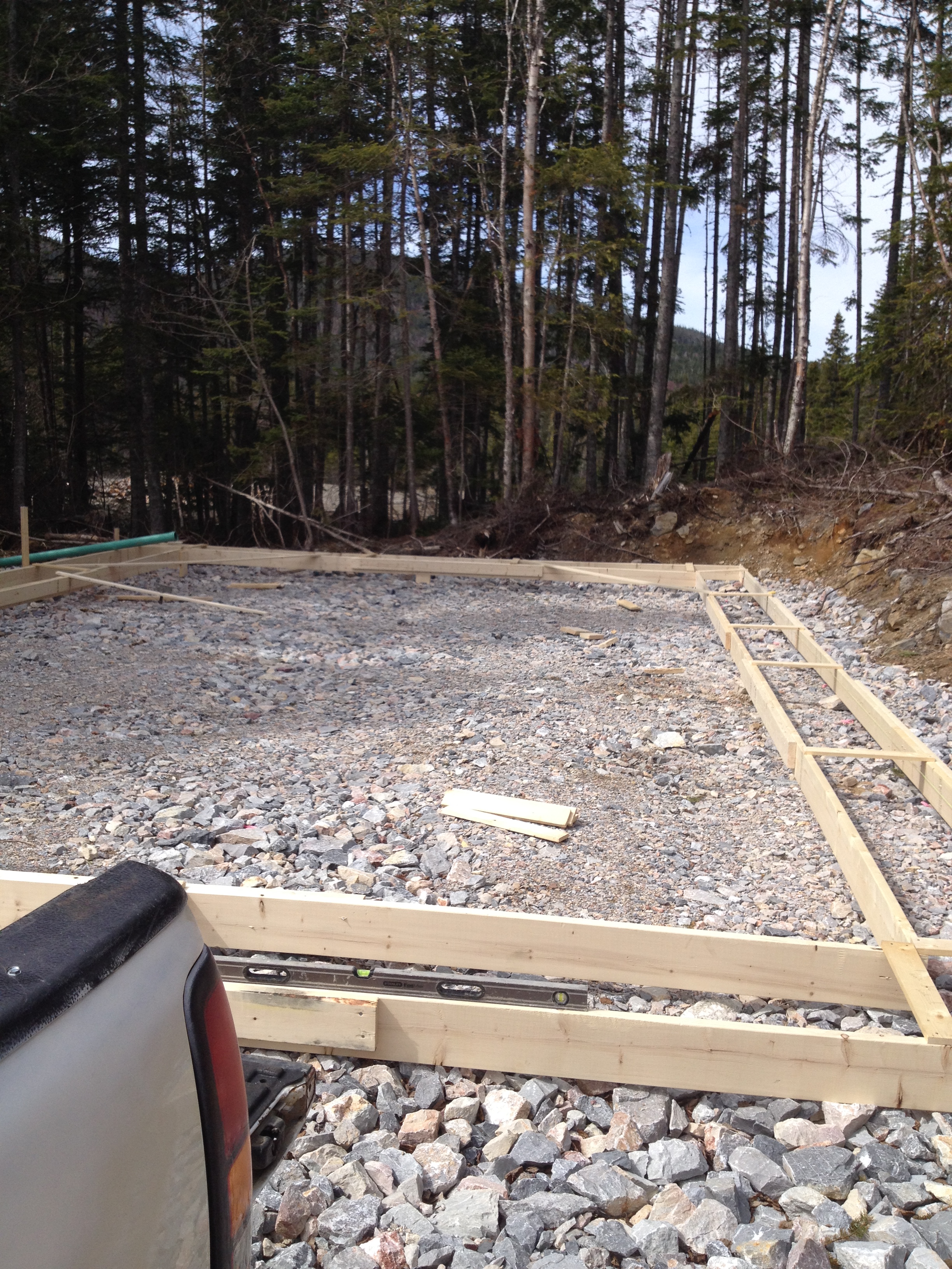

Its going to be 24 x 40. Its not a car garage. I doubt any vehicle will be parked in it . Its mostly to work on some other equipment I have, projects. Store the few toys etc. Yes, 24 feet with two cars parked side by side wouldn't be that roomy. They poured the footer just yesterday. IMG_0062.JPG

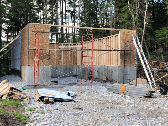

I built my walls 14' high, was told that's how high they should be for a car lift, if you have that in mine someday, after 5 years my someday hasn't happened yet. I made the walls, boarded most of it than stood them up with tractor, this is where a FEL shines, how'd you get your walls up?
   / New Garage
#37
I have 4 feet of cement plus 8 foot walls. The floor will be poored a few inches over the foot to give maybe 11'9" or so of height from floor to ceiling I'm guessing. I am still at work, nearly a month now. So some guys are building it for me. But I was going to do the same thing if I was in there myself. How else would I get it tipped up. I probably would have built it in sections and tried. But yours don't seem to be flexing much at all while your pushing it up. Pretty good. You look like you get some use out of that Kubota. The overall size is 24 by 40 x 12high. 6/12 pitch.
