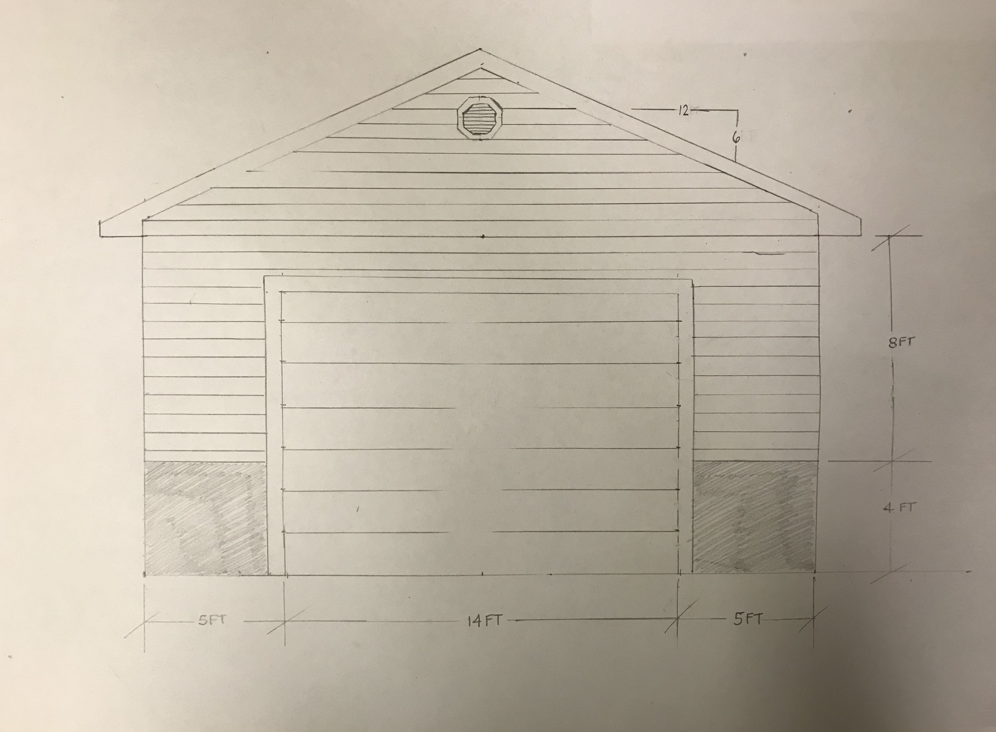

In the works of building a new garage. However, I'm out to sea at the moment and will not be in . I'm drawing up plans just to see what it would look like. It has to be 24 feet wide, but it can be any length. I was thinking 40 feet. With a 6 on 12 pitch. I was going to put it on 4 feet of cement plus 8 foot walls, giving me 12 feet. What do you think of that size? Anyone have pictures or thoughts on their garages and wishes that might of had.

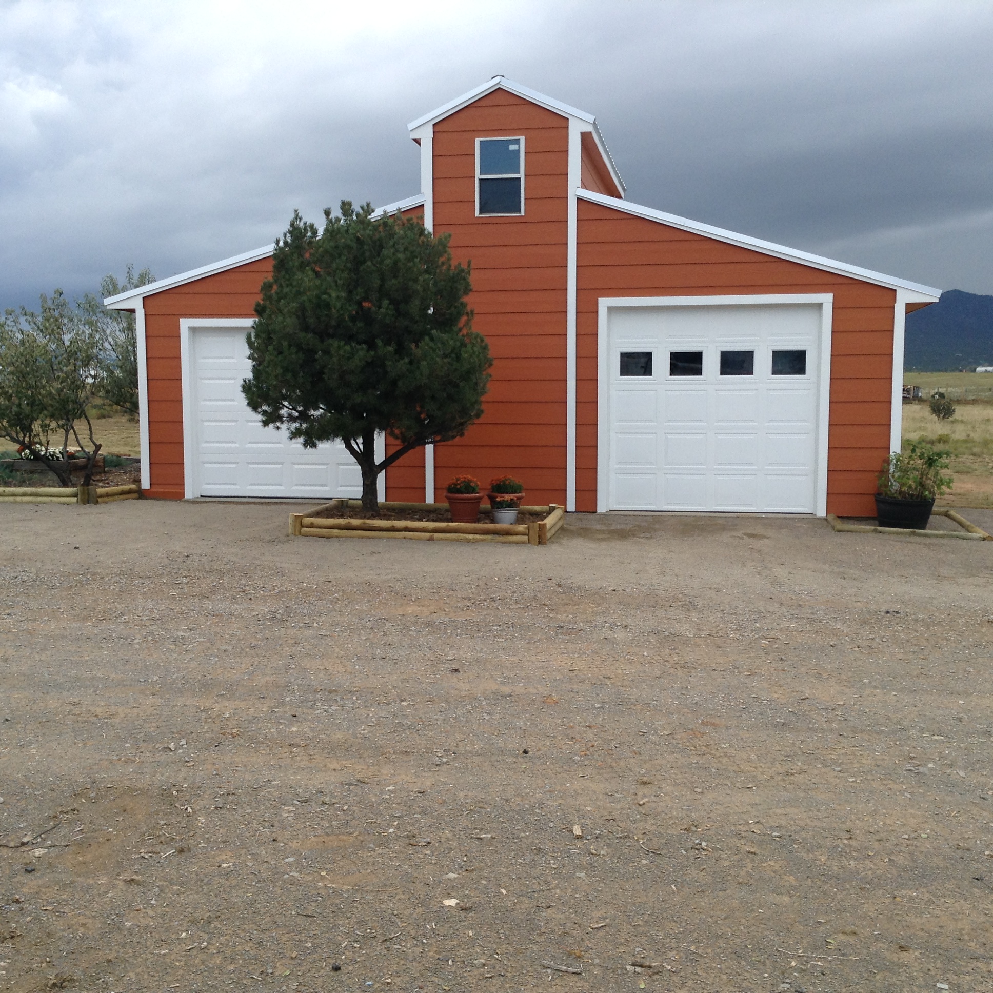

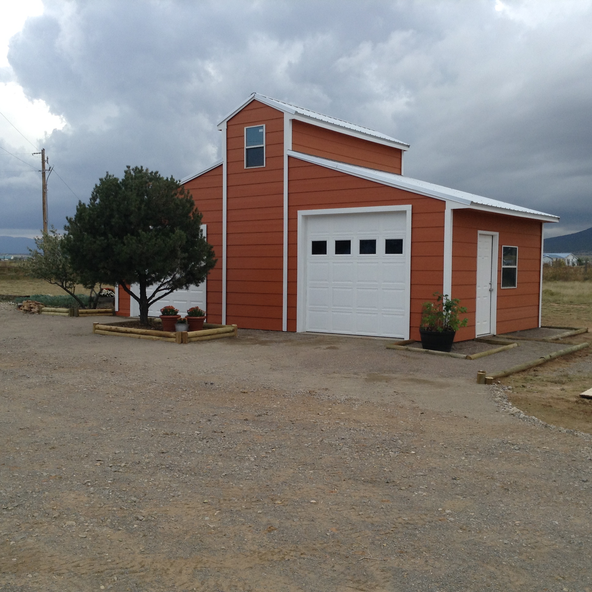

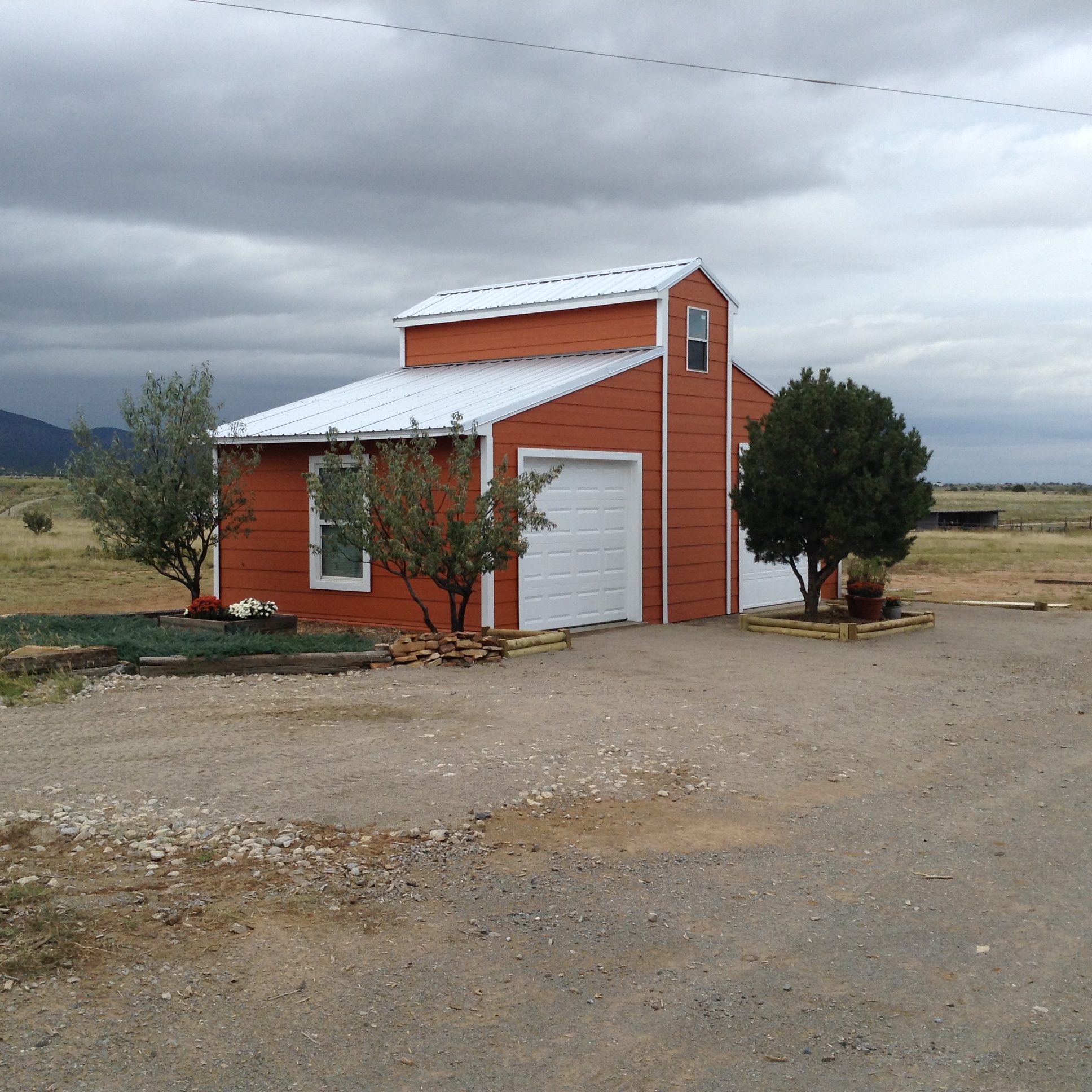

Having just built a "multipurpose" garage (shop area, maintanance area, tractor house, etc..) go a little bit wider, IMHO, at least 28 ft wide. A 4' side space, 8' garage door, 4' space, 8' garage door, and 4' space. This allows storage for stuff along the sidewalls without interfering with opening car doors, simply more space. I did mine 30' wide, with 2' on the outer ends, 6' between the doors. The 6' center section is actually 2 story, but the second floor is only 6'6" ceiling height. Used primarily for attic storage.

Well, I could go 2 feet cement, his forms on their sides, instead of standing up. Then put 10 foot 2x6's for the walls, still giving me the 12 feet interior height. As for the 24 foot width. It was initially for a 24 x 36 steel garage, so the blast rock was laid for that and no wider. For me to make it wider for a good solid foundation means I'd have to put off the whole thing. Which normally wouldn't be a problem but much happened to our homestead home, and I'd just like to get something up now. But yes, I almost wished now it was wider as I'd extend one eve out 8 or 10 feet with posts so I could stack wood or park something out of the rain etc. I also read about a narrow building looking too tall, and I am concerned of that. I did draw to scale, the front profile, 24 wide with 12 up to the eves, and then put a 6 x 12 pitch roof on that with 18 inch eves, just to see what it looked like. I didn't look like the best in the world, but not that bad either. It just gives me the height inside, so I don't know what else to do except to widen it which at the moment is out of the question. I am concerned of that though. I drew it with multiple different doors and I think the most practical would be a 10 foot high by 14 foot door.
