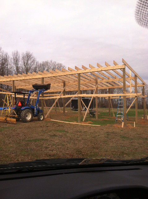

Clay was pretty hard. Took the front bucket on the New Holland, applied a little pressure and we dug holes like we were in loose soil. Without the pressure it was not going to happen. The cutting teeth seemed to be in good shape so I am not sure what the real issue was other than the dirt itself.

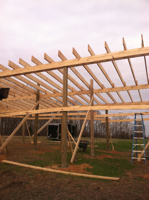

The building inspector made me add an additional girt since I was putting my 6 x 6 poles on 12' centers or I could have used a composite/glued laminated beam (too costly). Total of 3 2" x 12" x 12" bolted on posts.
I used 2" x 6" purlins. That is more than what was really needed. 2" x 4" would have been fine.
I hope to order the metal roof on Monday. Two week delivery.
Wood take off started around $1200 went to $1700 and then bumped over $2000. I need to learn how to count. $300 went towards 6" x 6" x 16' on 7 posts because of the slope that I had to work with after the county made me move the building back because of set backs on the front of my property.

I don't see any bolts. What size did you have to use and how many?

Picture of the carriage bolts. Inspector did not give me a size. I am pretty sure they are 5/8". I used one bolt per 6" x 6" on the ends and two bolts on all the interior girts. I had to catch each of the 2" x 10"'s.
   / New Garage Pole Barn 40 x 64 x 12 #250
Did you use galvanized bolts? Going through the pressure treated 6x6 you can only use galvanized bolts due to the corrosive nature of the pressure treating. Your picture looks like you used just regular steel bolts. I hope I am wrong for your sake.
