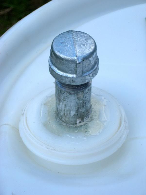

I wanted a method of venting the tank easily while still being able to add fuel without too much trouble. To handle that I got a 3/4" by 3" galvanized nipple and cap. I knocked out the center portion of the bung cap with the buttress threads (the course threads) and screwed the nipple in. I figured installing and removing the cap with the buttress threads would be easier and stand up better than the fine thread cap for taking the cap off and reinstalling multiple times. Before I put the nipple in I threaded the cap on as far as I could turn it by hand and marked it. Then I drilled 6 holes into the threaded part of the nipple just above the point where the cap screws all the way down to. That way to vent the tank I just unscrew the galvanized cap a couple turns to expose the holes and allow air in. After the nipple was threaded in place I mixed up some clear epoxy and filled the top of the bung cap locking the nipple in place. That way I can use the nipple as a handle that makes it easy to open and close the bung cap for adding more fuel. Here's a close up:

With the white plastic you will need to keep it stored out of sunlight to keep the plastic from deteriorating from UV light exposure. You might keep your eye out for a blue or black drum if you have to store it outside.

I just bought two plastic 55 gallon barrels. Only one bung each barrel with some type of cap on the other outlet. I want to set up one barrel with the pump...the other barrel used to fetch diesel then I'll transfer to the one with the pump.
I'm finding the bung has very course threads. It does has a recess in the middle of the bung that can be knock out...looks like NPT thread probably 3/4 inch. Trying to figure out what will fit in these bungs given the course threads.
Anyone with ideas?

The course threads are Buttress threads. I learned that online! After I found that out I looked at the cap and it even says Buttress. I also found out that there are adaptors available that thread into the course threaded bung and convert it to fine thread - NPT.
McMaster Carr carries all those adapters. McMaster-Carr
   / New fuel storage/dispensor #9
Ahhh googling buttress to npt. ..and that will work. Wish they wasn't $9+ though. Be more than the barrels in short order.
