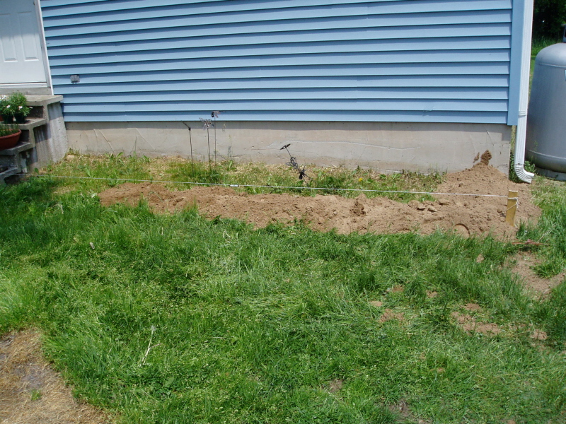

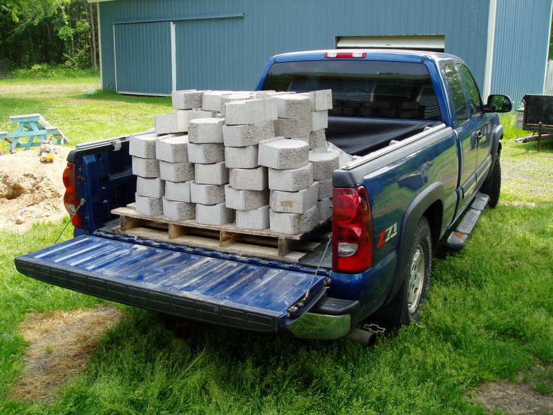

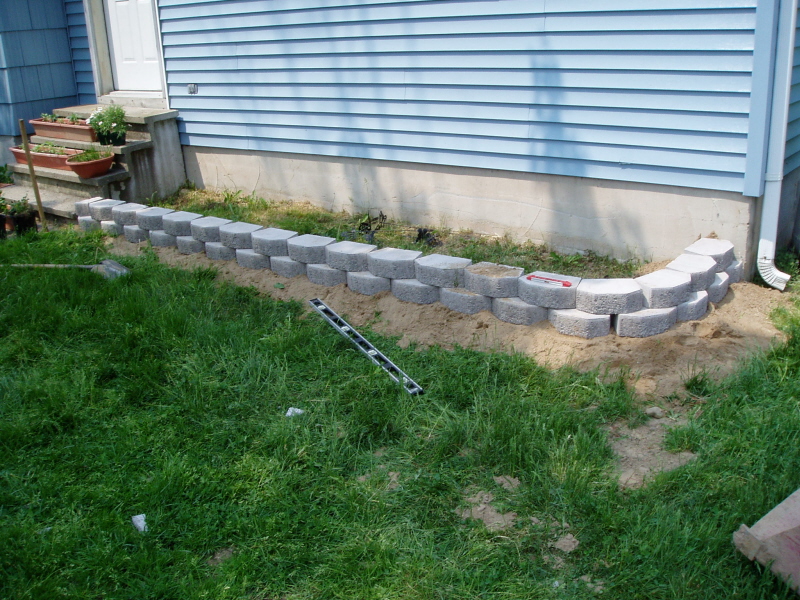

We are starting some new flower gardens at the new house. I leveled up the ground with sand and we set three rows of blocks from the local big-box store. My wife duplicated the process around the corner on the next wall too. We only had enough stone on the partial skid I bought to get two rows there. The next step will be procuring enough top soil for both. I figure almost two yards just for the larger one. The pics are of the larger flower bed.

That looks nice.:D
Will you build up with dirt on the outside to cover the sand and protect it from washing away?
Just a personal experience note on hauling blocks in a P/U : if not secured the pallets can slide forward upon heavy braking. This may bend the front of the box and back of the cab as well as breaking the window.:D

Yes, we were thinking the same thing about the sand wasing away. We will get emough topsoil to grade in front of the wall when we fill the beds up.
I find that almost nothing can slide of the 1/2" rubber mat I have in the truckbed. That being said, I still drove slow and started braking early. I was also carefull on turns and not a single block shifted.

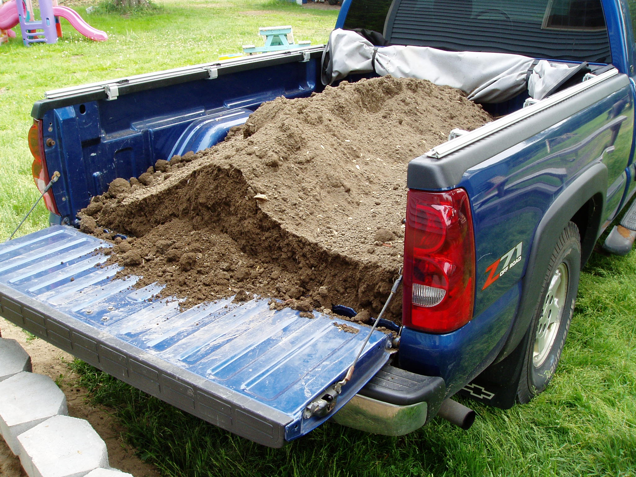

This pic is "two scoops" at the local small garden center. They sell it by the scoop with the loader of their old Massey tractor. This load was $27 and was about one yd. It did about 1/2 the first bed.

Most block manufacturers recommend that the first course of blocks be at least 1/3 below grade. Otherwise, they can be pushed out by frost, water etc.
I have done walls where the first course is completely below grade. It was 6-8" of base/foundation material, then the first course. That was for a 36" tall wall though.

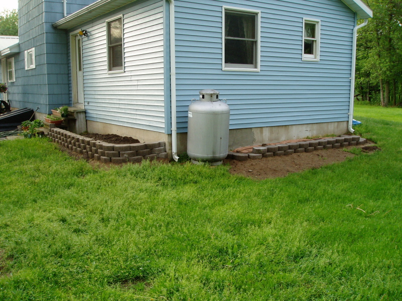

This is a view of both beds. Tomorrow my wife is going to get a couple loads of compost from the local dump for $5/load. It's free if you load it yourself, but for $5 it is worth having them do it with a payloader. The stuff needs to be sifted to get the sticks out, but I didn't see any food waste or anything in the load my friend got.
I don't think all of them will be a third below grade, but I'll bet 1/2 the bottom row is by time we are done.
