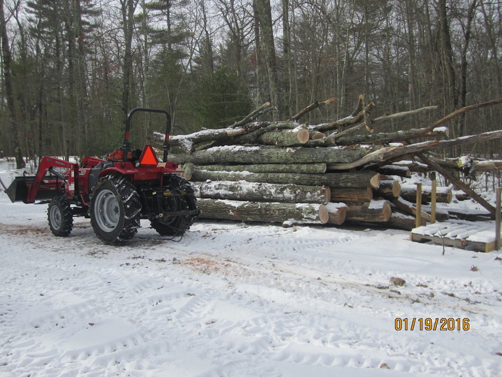

All the wood you see in this pic was cut with a Husky 50 Rancher with an 18" bar of 1985 vintage. Largest stem here (is buried and cannot be seen) is 26" but have cut 30-35 inchers with it in a pinch. Most wood here in the 14-18" range.
That being said, I do not think I would consider anything less than a 57-60cc saw for bucking and if having to get one saw, would do so in this range. Still , an 18" bar should more than suffice.
