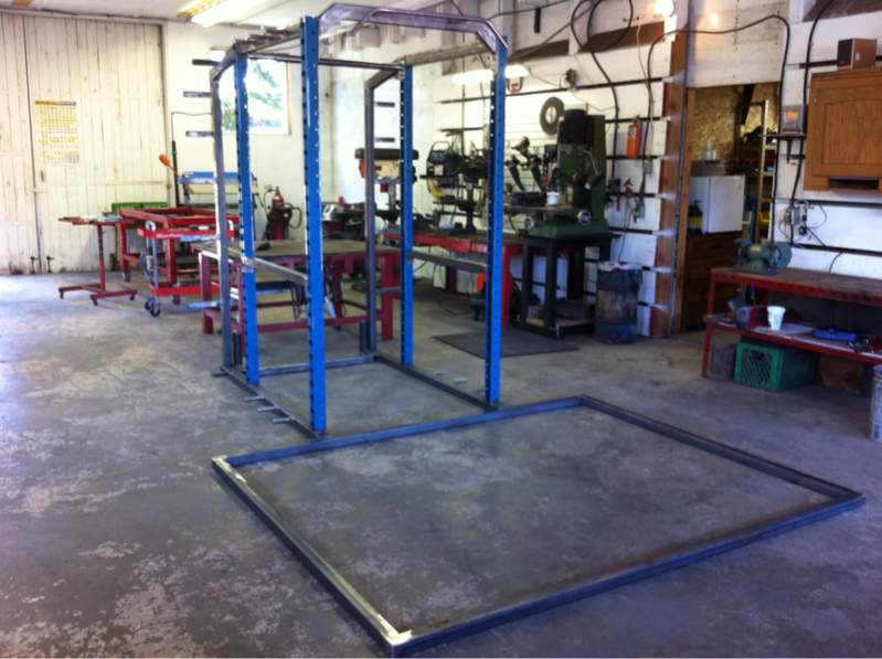

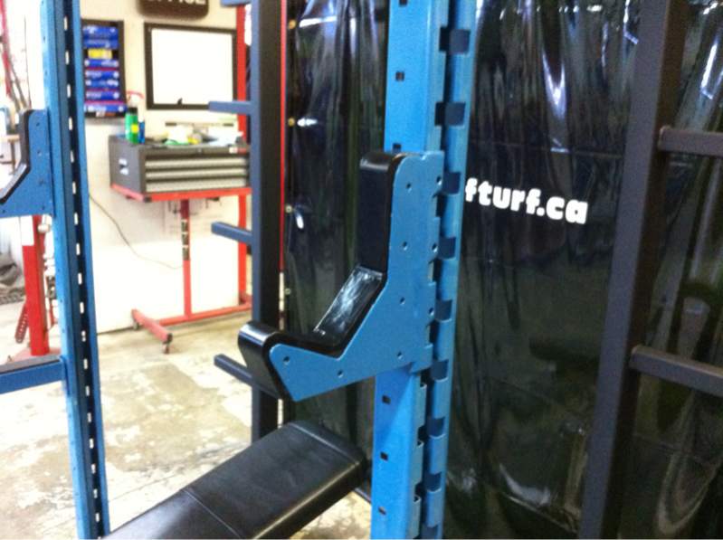

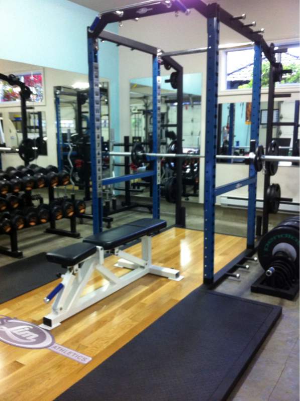

You should be able to find pallet racking easily from a local material handling or industrial shelving supplier. Although I had access to used material my dealer special ordered the posts individually for me from the factory. Two vertical posts are usually welded together with cross bracing to create the end frame for the pallet racks.
I figured it would be more cost efficient doing it that way than cutting and grinding. Plus I had the benefit of new factory paint, which although not powdercoated is relatively durable. I also purchased the frame brackets individually and welded them onto the ends of 2"sq tubing for the spotter bars. (And for the adjustable barbell "hooks")

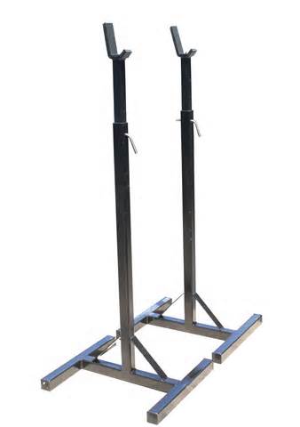

Those look nice, thanks for posting them. I am actually going to build a set of Squat stands similar to these. I need something more portable than the ones have now.

uhm.. wow on the weight room.. I can't be the only one thinking it.
