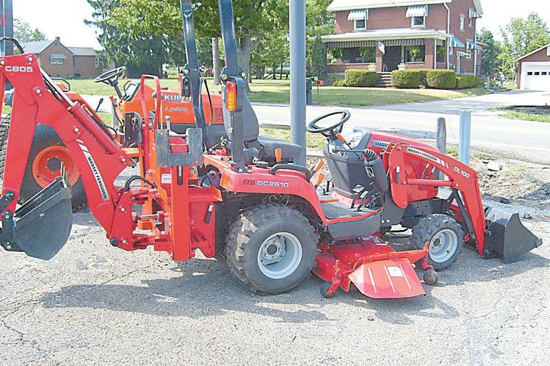

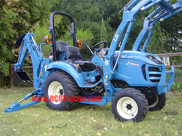

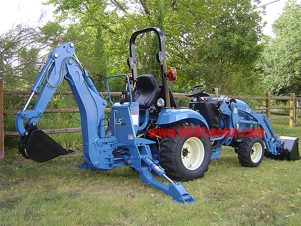

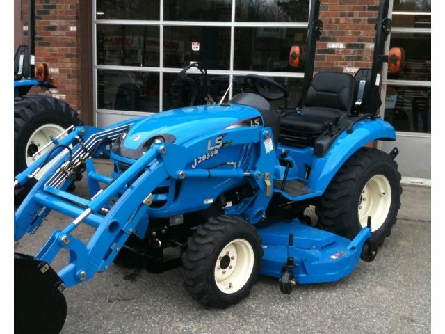

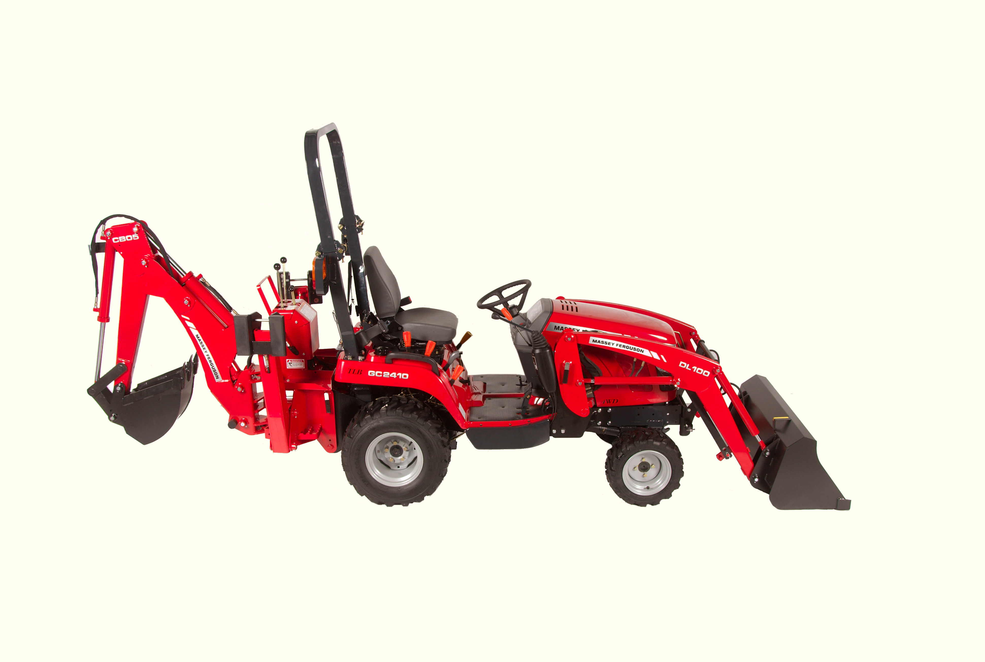

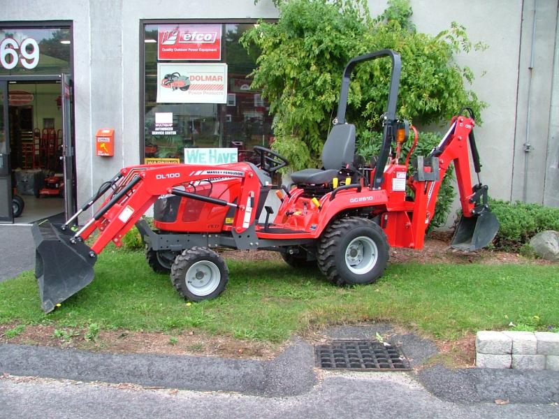

Pictures are not exactly plentiful, but I finally found a couple with the BH. If you save the photo to your computer and open it with "Picture Viewer", you can zoom in and get a good look at the bracket that must be removed to put the MMM on. The carriage from the BH slips into a slot in the bracket. There are some Massey GC2610 pics for comparison. I could not find any decent 1710 pics, but for the most part they are the same.
Please note in the RCO Tractor pics, you don't see the insane hydraulic hoses for the FEL sticking up in the air as depicted in the shot with the MMM. The current version has the hoses neatly tucked behind the loader arm, and the couplings are behind the loader arm also, out of sight and well protected. A bit of a pain to hook up and unhook, but I much prefer them to be set up this way rather then exposed. This is far superior to the NH Boomer Version.
I don't know what the hoses are hanging down in the RCO tractor pics running to the rear of the tractor. I have not seen these on the tractor I looked at from Paiges. There are no hoses hanging down. If they are there for the BH, I can't imagine this would be how the hoses are run for 2013. This will be another aspect I am looking for on my demonstration. I don't like the hoses hanging down at all, and would not think there is a good reason why they could not be routed better.

Hoses running from front to back and hanging down are just part of having a tractor with a "oh by the way, but a FEL on and a Back hoe. While some might be ran a little neater and tucked a little higher you are still going to have them. It seems the smaller the tractor, the more hoses you have to contend with. Everything except the short 3 foot or so of hose that allows the removal of the back hoe on my B26 is steel tubing till the cylinders and then only enough hose to allow cylinder movement. My P 7010 is much the same way except for about 4 -10 feet hoses that attach to the valve distribution box that is directly under the cab floor and on the side of the tractor very easy to get to and work on. The QA disconnects are there and then hoses run up to the top of the loader boom where they hook on to steel tubing lines for the rest of the routing.
Sometimes the steel tubing and close routing is not to your favor for maintenance though as I am finding out when trying to adjust my PRV on my B26. It easy enough to see if you have the tractor jacked up about 3 feet and laying directly underneath it but you just cant quite get a wrench on it even after removing the rear tire and a 4" wide diagonal brace where the sub-frame is cut to go around the rear axle.
