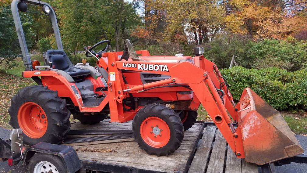

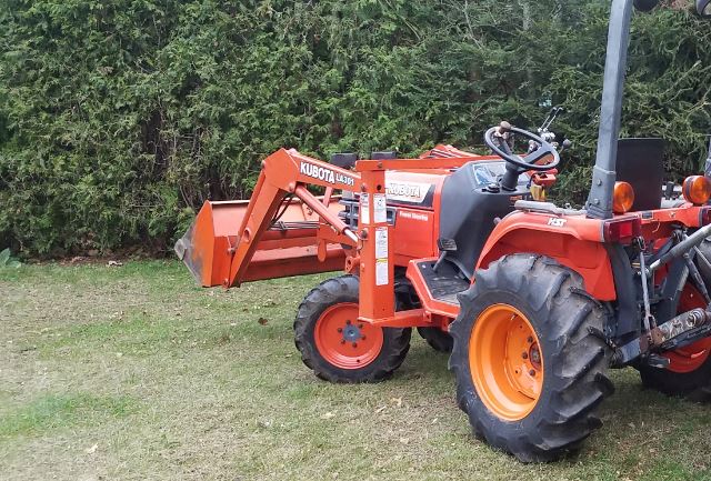

I have a 90's Kubota B1700 with AG tires and want to trade for a set of turfs.
Rears are in good shape, comes with new spare tube
Fronts are brand new (less than 5 hours)

I went from Ag to wider Turfs on several compact tractors. It always required new wheels as well as some careful figuring to stay with the same front-to-rear tire rolling circumference ratio. Staying with the same ratio is necessary to protect the 4wd mechanicals from broken drive/tranny shafts.
Some of the early compact literature had photos showing tractors fitted with an optional turf tire that fit on standard size Ag wheels. The tires shown always have a distinctive diamond shaped tread pattern. I never did see a compact with those tires mounted; most people looking for turfs want the lower wider turf tire for stabiity as much as anything - and so they order the wider tires on the different rim. I looked, but never could find a source for those larger narrower turf tires with the diamond pattern. But they might be available. Anyone know?

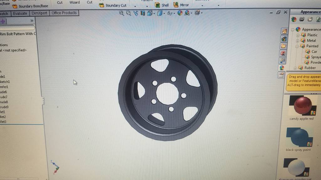

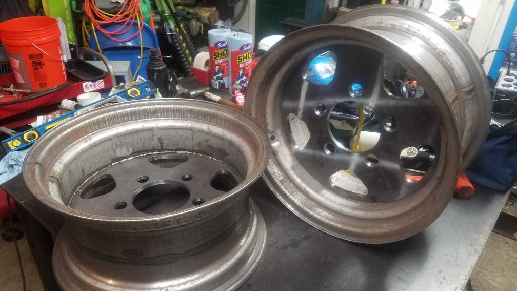

In the end I'm probably going to endup making rims. I know that seems like an overly aggressive plan, but I have some experience with rim building.

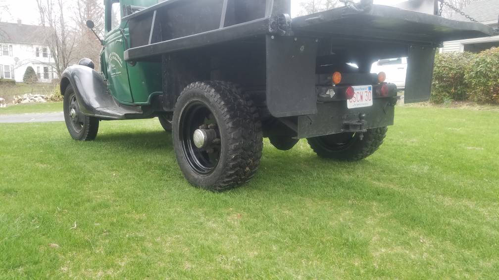

I made a custom set of super singles for my 36 Ford dump truck. (Long story short, it was to side step some local tax and commercial registration laws for dually vehicles)20181217_201954.jpeg20190414_202111.jpeg20190419_182146.jpeg20190419_182154.jpeg
   / New England - Kubota B1700 Ag Tires Trade For Turfs?
Currently my plan is to figure out what OD / rolling circumstance is for existing tires. Verify that to the short list of tires in the owners manual. Then go tire shopping looking for the same OD's
Once I find the tires I want I'll work backwards finding rim diameter and width. You can purchase wheel hoops (blanks) online. After that it's a trip the steel yard and a day in the shop to cut the centers out.
