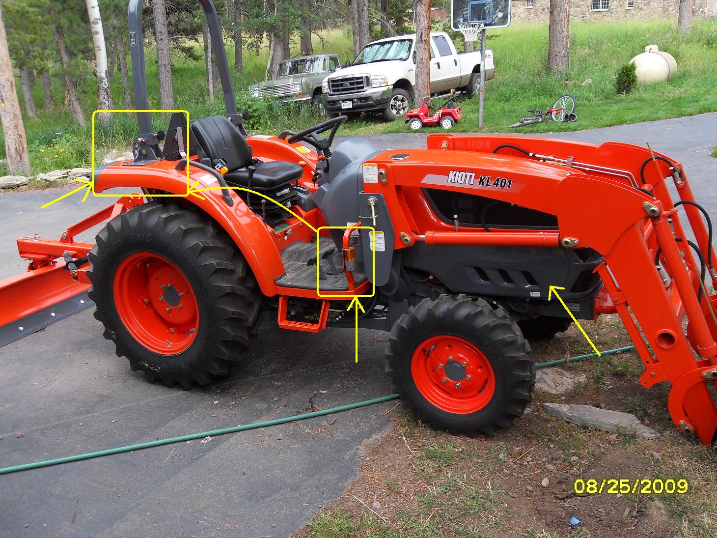

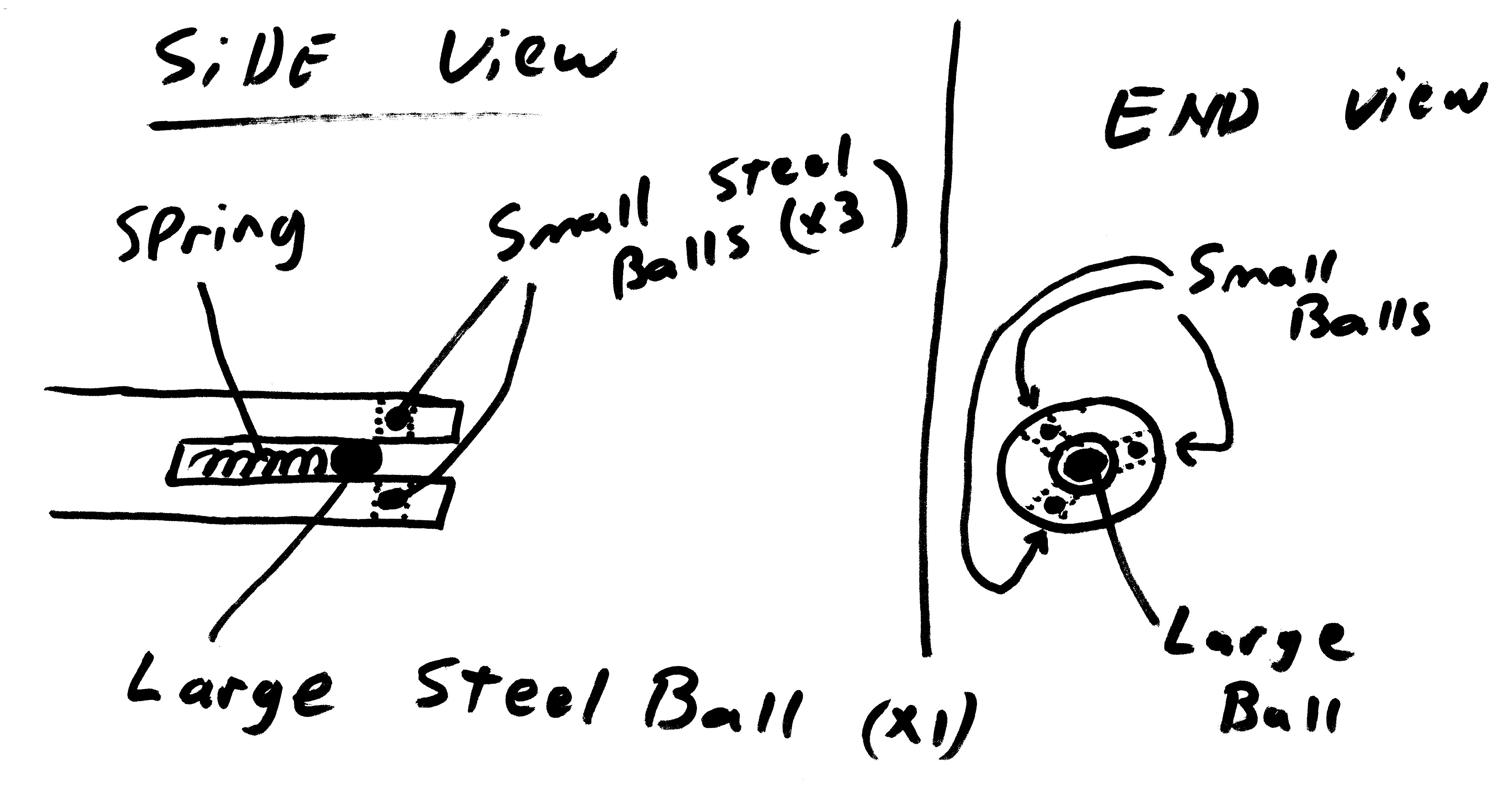

What's involved in removing the detent balls? Been hating that detent for about 140 hrs now.
Hey Tulenutn,
It's pretty easy to take them out, I wish I would have taken pictures..
I just removed the 8 or 9 gold bolts that hold the seat cover on. The seat is HEAVY so I just lifted the front edge up (like hood on a car) and used a ratchet strap attached to the ROPS to keep it held up. Then on the starboard side of the tractor you will see the valve (you can jiggle the remote lever and see exactly where it goes). I just used a crescent wrench to loosen the larger jam nut and then easily spin off the cover.
There are 4 steel balls (one larger and three smaller) with a spring behind the larger ball. After you spin the cover off remove the small ball's with a magnet, then used magnet to pull larger ball out of the center hole.. then Use a clean drywall screw to pull the spring out of the center hole. Spin the valve cover back on and tighten the jam nut. In my case the Jam nut was painted to the cover so well that I did not have to worry about any adjustments in the cover. Put the seat back down and replace the gold bolts and you are good to go. Longest step was getting the strap on to hold the seat up... took about 20 min's start to finish.
