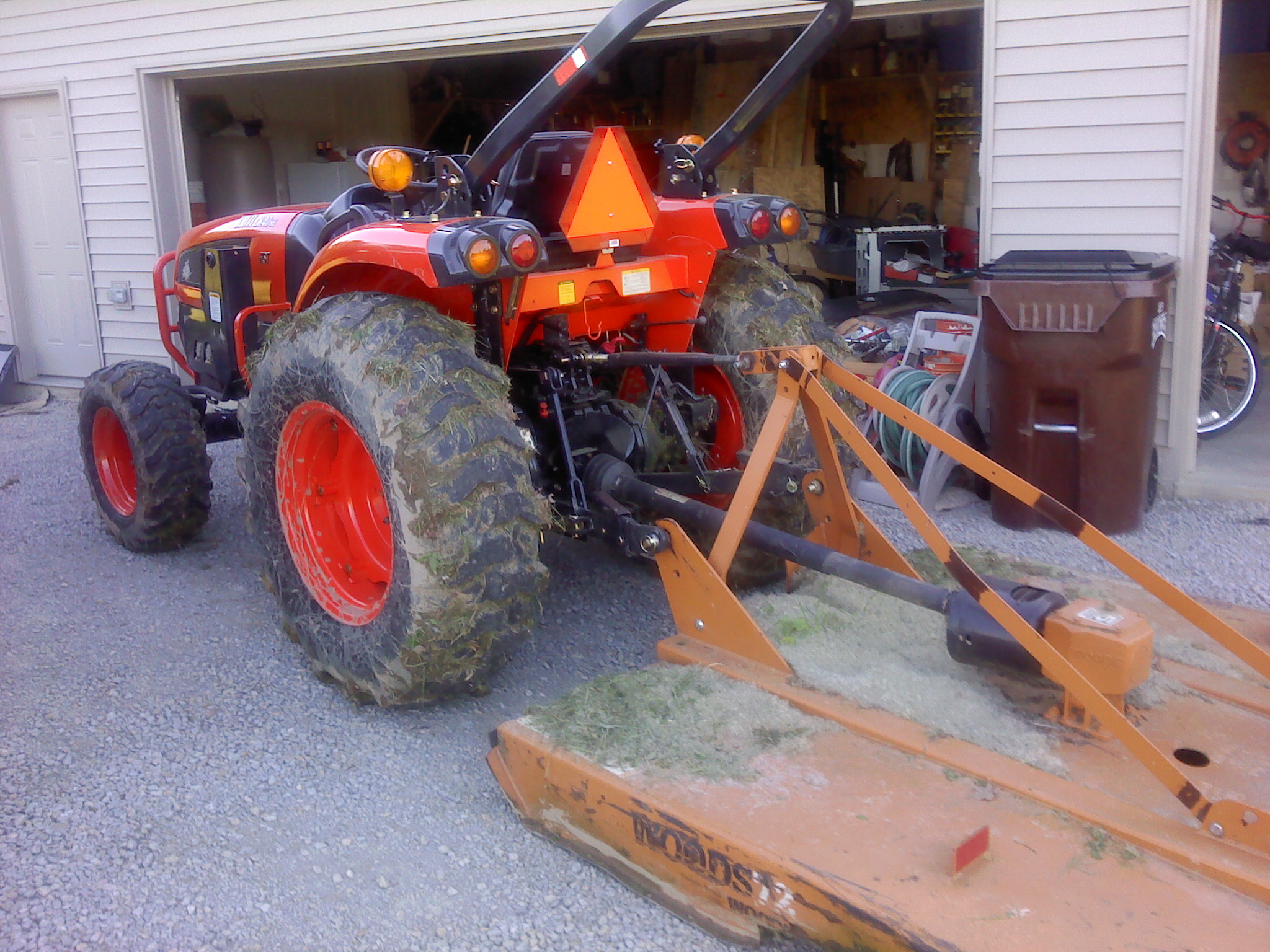

Now for the "dirty pictures" as promised!!! :laughing:
Put 7 hours on it mowing over the next 2 days...just using the BB72 right now. Waiting to get a finish mower! Some of the pics are better than others as my daughter took some thru/out a window.....
Gone thru my first tank of diesel...about 8 hours of use. Put the FEL back on and did some cleanup of the burn pile and used the chain & hooks to drag a tree and branches to my wood pile area for cutting. I smiled when I was done b/c believe it or not....I felt guilty! Why? IT WAS SO EASY!!!!! So much easier than doing it all by hand like we had up until now!!!!
Day after the tree/branches work, spent 1.5 hrs with my oldest boy teaching him how to work the FEL and how to "feather" the bucket. He enjoyed it immensly.....me too!;) (Good bonding time!!)
What type/kind of lights would you all recommend for front/rear? I saw some "driving lights" as WalMart.....I'd be curious to hear and/or see what you all have done in this area????
Thanks to all!!!!

Great pics, what a nice looking tractor.
Just a word of caution about picture posting here on TBN, if you show any with your ROPS down while working you will have the Safety Patrol after you like a swarm of mad hornets.;)
   / New DK40SE HST - FINALLY!!!!!!!!!! #15
Ditto on the ROPS. You just need a new garage/barn.:cool:
I don't bother taking my FEL off for mowing tasks. Of course it does obstruct the view somewhat but I am always finding rocks or branches along the way that I can deal with immediately using the grapple or bucket rather than having to mow around. Your fields look wide open and perhaps you don't grow rocks like we do in New England.
   / New DK40SE HST - FINALLY!!!!!!!!!! #16
Nice looking tractor I love my DK40se. I have the same problem with the ROPS and have to tilt it down to get it in the garage, some day there will be a new garage with a 10foot door. I agree with island no need to remove the loader, I keep mine on it is handy to put the line trimmer in and other hand tools, enjoy the new toy.
