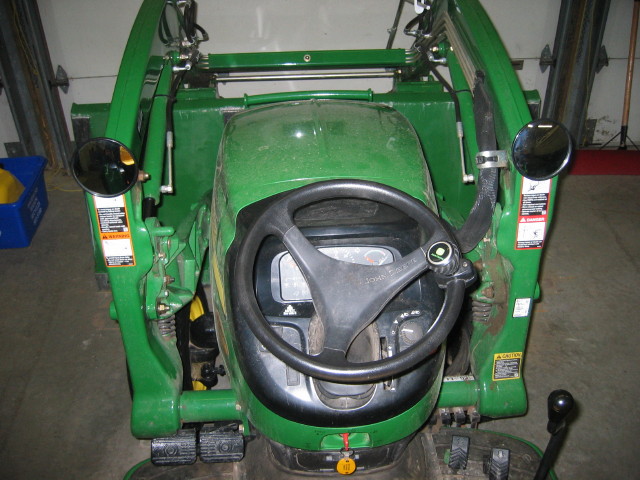

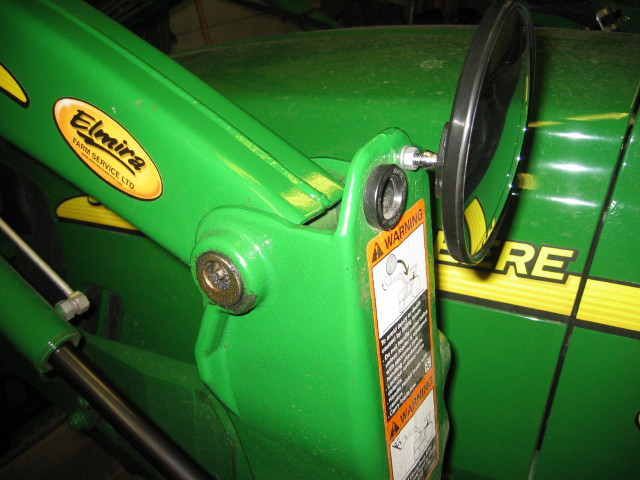

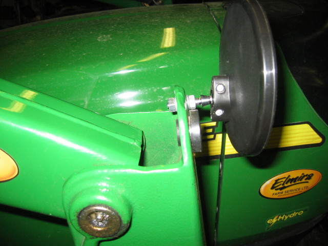

Congratulations on your new machine. Setting the wheels / tires to the wide position will give better stability.
The smaller of the two holes in the top of the loader mast is a good place to mount a couple of convex rear view mirrors. A little piece of 3/8" ID clear plastic tube makes a good spacer to fill the hole and depending on the mirrors may be the perfect size for the mirror mounting stud.

Thanks for the good idea re: mirrors
