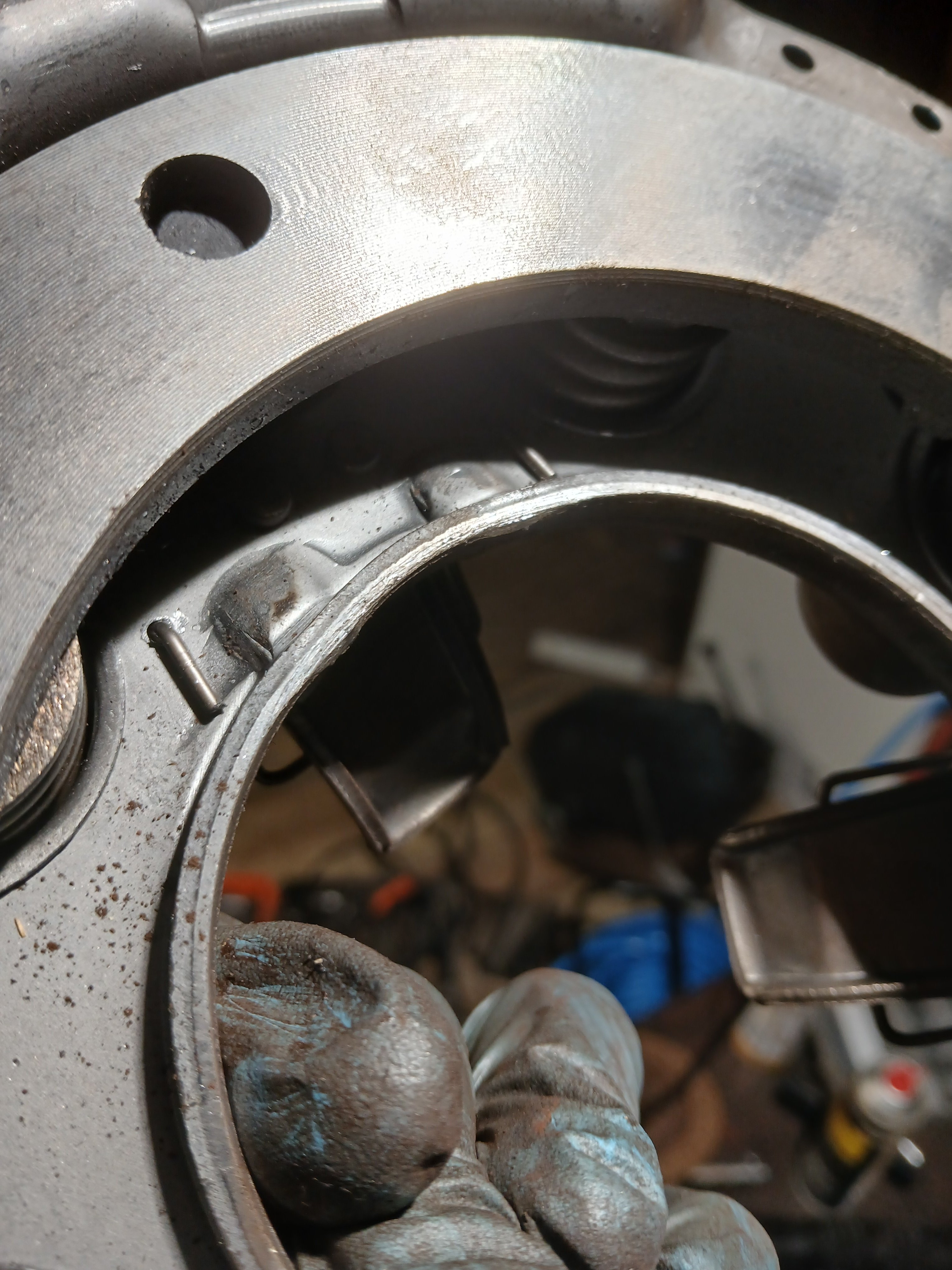

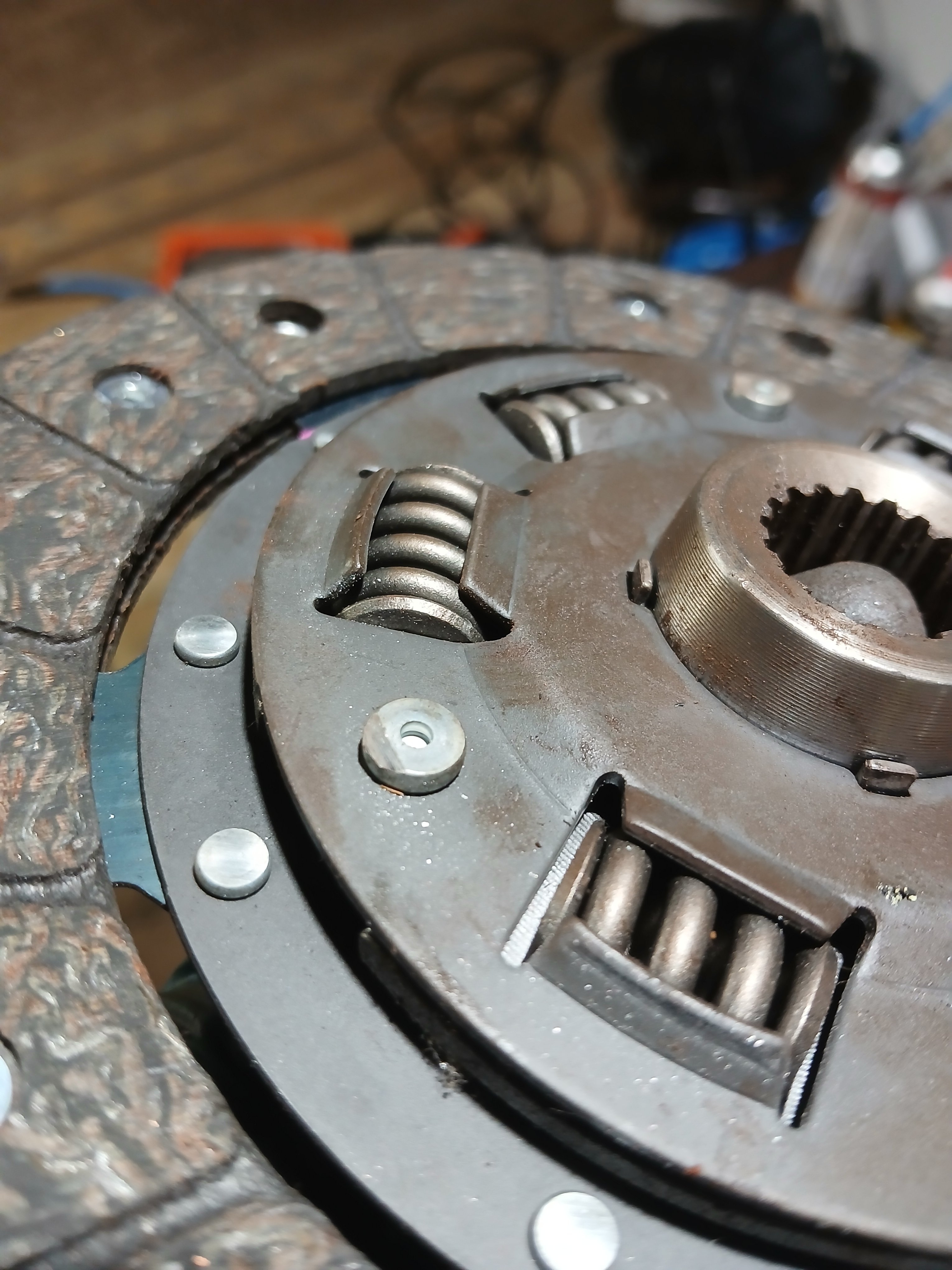

So i have tried to change the clutch on my iseki tx 1300.
And when i put everything back together the clutch will not completly disengage. I can turn the wheels barely with the clutch pedal pressed down and in a high gear.
Tok everything apart and noticed that the pins on the clutch had been grinding on the pressure plate.
What is going on here?
New clutch i bought is from here: Clutch Kit Iseki TX series | TX1210 - TX2160F | Bolens G152 - G154 | G172 - G174 | Shop4Trac
And the clutch plate will only fit 1 way, so its not installed backwards.

Compare the new parts to the old parts to see if there is something different in the manufacture.
