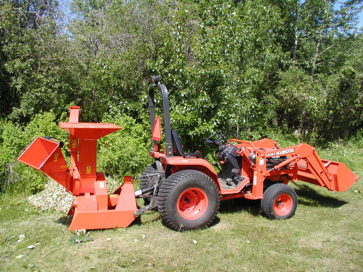

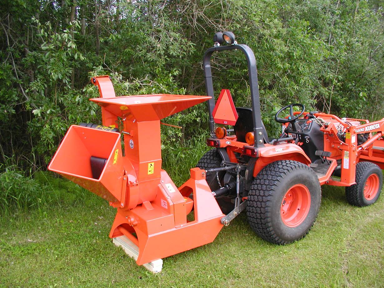

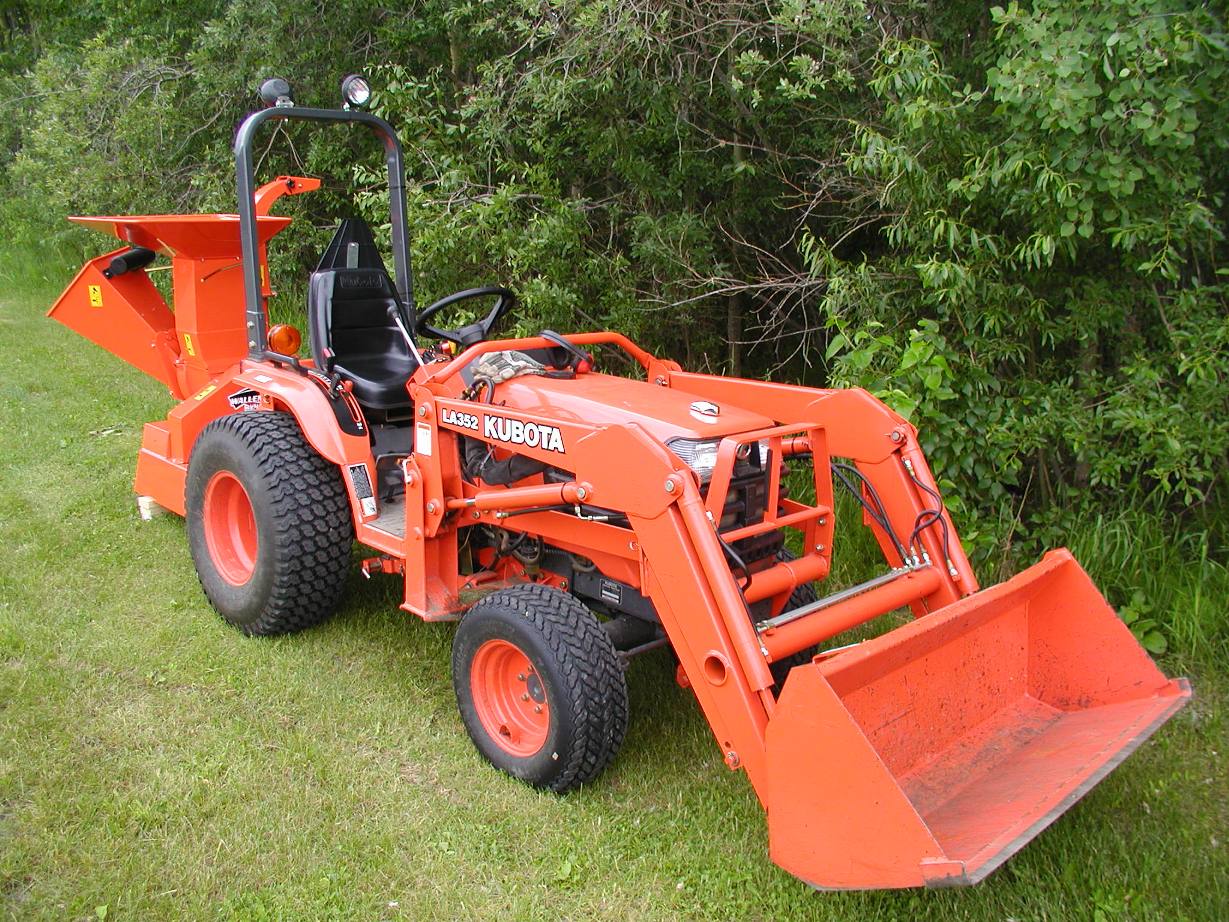

I've been thinking about getting a chipper or chipper/shredder for a number of years. Been keeping up with the various posts on here, and eyeing them every year at our local Farm and Ranch show. This year the black poplar fluff put me over the edge. I decided it was time to pick one up and start taking down trees.
I had already decided I would be getting a Wallenstein, and after some more reading on here I opted to order a BXM32 (3" chipper/shredder combo). I had to order it, because I wanted it in Kubota orange....guess color matters :laughing: Took a few weeks to get it in. They loaded it on the pallet into the back of my pickup and I don't own forks, so I wasn't too sure how I was going to get it out. Ended up resting one end of the pallet in my FEL bucket and slowly pulling it down a trifold ATV ramp to the ground. Worked pretty well.
After attaching the chipper to the 3PH and measuring the distance between PTO grooves, I was pleased to see that I would not have to cut the PTO shaft they included. It is shearpin protected, and after greasing it up I attached it and was all set. I played with the 3PH height a bit to see what angle keeps the chipper at a usable height while keeping the PTO shaft at as slight an angle as possible. I will have to bolt on some permanent lumber on the bottom of the skids, but to get using it, I opted for a few short lengths of 2x4.
The chipper itself was already greased up, so after taking the time to read the owners manual (yes, I'm one of those :ashamed:), I grabbed chainsaw, hearing protection and gloves to give it a test run.
Here are a few pictures before I started.

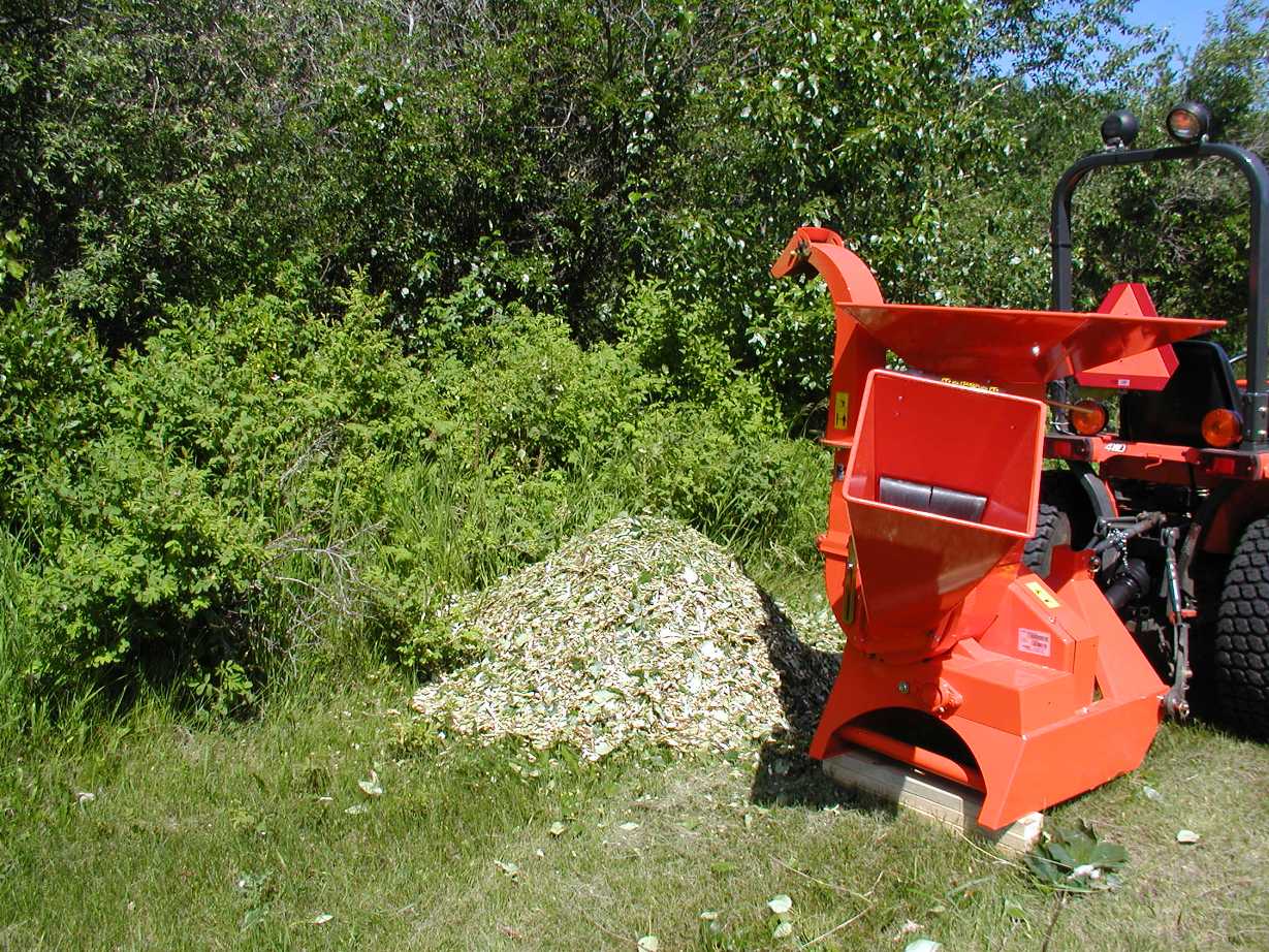

You can see I had a tree leaning over that needed to be cleaned up, so it was my "tester". Chipper performed like a champ! I just blew the chips into the bush with the deflector on the shoot at its highest.

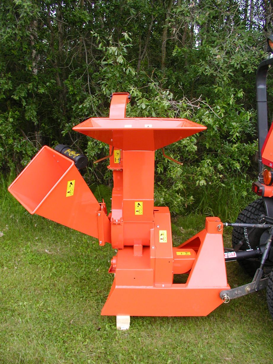

Then I moved the tractor to my first clump of black poplar and started going. The chipper had no problem with any wood I could get to the blades. The shredder is very agressive and pulls in branches at an almost alarming rate :eek: It never came close to bogging down my B2410. I also chipped some old dry willow tree, and it sliced it up no problem. A few more pics with the chip pile.
I am very impressed with the quality of the machine. Very simple, and very well put together. Only a couple of items to note. I know it is a 3" chipper and I intentionally did not get the 4" (it is a LOT bigger implement and quite a bit more $), so I will have to make sure the wood going in is trimmed a bit more than would be nice (bit of a compromise). I will certainly have to put on some wood under the skids. The default angle for the PTO shaft if you put in flat on the ground is too severe.

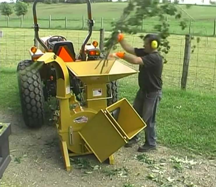

I really don't mean to steal this thread, because I really appreciate Knight9's review.
This is what I meant regarding using 2 hands to put small limbs into the shredder. It looks like this is easily done, however this is a screenshot from video posted by Wallenstein in 2008, and it is a BXM42. Is this easily done with a new BXM32? It also looks like the guy kinda throws the limbs down and lets go quickly because the shredder "grabs" the limbs quickly. The video is from YouTube--do a search there on Wallenstein BXM--if you care.
Thanks, and sorry I was not very clear in my question,
Ron
/ New Chipper/Shredder - BXM32
#9
No problem with the question, and not stealing the thread at all! :)
Loose leaves, small branches and twigs can be set in the hopper and then you push the lever, and it will all fall down into the shredder. For branches like those in the picture you posted, you just have to push them down into the knives and they will get pulled down into the shredder...VERY QUICKLY! You do have to let go quickly as they disappear in a second. I've put branches up to the inch diameter into the shredder and several branches at a time of smaller dimentions.
Hope that helps.
