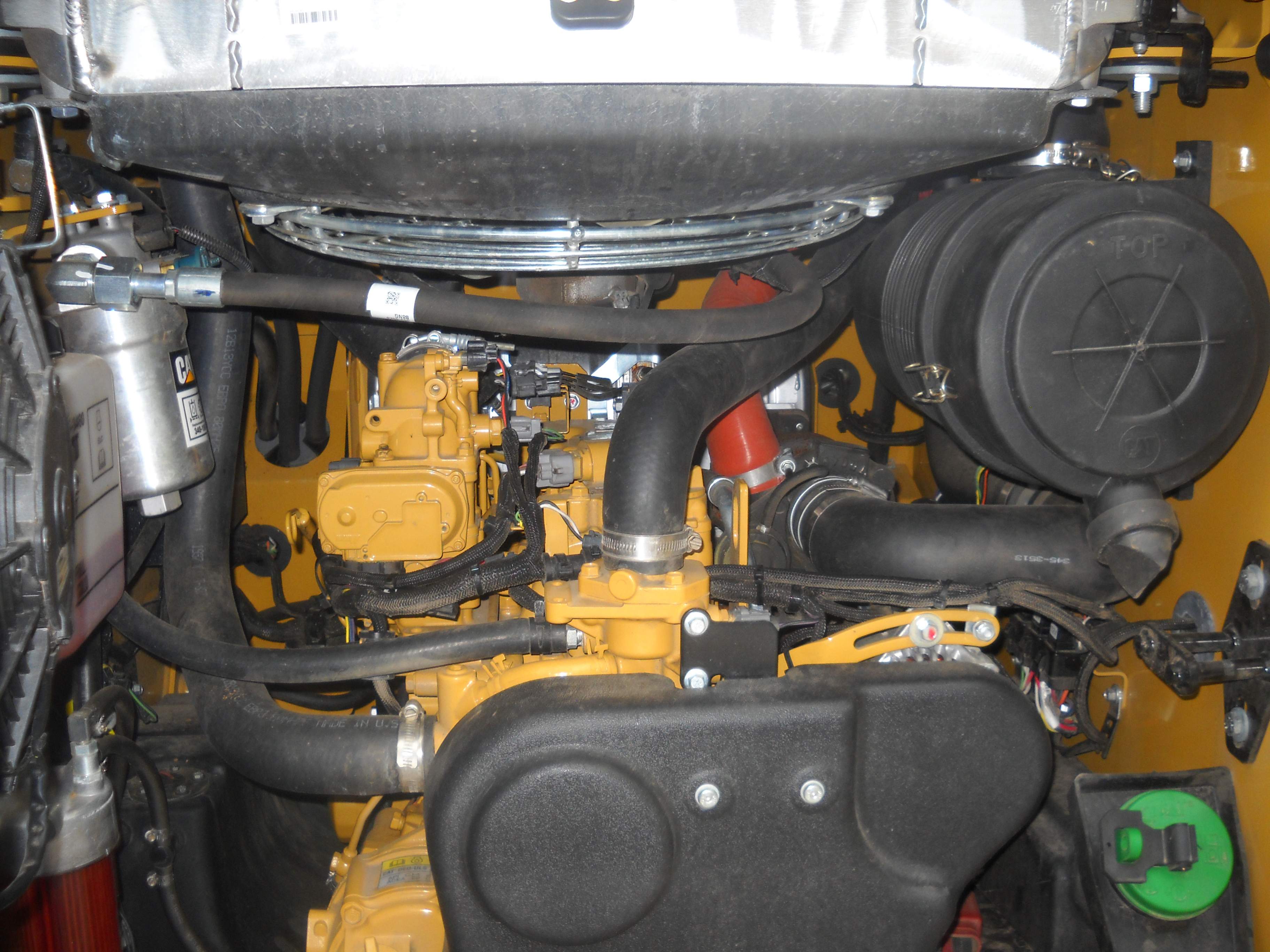

Timberwolf, first three engine compartment, fourth hydraulic tank fill area. Another thing I forgot to mention is the decelerator. When the engine speed control knob is turned all the way up your foot pedal becomes a decelerator. I forget it's there sometimes. I've been using it when I cross ditches, hook up attachments, pulling into the shed, and there's no more cable for the foot pedal it's electronic now.
Looks like the radiator/hydro cooler is stationary versus the C series where you could raise it up and also,I see they've relocated the muffler and exhaust. Looks pretty good from what I can tell.

Timberwolf, yes the radiator is stationery, the grating raises on the top now. the hydraulic filter is in the spot of the old muffler.

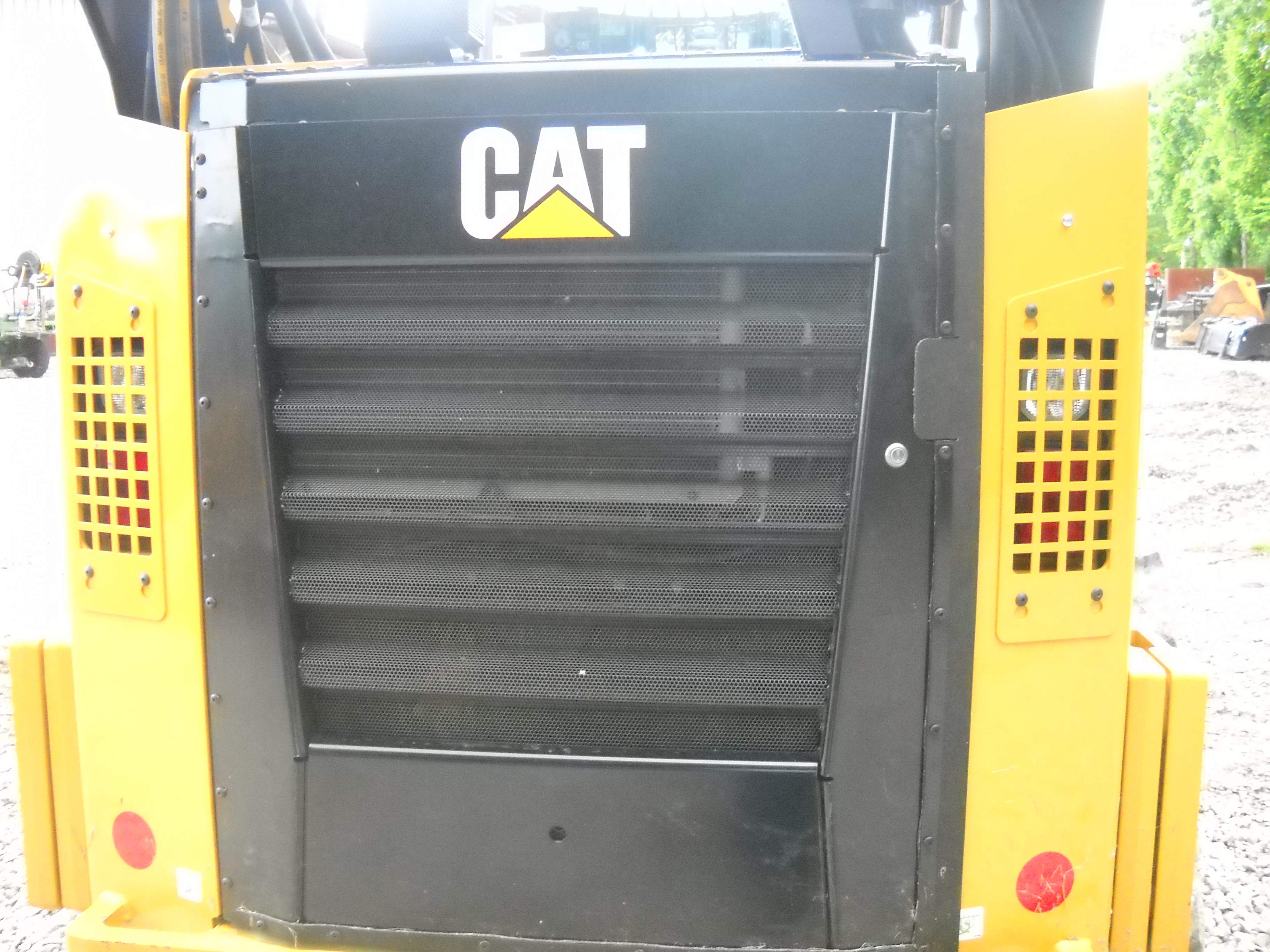

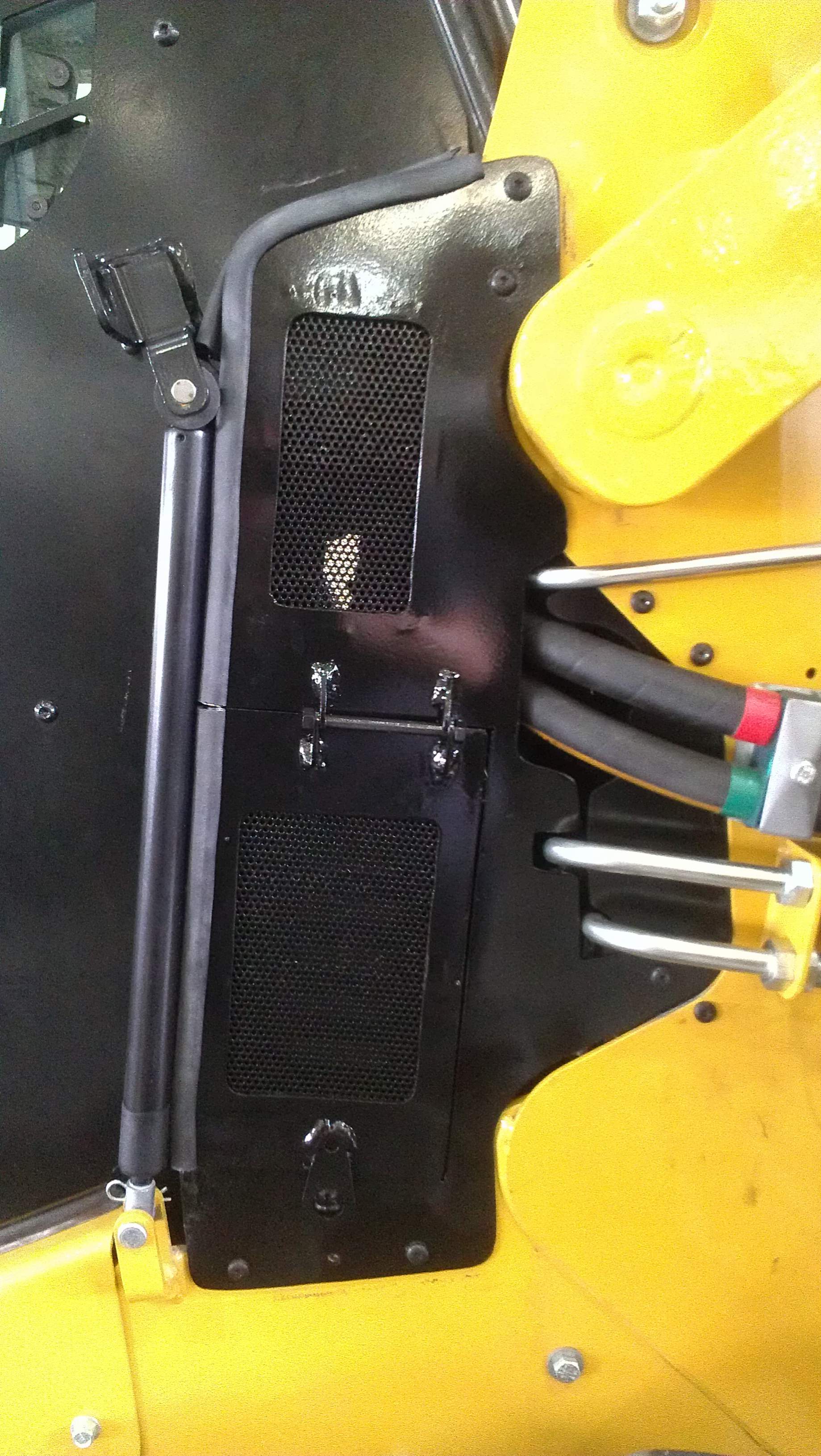

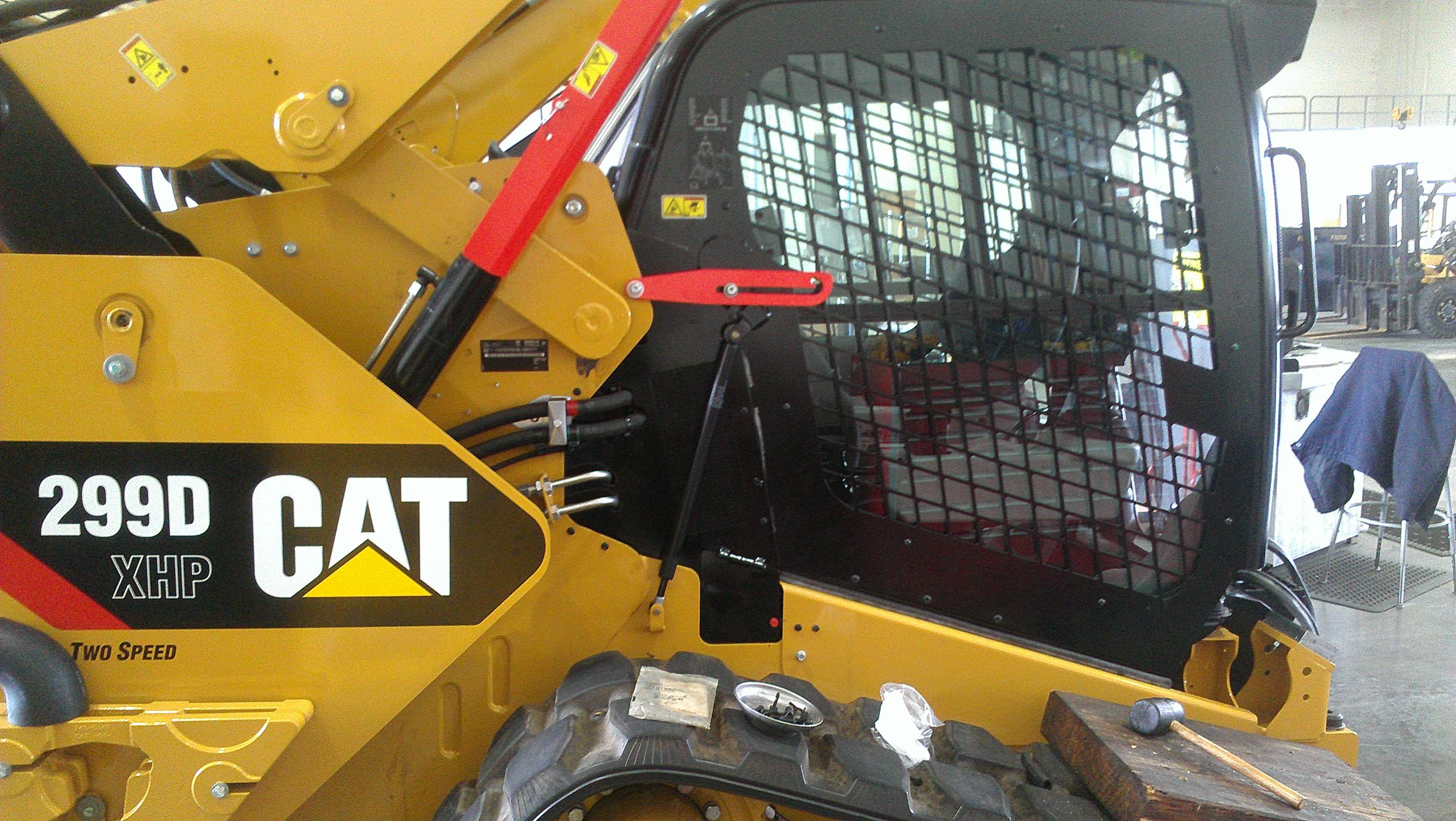

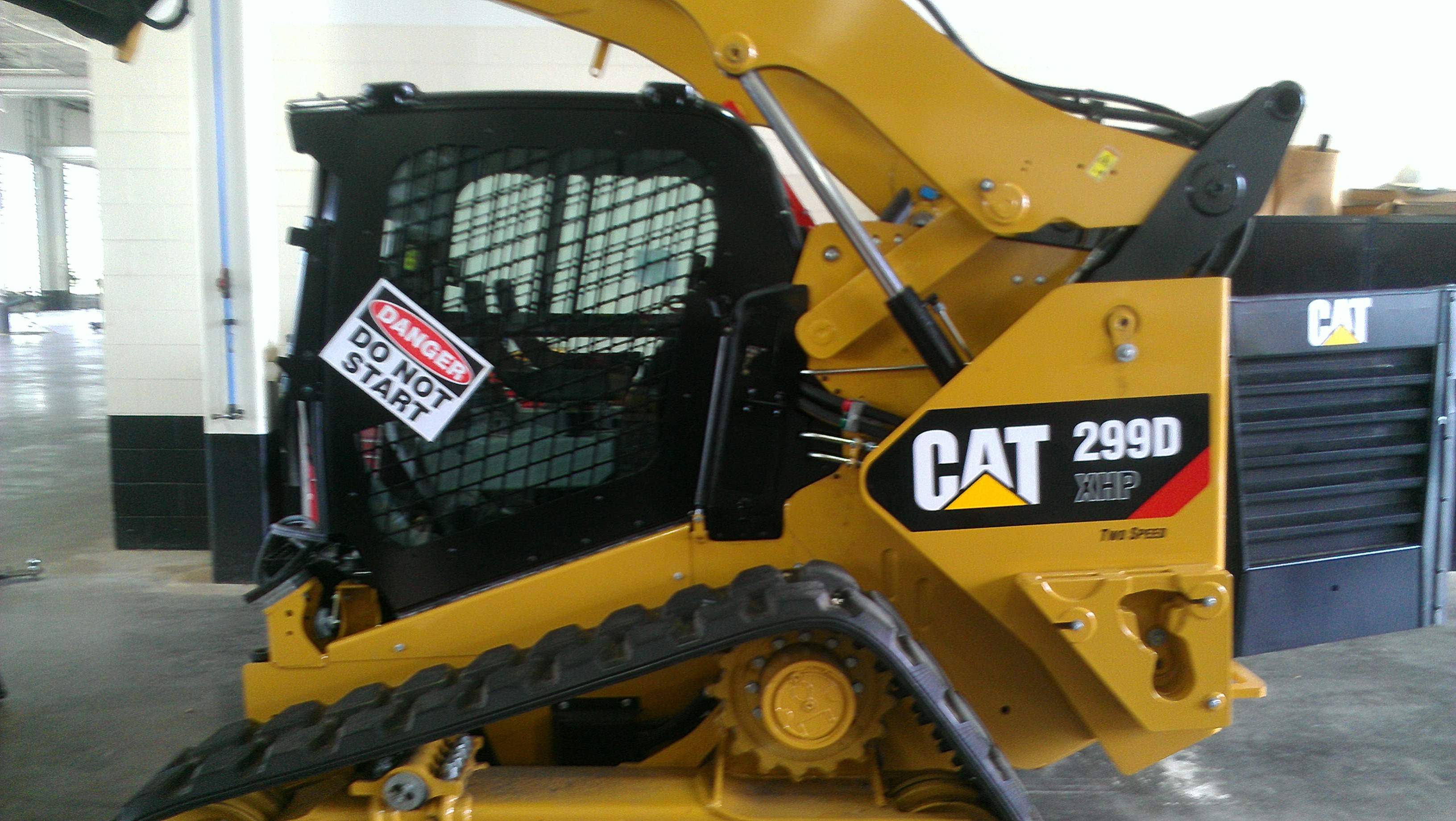

Working on a new 299D that a customer ordered.... like everyone knows the debris barrier kit is unavailable and no one knows when it will be available............ so i built one of my own design. it is still a work in progress but i got the side guards done today (that Cat has no interest in offering
for some reason) along with some of the door seals.... gona be doing a exhaust guard and also doing the intake with dust bowl but its gona be up behind the cab instead of over the radiator cores so you dont have to remove the bowl to lift the cover like the Cat kit does.

I'll have to say, That looks purty darn good ! Look forward to seeing how the air cleaner turns out.:thumbsup:
/ New Cat 299D XHP #39
me too!!!!!!
might clean them up a little bit more and burn a few sets out on the waterjet and sell. just wish i could cut the screen out on the water jet.

Looks good, nice fit
