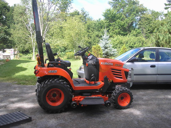

Well, after lurking for a while and researching whats' out there, I bought the BX24 and a bunch of toys to go with it. Thanks to everyone here - the numerous comments and discussions were invaluable in reassuring me as to the quality of this machine.
Everyone around here drives "big" blue tractors and I will certainly look at those when buying equipment for haying, but for putzing around the yard the orange one came out ahead in terms of backhoe and nearness of the dealer. Price-wise, this thing was expensive (in CAN$) - that may be a function of the smaller market here and my desire to not cut the grass again with my electric lawn mower; so the deal was done with much serious barginning.
As a background, we are a city couple with two young pre-teen girls who have taken an interest in horses. We've also taken an interest in organic farming and are looking forward to the day of quiting our high-tech jobs and working on the land. We recently bought an older house on 120 acres just outside the city (ottawa region), so the BX will serve mostly for cutting the grass, digging drainage ditches (the land is a bit low and the water table a bit high), and clearing out the neglected brush. This fall/winter I hope to start a 10-box stable and finish it next year spring/summer to start collecting horses by the fall. Eventually I would like to start doing my own hay (a local beef farmer gets about 250 4-foot bales per year from this land now).

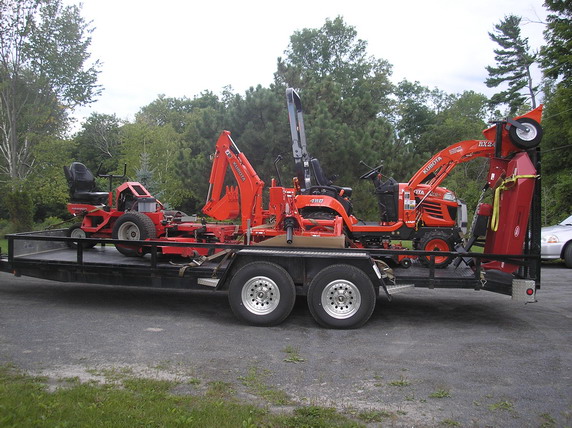

I took delivery on Friday and got a very quick demo. The delivery included the BX with mower, Kubota tiller, 48" rotory cutter, and a greenline PHD with 9" auger. Again, a hearty thanks to folks here for educating me on these things - I don't even service my own cars but with the knowledge I found here I think I can handle the 50 hour service when it comes up. (I do service my own mountain bikes so maybe that might come in handy).
I spent Friday night reading the manuels and Saturday I did a bit of work. I have some questions and observations that I'll leave to the end...What I did Saturday:

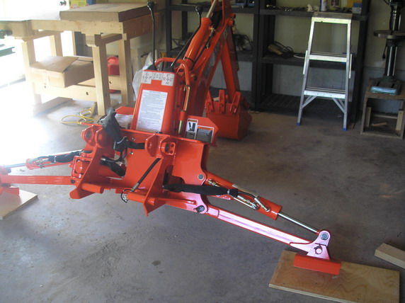

- removed the backhoe (scary).

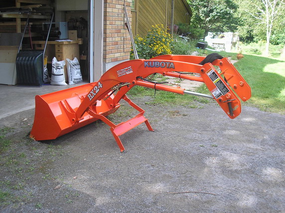

- removed the FEL (confusing).
- mowed the lawn!
- removed the mower.
- installed the 3PH (again, confusing).
- re-attached the FEL (easy).
- opened up a bottle of wine and relaxed...
My first gripes and comments:
- The install manuels are lacking a bit. I think descriptions of the 3PH, BH de-install, etc. could have been expanded quite a bit more with better photos and text with noone complaining. These BX units are sold mostly (I think) to yuppy-types like myself who have never been near the rear end of a tractor. A bit more babying would have been appreciated.
- The BX is a noisy and smellly bugger! I guess thats the nature of the diesel beast.
- Engaging the PTO gives a nice jolt to the tractor even at lowest trottle. A bit rough for someone used to driving Hondas...
- I've got a few slopes here and thanks to folks here (again) I knew enough to drive up backwards at times - scary.
- The manner in which the attachments are held on with removable pins is pretty neat. Those quick dettach hydrolics are pretty nifty too.
I included a few obligitory pictures - none of me nice the family was out at the time of delivery - thats the sales guy unloading it.

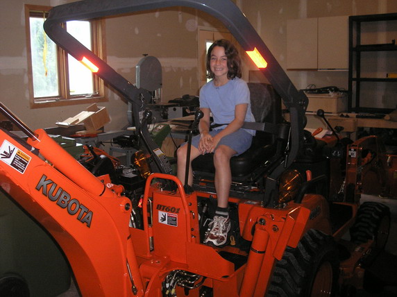

I love the last picture of the tractor with the mower but without either the backhoe or FEL. One of these days (after I turn an acre of trees into a lawn) my BX24 is going to look just like that!

Make sure you're also aware of the rollover possibilty from side-to-side! I noticed that your daughter has the seatbelt on with the ROPS down in that picture. Granted, the tractor's not going to roll over in the garage or anything, but make it a rule of thumb that ROPS up = seat belt on and ROPS down = seatbelt off. Ideally, have the ROPS up and the seatbelt on at every single possible time. These things can tip over! Try to keep a thread going in your mind that if it starts to fall, do not try to stop the fall with your hand. That won't work. :)

The ROPS goes down in order to get the tractor in the garage. Ido wear the belt when using outside.

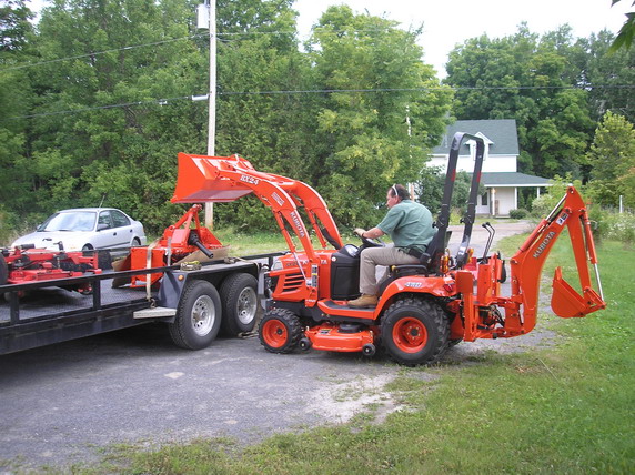

I love that last picture too with just the MMM.
Like the mother of all lawn tractors :D
Looks like you are going to have lots of work for it on 120 acres :D
Have fun and keep the roll bar up and seat belt on :D

Always lower the backhoe to the ground when removed. Then relieve pressure in the valve by moving levers around with engine off before disconnect. This will insure no built up hydraulic pressure in lines that can hinder reattachment of lines. This goes to loader as well. Hopefully you will not have a problem with reattachment. If you do, there is a way to relieve pressure. Cross that bridge when you get there.

Actually, you want to lower the main frame of the backhoe on something akin to a length of a 6"x6". Lowering it all the way to the ground puts alot of strain on the stabilizers and frame when it tries to pick itself back up. Main thing though is to not leave it suspended in the air relying on hydraulic pressure to support it.
The advice about working the FEL joystick is very good and correct, but the same is very BAD advice for the BH. The critical difference is where you're breaking the connection. With the FEL you're taking the load off of the cylinders with the bucket and parking stand and equalizing the pressure in the work circuits, then breaking the connection between the valves and the cylinders. With the BH you're breaking the main connection between the tractor and the valves. The BH has open-center spool valves, so the two connections you're disconnecting already have their pressure equalized because they're effectively the same circuit. Whatever pressure is in the work circuits (between valves and cylinders) isn't affected by the main circuit, and vice versa since the (closed) valves isolate them from each other.
So number one, it buys you nothing. More importantly, its dangerous. You just went to all the trouble to position the BH for storage. Now if you start yanking joysticks with the engine off, you're going to unload the cylinders that are propping it up - possibly quite suddenly - which may cause it to tip over. And one thing you really don't want to do is work the sticks after you've disconnected the BH. That will transfer pressure from the cylinders to the main circuit you disconnected. So whereas you started out with zero pressure behind your quick-disconnects, now you've inherited the very problem you wanted to avoid in the first place. Yet another reason for propping the BH up on a block and taking all load off the cylinders; you wind up with the same problem when the cylinders bleed down back through the valves and the pressure ends up at your QD's.
I actually do support the removed backhoe with a wood block, but I have removed it without one and have had no problem with reattachment. The stabilizers lift the whole tractor off the ground. How could they strain just lifting the BH?

I actually do support the removed backhoe with a wood block, but I have removed it without one and have had no problem with reattachment. The stabilizers lift the whole tractor off the ground. How could they strain just lifting the BH? Think of the geometry involved. The stabilizer cylinder piston exerts force along the rod to the knuckle on the stabilizer foot. If the BH is sitting on the floor with the stabilizers spread flat out, when you go to lift it almost all of the force is being applied horizontally as tension to the stabilizer legs instead of working to lift the BH; it would pull the legs and feet right out of their sockets if it could. {Imagine you or I doing a split (as if I could) and then trying to pull our legs together to stand up without bending our knees - 'cause the BH doesn't have knees}. Now compare that to when the stabilizers are at a downward angle as you're trying to lift the tractor. Most of the force is now being applied vertically, as compression between the foot and the BH frame. {Now imagine you or I standing with our feet spread just a few feet apart and then pulling them together without bending our knees - easier, right?}
Not saying it won't lift it from a 'split', it's just a bit more stressful on the joints. My Woods BH manual actually instructs you to put it on a block, presumably for this reason.
I actually want all load off the cylinders for the simple fact that I have a 9 year old boy that can't keep his hands off anything and I don'y want those cylinders supporting any weight. I want that BH fully rested with no load on the cylinders so if junior pulls a handle, which he will, it won't flop over, which the OP's BH would land on Juniors foot, or worse.
Unfortunately you can't take all the load off the boom cylinder unless you support it also (i.e., with a hoist/sling from above). Specifically one thing I was referring to was if you were to yank the boom handle toward "raise" with the BH connected, it will suddenly come up and the BH will tip backwards. If you re-read/think about what I posted, you'll see that this is a danger when the BH is still connected to the tractor. Once you pop the QD's, Junior can jerk the handles all he wants and very little will happen because the fluid that's trapped in the BH circuits has nowhere to go (unless something were to rupture). What it will do is put pressure on the QD's making it real fun for you to connect them next time. You don't have to take my word for it; try these things (carefully), and you'll see for yourself.
OH, and you also want to curl the bucket completely to take the load off the bucket cylinder (which it looks like the OP did).
As for your input concerning the fact the valve is removed with the BH so the is no pressure issue as with the FEL. I am sure you are correct, but cannot comment due to lack of knowledge. All I know is what I do works and is an attempt to be as safe as possible. "As safe as possible" is exactly why I'm telling you guys all of this :)
Hate to intrude into a perfectly good debate but I feel oblidged to another 0.02 here.
According to the owners manual supplied by Kubota for the BX23, proper stowage of a dismounted BH is to fully lower the outriggers which inturn lowers the entire BH assembly to the ground. This provides for the most stability of the dismounted BH. Theres no mention of any undue stress in raising the BH up to mount it.

Course I dismount my BH onto a dollie and use a bungee cord to keep the fully raised stabilizers in the up position. For me this minimizes the stowage "footprint" and makes it easier for me to manuver it around the shop. This runs counter to Kubota's recommendation but it works for me :D
/ New BX24 #19
I would presume that your manual tells you this for more of a stability / not putting your hoe down in the rocks or cement than for damage to the outriggers. The forces applied to the riggers in any angle is far far greater than the weight of the hoe. Heck, think of how much they move / drag around when digging. That latteral pressure far exceeds the weight of the hoe. I think your logic as to why to put the hoe up on a block is flawed, but that is just my persumption.
:p
-d
Great discussion guys -
My BX24 manual advises to move the control levers to relieve pressure, so I did this with no ill effect. However, in trying to be complete, I also jiggled the stabilizer levers, which caused the whole unit to move (so I stopped real quick). If this is normal, then the manual is not clear - I can see people getting hurt doing this.
I've got the outrigger pads on some plywood to protect the cement floor. Didn't think of the blocks under the main unit -good idea.
Building the dolly will have to wait until I'm more organized in the shop.
