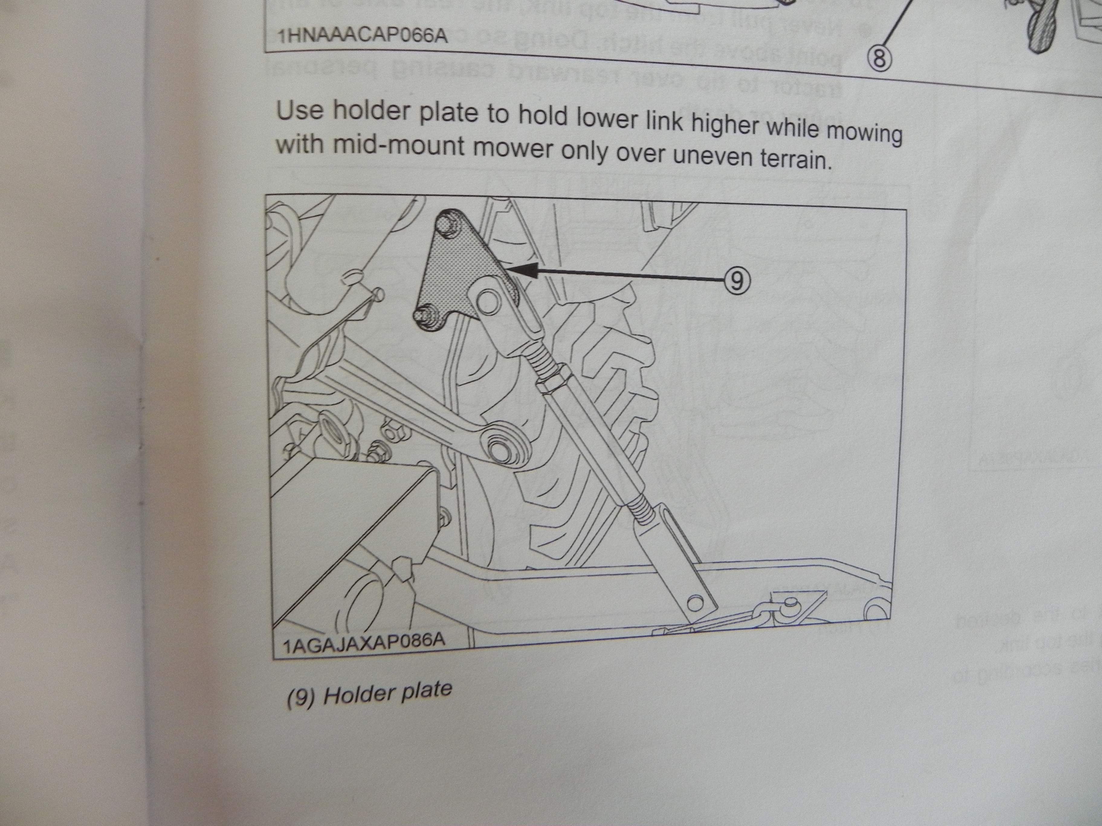

2. I know I can lock the MMM up while using the box blade. Is there a way to lock the box blade up while using the MMM?

4. On these BX's your MMM raise/lower is intimately tied to your rear 3pt hitch raise and lower. Nothing I know of you can do about that. As you say you can no doubt fasten the MMM in up most position but there is no such thing for the 3pt.

Yes, you can restrict the lift arms from lowering. You un-pin the linkage from the lift arms and pin it to the "holding plates" just above. (Plates have a hole that the pin goes thru.)

Nope. That will not work when using the MMM because the MMM lifting and lowering depends on the two lift arms going up and down. The MMM lift linkage rides on top of the two lift arms.
JWR is correct. I thought for sure he was wrong. I just went out and verified on my BX24; when the three point lift arms are held up, the mower deck will not lower. I put a drawbar on my lift arms, then use concrete block and a jack stand to keep then arms in the uppermost position. The mower deck would not lower.

Yeah BUT,... you cannot restrict the lift arms of the 3pt hitch from lowering. The BX machines use the two lift arms as prime movers to raise the MMM deck. So I don't see how you fasten up the box blade without encumbering the lift arms & that would preclude raising and lowering your MMM.
This is not correct. The MMM lifts independent of the rear 3pt LOWER links. I have my 3pt locked out with the rear Bagger, and raise and lower the MMM all day long. The key is the UPPER lift arms for the 3pt , which exert the force to lift the lower links, need to move free. Just clarifying that the lower links if locked out with the adjustable lift arms pinned to the stationary plates, can hold the lower lift arms in the same position while the MMM lifts independently.
Always willing to learn more and correct my assumptions.
Doug in SW IA
OH MY !!! Confusion ! I apologize!
I was speaking earlier (in posts #2 and #7) and I WAS WRONG !!! I was speaking from memory regarding other Kubotas I have (B2150s.) They in fact have orange sheet metal pads resting on top of the two lower lift arms near their pivot points back under the tractor. Those orange pads are connected to annodized-looking rods of threaded adjustable length to the MMM raising mechanism just above the deck. On those tractors you certainly could not mechanically hold up the lift arms and then get the deck to raise and lower. Can't happen.
HOWEVER the BX machines (my BX2200 for sure, which I just went out and crawled under and looked) are made differently. My BX2200 (and the BX1860 is surely the same) have a lever attached to the right side of the pivoting base shaft of the two cast iron hydraulically controlled arms. Those short arms are normally linked by rods (one of which is adjustable) downward to the 3pt lower lift arms. That grey twin lever attached to the base shaft of the short hydraulic lifting arms under/behind the seat has a rod going from the lever to the MMM deck raise/lower stuff just over top of the deck. The grey rod is threaded with some lock nuts on it. On my BX you definitely can hold up the two lower lift arms (mechanically disconnected from the linkage that would normally lift them.) That WILL WORK in spite of what I said previously. It is pretty easy to know on my own BX because I have a heavy bagger mounted on the back that uses the two lower lift arms in a fixed position while still raising or lowering the MMM. The hydraulically actuated short arms are loose at their ends and not connected to the lower lift arms in this configuration. Meanwhile my MMM deck does raise up and down independent of the lower lift arms. Obviously it has to while using the bagger.
Note: Dougtrr2 's test was misleading because he still had his short hydraulically actuated arms linked to the lower lift arms. Disconnect those lower lift arms from the hydraulically operated short levers above them and support the lower arms as you did before. Then you will be able to lift and lower the MMM deck.
Robertm in post #14 is exactly correct.

And so back to the original question. You could lock the box blade up and still use the mower deck. BUT, you would somehow have to hold the box blade at the perfect height while you move the links from the lifting arms to the eyelets.
