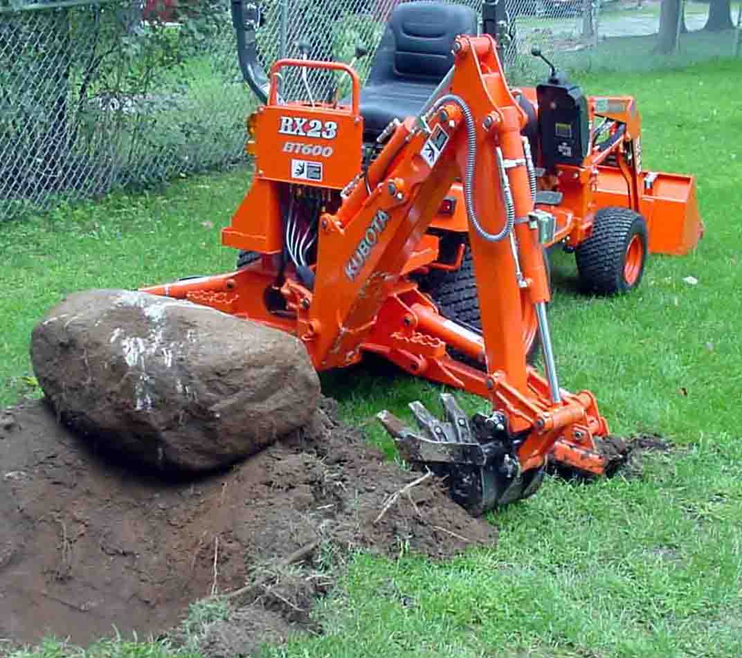

Got a new BX23 on Thursday and have been playing, I mean working with it for a couple of days. This is my first tractor, and it is amazing, it does even more than I expected. Here's a picture of a CT pebble it pulled out yesterday.

The tractor looks great and CLEAN. Welcome may you have never ending fun with your orange beast. My question to you is that rock was very happy where it was, why would you want to disturb it?

That rock was in place to sharpen my mower blades /forums/images/graemlins/mad.gif. I dug the hole deeper and put it back so it could again sleep peacefully, but no longer do damage. The whole process was quite satisfying! I really was pleasantly suprised that I got it out, the BX23 is really impressive. A lot easier than digging them out with a shovel & crowbar.

Congratulations on your new machine. When it has a few battle scars, then you will really know its full potential.
In my opinion and experience replanting this rock is a mistake. A rock like that will come back up from below to haunt you in a couple of years. It is the frost that we get in New England that causes this. I have had rocks like that which were down more than 2 feet come to the surface under my paved driveway this past year. Last year was a record year for cold in CT and the frost pushed these rocks upward till they caused a bulge in the pavement. Whenever I dig out a rock, I alway put it somewhere it won't be a problem in the future and I never bury them. If it is on the surface of the ground, I can keep an eye on it not to ever cause me another days worry.

Maybe Ken meant to say that it will no longer do damage this year. Next summer, he gets to dig it up again with the backhoe. Maybe he doesn't see digging and re-digging as work, but rather something fun to do instead of replacing that leaky faucet, repainting the house, etc. "Sorry honey, have to go remove a couple of rocks that are going to break the mower blades before I can take care of that..." /forums/images/graemlins/grin.gif
