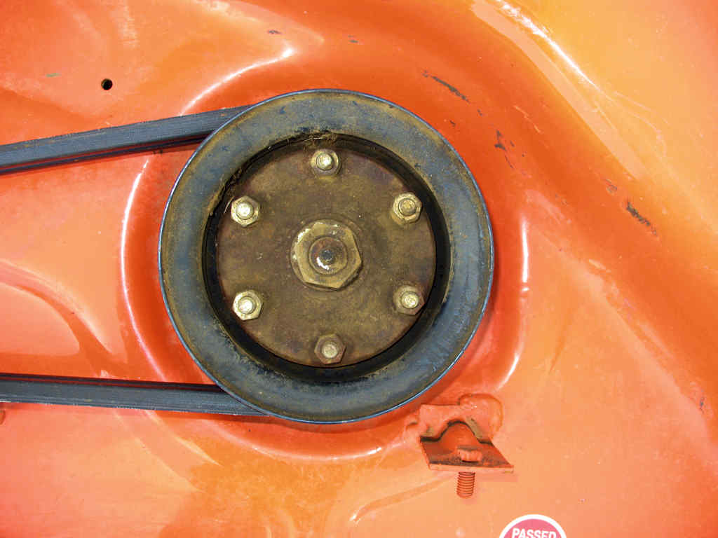

Have a friend with a BX25 and he has had problems with the pulley bolts loosing up and getting wallered out 2 seperate times. The older deck that I have on my BX2230 has more bolts and a circular flange and has not loosened up any like the 4 bollt newer crossed flange spindles. Think Kubota needs to go back to the old style spindle as there is some type of harmonics building up on the newer cross type spindle assemblies.

Yeah they have made a few changes to these decks over the years. Here is a pic of my 2003 60" deck pulley. The deck probably has 300 hours on it and I have never had anything fail or come loose in all that time. (I have two decks [PO had them, one for rough fields, one for his "lawn"] and swap them out so neither deck gets a whole lot of time on them)

Coolerman: your pullys appear to ahve 6 bolts and mine only have four...although they appear to be larger then yours. Not sure if one has an advantage over the other in this application......
We have an 03 and 08 and I prefer the 03 as it just seems more sturdy and I prefer the metal belt covers and chute on the older ones.
