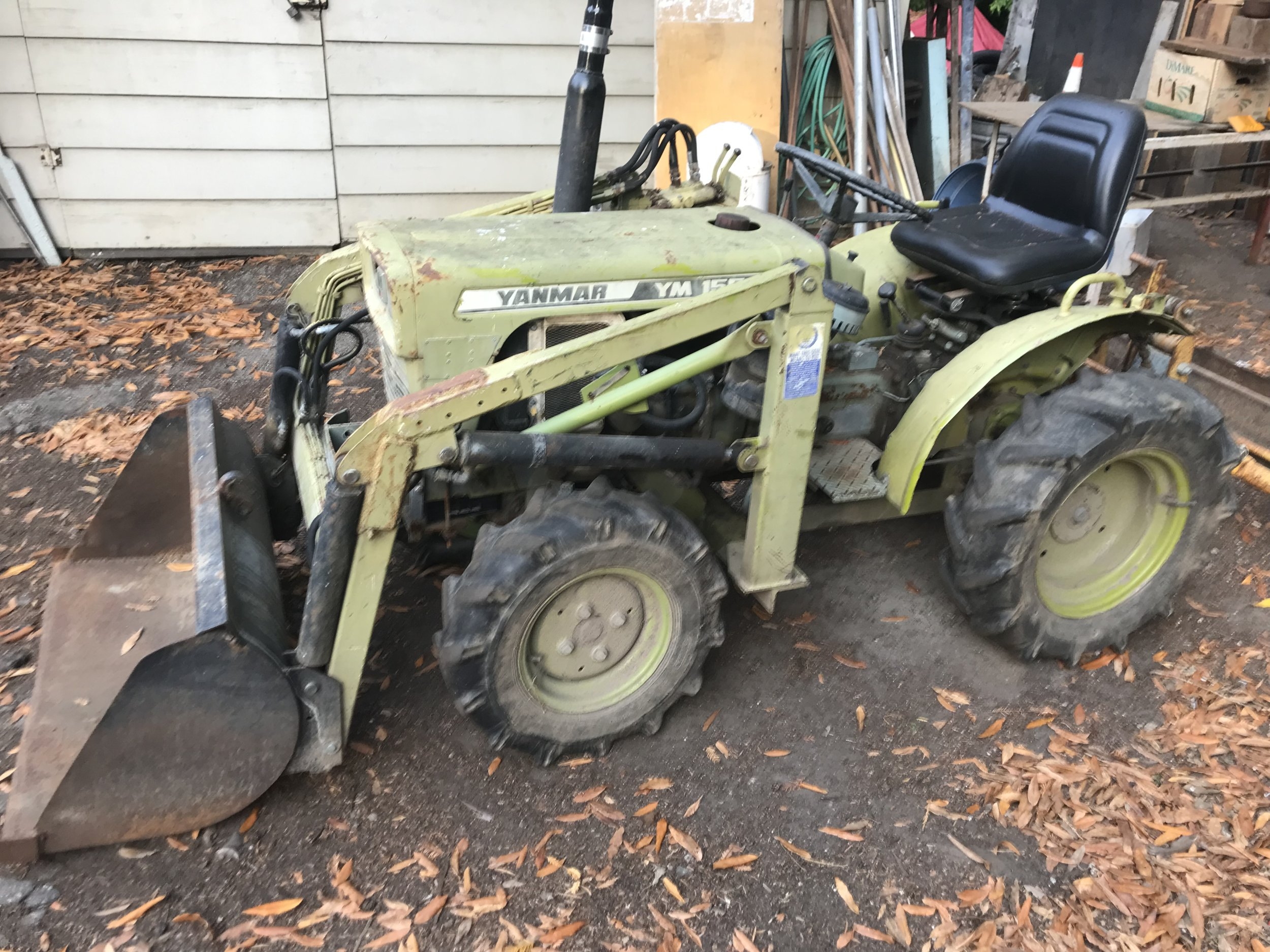

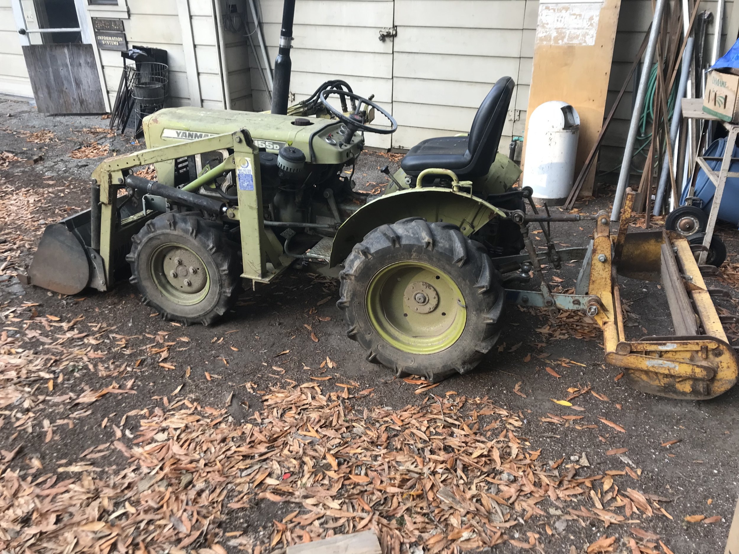

Thanks for the replies, truly appreciate the help! I do not weld so I know that will limit my options. I can use what is there but if possible I wanted upgrade the bucket within a limited budget. I’ve reached out to Fredricks Equip and they’re seeing if they have something that may work for me. I’ll you know if that pans out. Very happy with my tractor, it will serve me well. This community is an amazing resource and huge blessing for people like me, again thank you!

I don't see anything wrong with that bucket. Those of us who were around 40 years ago, all agree we were better looking then compared to now. Same thing for our Yanmars. :). I wouldn't change it. A bucket with greater capacity will just stress the front axle more. In fact I see repair welds on the loader's arm, somebody overloaded it in the past.
But I do see an issue: - your front tires look larger than the original spec. If this is the case, it would stress everything in the driveline. Here's a post discussing tire size.
Anyhow - You'll love your new Yanmar!
   / New bucket options Yanmar 155d
#9
Thanks for pointing that out, I would’ve not known that. Seller gave me another set of wheels and I did notice the extra front wheels were smaller then ones on tractor. I’ll swap them out for correct size.
