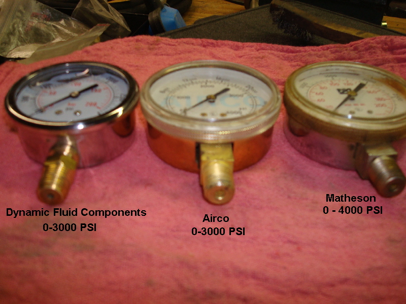

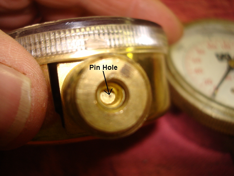

Does the gauge have a restrictor for safety? Bourdon tubes can fatigue and in general a gauge is fragile compared to the other fittings. You need very little flow. I screwed a bolt into the fitting holding mine and let it find its way thru the threads.
larry
Hi Larry,
The gauge I used being rated for 3000 PSI was manufactured with what looks like a pin hole through the center of the fitting. Are you saying you had a gauge rated for high pressure with a "standard" NPT ID? Sounds to me like it was not manufactured correctly or was not truly an approved high pressure gauge (Chinese knock off?). I've never seen a HP gauge where the input was not just a small pin hole. Where did you get it? How high a pressure will it read? You got me curious, so I went and looked at my stock of gauges. Of the three I looked at, all had small pin holes for the input. Attached are some pics. From left to right "Fluid Dynamics Components" (the one I used) an "Airco", and a "Matheson".
Larry
