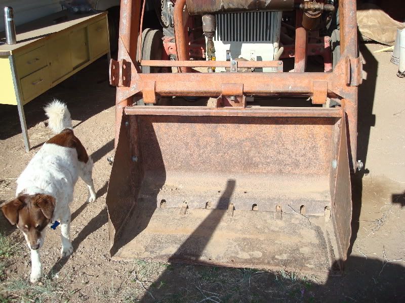

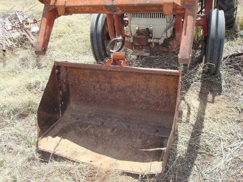

One important item remained to be upgraded on the FEL to become fully modern and easier to operate and that is the bucket and the means to dump it. As you see it is a trip bucket that is only about 40" wide.

Hear are a few pics showing the 2.5" double acting cylinders, front, back and side views of the trip bucket, the valve on the left and trip handle on the right:

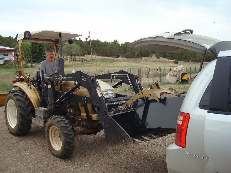

One day while taking a break during a road trip, I was browsing around my favorite equipment auction yard (the same place where I scored my Komatsu dozer). I came across a pair of 60" skid steer buckets. Well next thing you know one of them is in the back of my van :D The guys at the yard used a fork lift to get it in.
When I got home, I fired up the Jinma and used the grapple to extract the new bucket from the back of the van.
Larry

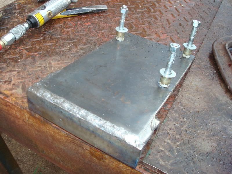

The piece of channel being cut in the first pic is from the original shipping crate of my Jinma. I decided to use 3/8" studs essentially spot welded to the mounting plate for the valve...
Larry
   / New Bucket for an old FEL
After welding studs in place and allowing to cool, the mounting channel bracket was welded onto the valve plate. In the first pic you can see I will be using spacers to lift the valve up off the plate about 3/4". That is being done to allow enough clearance for the rubber boot and for full range of motion of the joy stick. Some of the challenges mounting this valve is it's large, getting it located where it will not in the way, still be within easy reach be able to get on and off the tractor from either side, and route all the hoses to and from it. Also of consideration is not getting in the way of any maintenance item on the tractor, like be able to still fill it with gas, or remove the battery, etc...

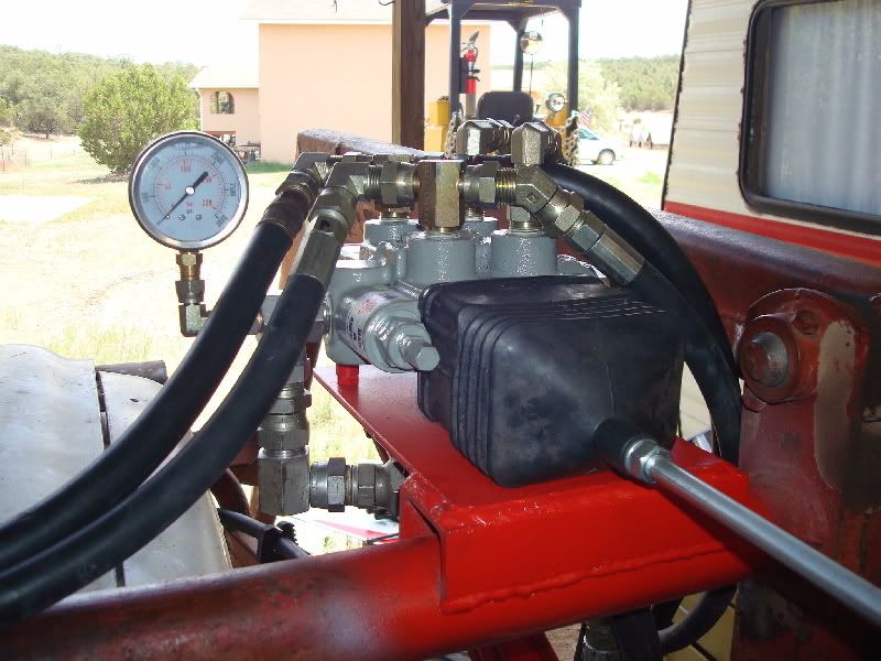

After welding the new valve bracket to the FEL upright support cross tube. I removed ALL the old plumbing... hoses, valve, took apart and cleaned all the fittings, removed the flow divider and control valve for the back hoe, and the back hoe hoses. Man what allot of stuff to remove. After doing all that, relocated and re-plumb everything in a new location. The goal was to re-use as much of the old hose and fittings as possible, and route everything as clean and neat as I could. The supply and return lines are 3/4" hose, working with that stuff is like wrestling one of those 8 foot rattle snakes you've seen at Rob's (3RRL's) rattlesnake ranch.
One thing missing from the old setup was a pressure gauge. So I ordered a liquid filled 0-3000 PSI gauge from surplus center. It came in yesterday afternoon. So I got busy modifying a 3/4" x 90* street elbow to accept the gauge. When drilling and taping the fitting I was surprised how soft the metal is. The drill and tap cut through like butter. I used a copper washer to seal the joint.
In the center picture, to the right of my hydraulic soaked and dirt covered canvas slip-ons is the flow control / flow divider for the back hoe, I have it set somewhere around 6 GPM. The direct drive crank shaft pulley driven hydraulic pump on the tractor puts out ~ 12 GPM. Seems like allot but it's perfect for those two 2.5" ID x 30" stroke lift cylinders for the FEL.
