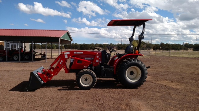

Branson 3515H
I just ordered a 2016 Branson 3515H. I hope I made the right choice.
Did you get the loader with it? Adding weight will help with loader work and you can choose 3pt mounted weight, load the rear tires or both. If you are going to drive on the lawn much 3pt mounted weight has the advantage of being easily removeable. Loaded tires offer hidden weight but it's always there.
I'm not loading my tires as I need to drive across my lawn a fair bit and will use a weight barrel. My old Kubota never saw grass and had loaded tires. The choice is yours and it depends a lot on how you will be using the tractor.
   / New Branson
Thanks for the responses. I will be using it mostly for dirt work with a 500lb gannon on the back. I have a 2 acre hobby farm and a 5 acre parcel up in the forest to develop and maintain. I will be doing some new road building on the forest property. I also expect some type of grapple attachment for the front may be useful in clearing the forest property underbrush. I chose the 3515 over the 3520 for the smaller dimensions to better navigate around and through my barn and stall buildings.
