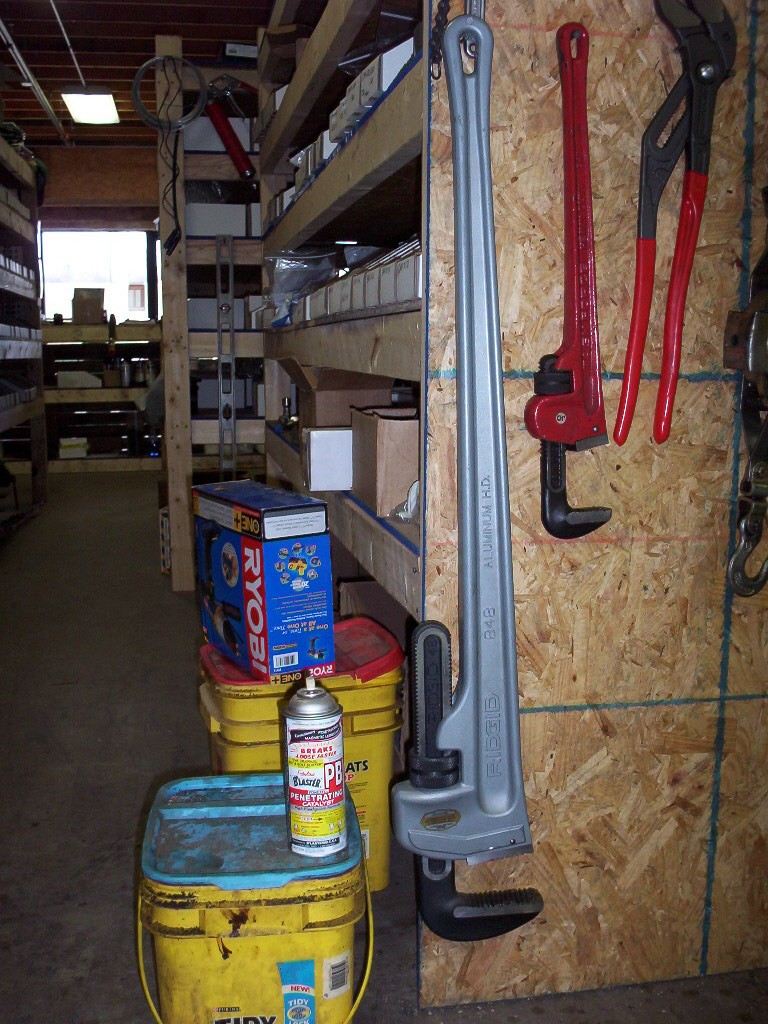

The small red one is 24".

dfkrug, i'm no good at reading decimals off it, but the caliper opening measures 3/16" and it's telling me 0.21 inches. And a T-bar thru the crosstube was what did it, after the concrete dried that I set the dang cylinder into.
Wayne (county?), I coulda' used that monster pipewrench on your wall, my 24-incher barely opened wide enough.
