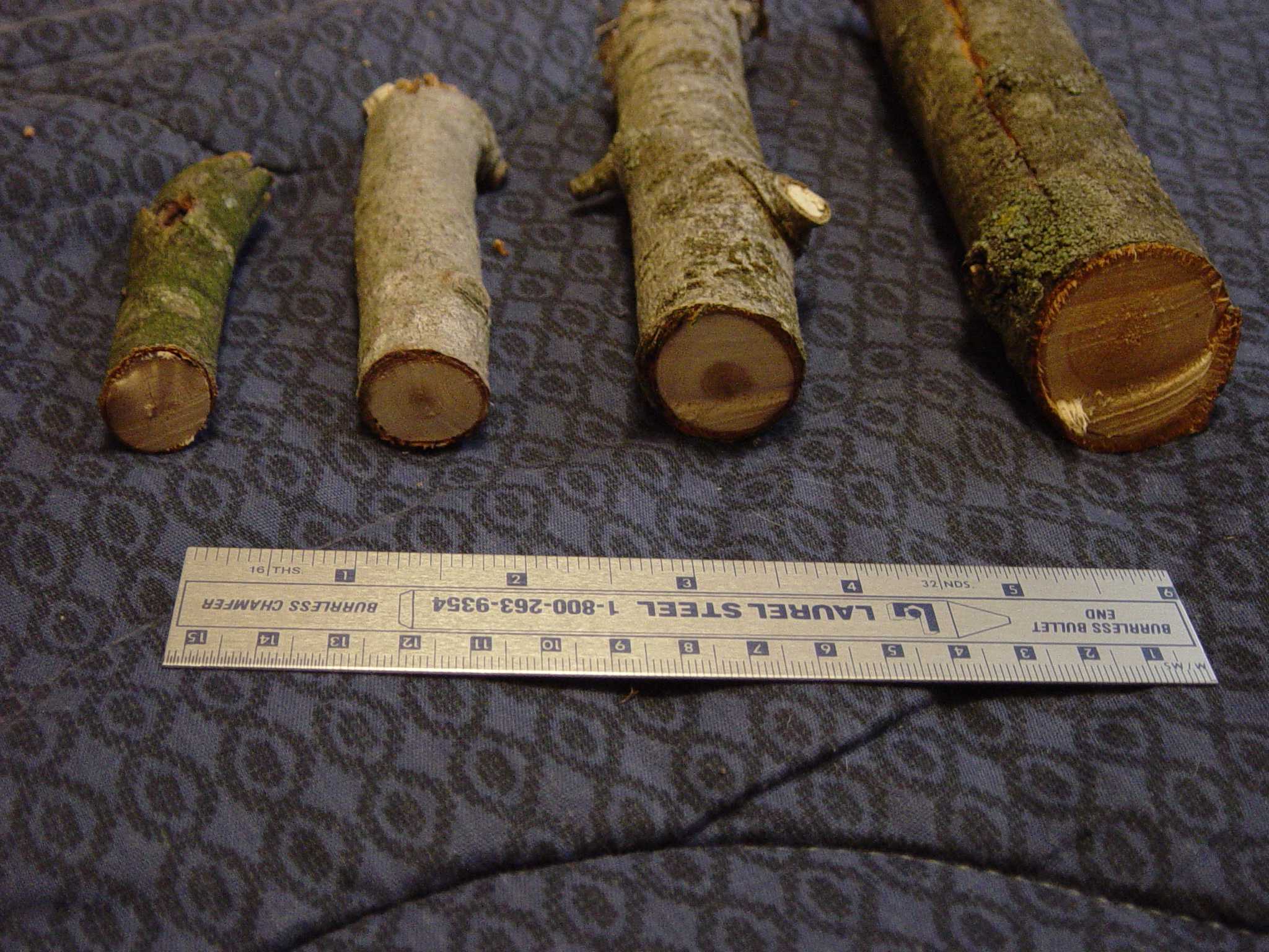

This is a picture I took of the gathered up material, after my twenty minute test, to send the vendor and try and determine what happened.
I had only cut one of the largest and mostly smaller stuff.
I'm guessing that the serrations greatly help cutting heavier stuff and do help keep lighter stuff from escaping. But what good are they if they last only minutes?
With dense foliage, it's actually quite hard to even see what you might be getting into.
I would like to find a solution, because this cutter would be VERY useful. One problem I found cutting along roadsides was the ability to keep it at proper height with varying terrain and roadway. To make matters worse, the aux circuit stops when I operate loader boom or bucket.

Another possibility is that the serrations didn't break off in the heavy brush directly- maybe the teeth deflected enough in heavy brush to interfere with the opposing set of teeth. Each tooth could flex individually or the whole sliding fit could have too much clearance. We can only guess from pictures.
