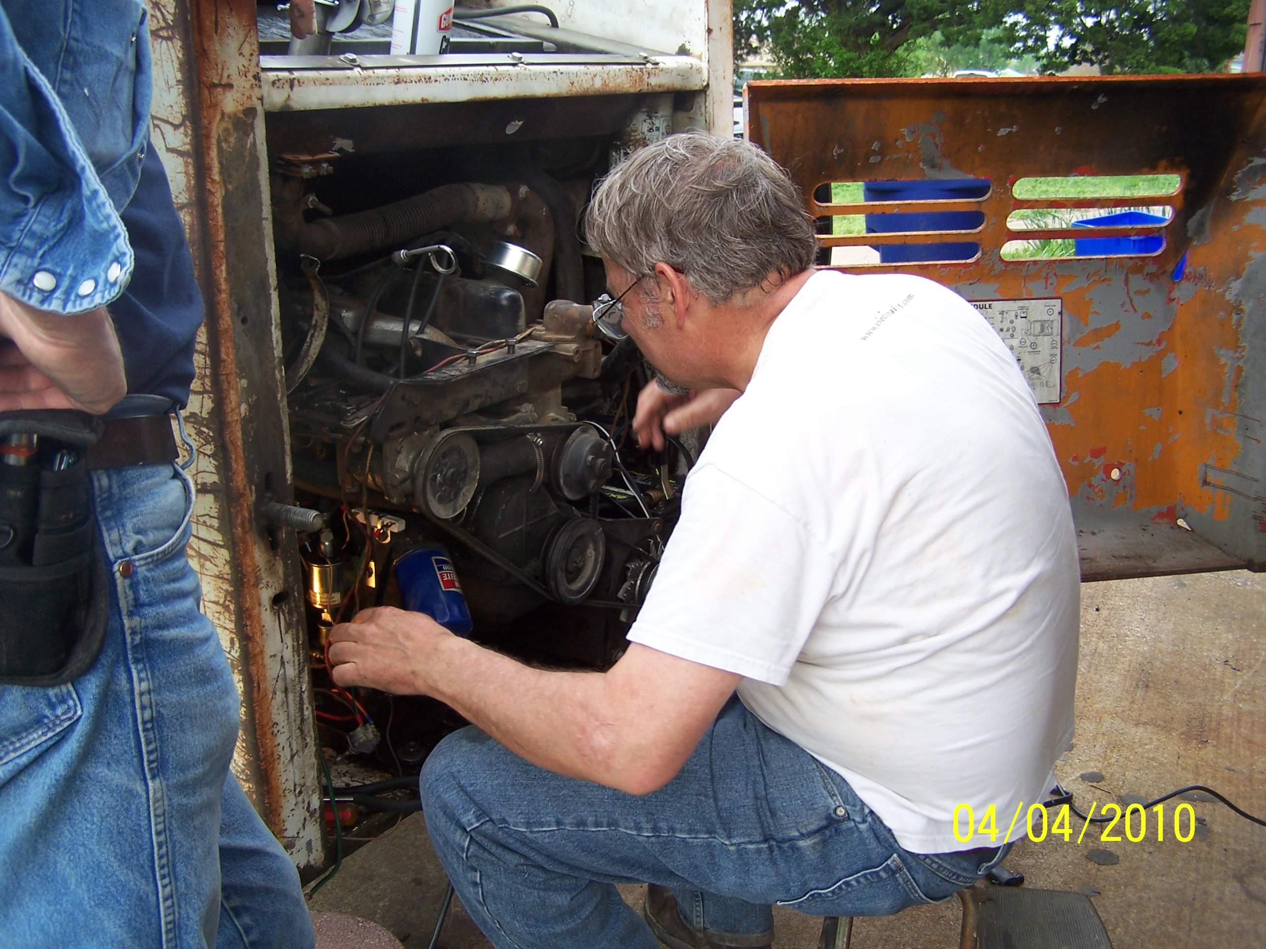

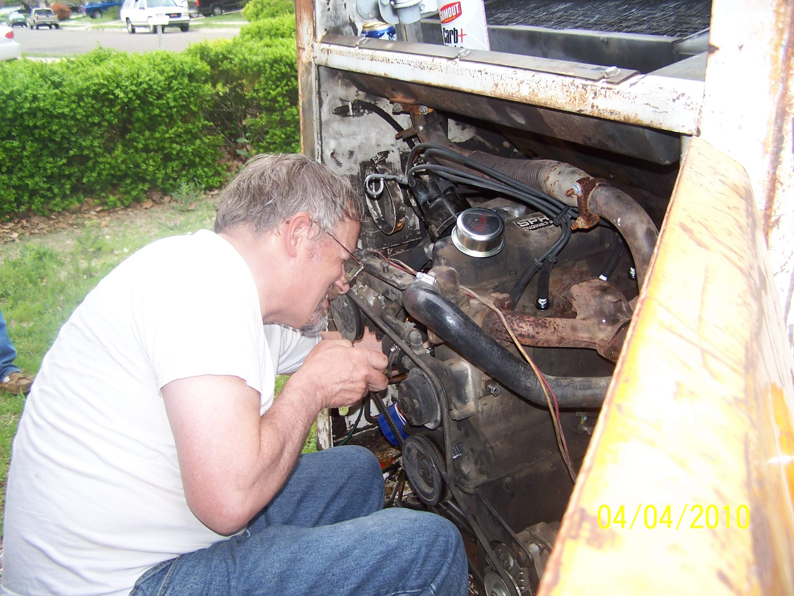

Well this weekend (Easter) has been a great weekend. Side note is that our fence is near complete on our new property and I vowed that I'd get my SS running. Now for the instrument panel creation and other items. A few pictures.
