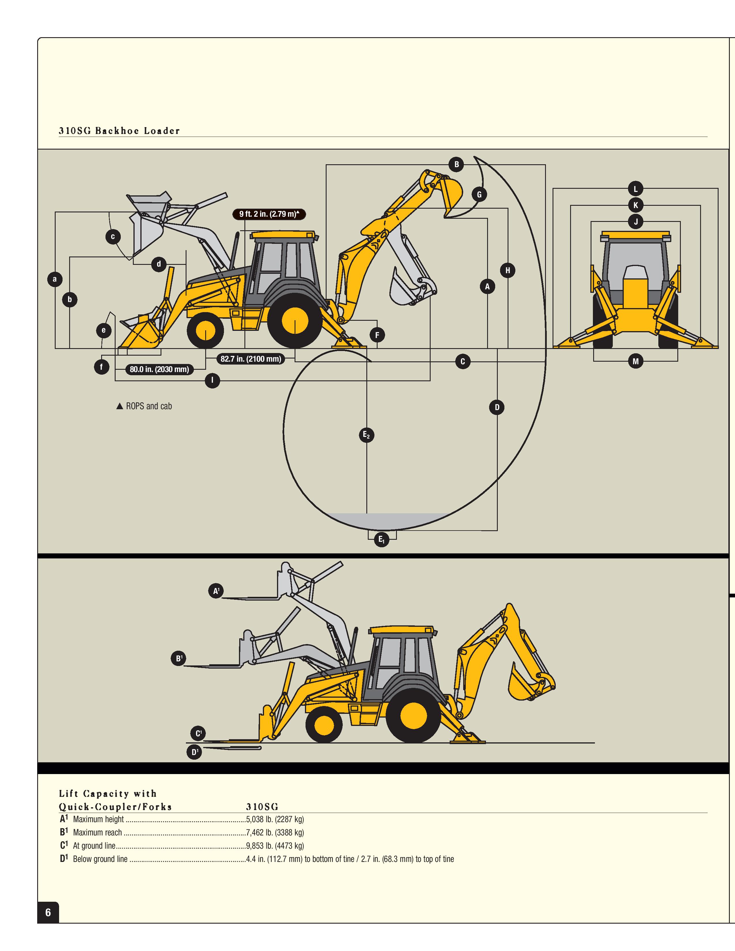

Yes, there should be a 180 degree arm swing. To utilize it can you keep the stabilizers out of the trench?
   / New backhoe owner with ditch questions #18
Looked it up. Only 140 degrees of swing and 6 ft. Digging depth. Makes it kinda hard cause it requires an angle approach which means you'll end up almost undercutting a tire and not able to use the boom for depth.
At right angles both rear tire's will have to sit on the edge of the trench. Trench may collapse.
